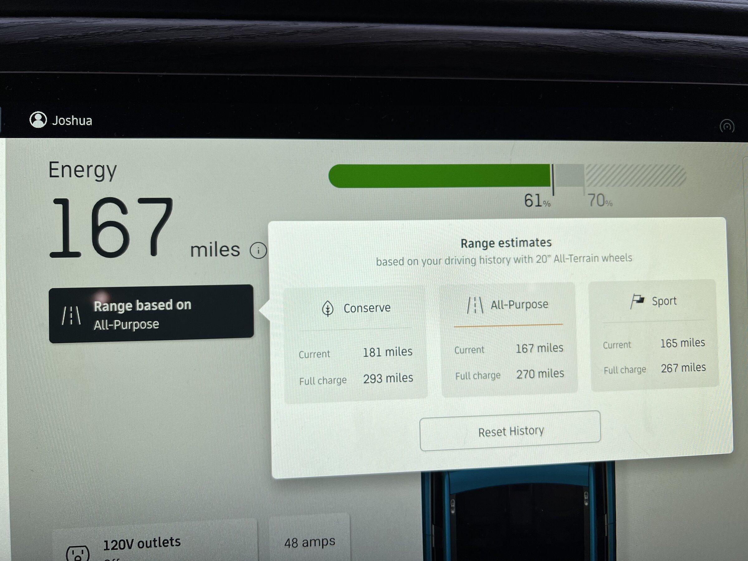

The numbers that the truck reports from that trip don’t seem to add up when I try to extrapolate 100% range. They all check out except when I compare kWH consumed to percentage of pack used. 32 kWH for 29% of pack would give a 110 kWH pack which doesn’t sound right based on other reports.
I’m not trying to be difficult, but any idea why it isn’t adding up to the 125-ish kWH usable rating?

I guess it’s probably a factor of rounding and accuracy of the trip computer. I did comment about the trip computer giving me some strange numbers when I reset right before coming down.
I’ll have to repeat the experiment using both trip computer and resetting one of them at the turn around point and see if it all adds up.

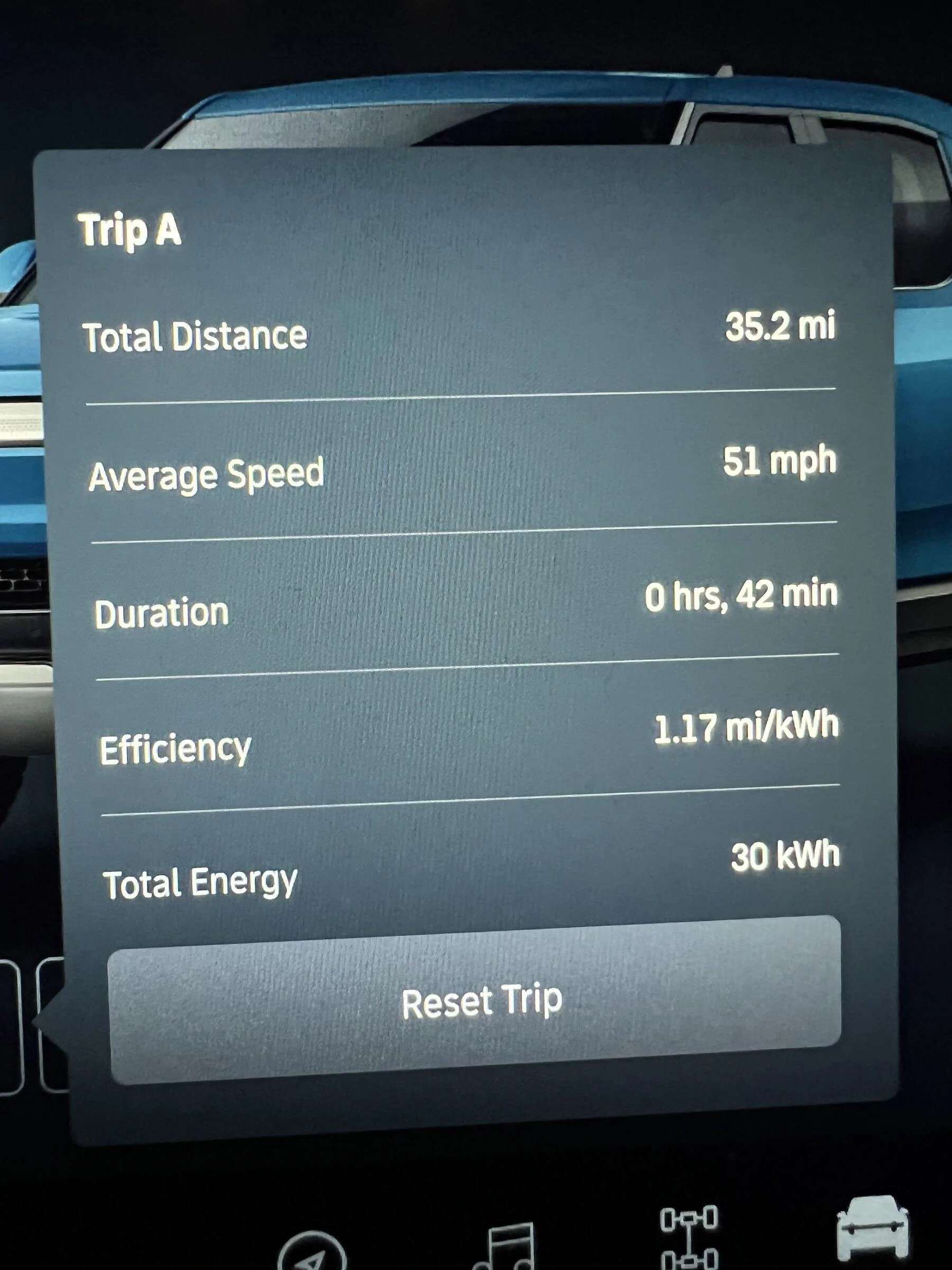

So I was bored after dinner so naturally I wanted to take the R1T for a drive.
So I decided to drive from my home in Sandy, OR (~800 ft above sea level) to Timberline Lodge (~5800 ft above sea level) over a total distance of 35-36 miles. Temperature was low 50s F in Sandy and mid 30s F at Timberline.
I drove with auto climate control on at 69 and heated drivers seat at level 1. 20” AT tires installed.
For the first flatter part of the drive between Sandy.and Rhododendron (and reverse) truck was in conserve in standard ride height
For the steepest part of the climb between Rhododendron and Timberline and back I used all purpose in standard ride height
Leg 1 (to trip) - Started at 66% SOC and arrived at 40% SOC
35.2 miles
1.17 mi/kWh
30 kWh used

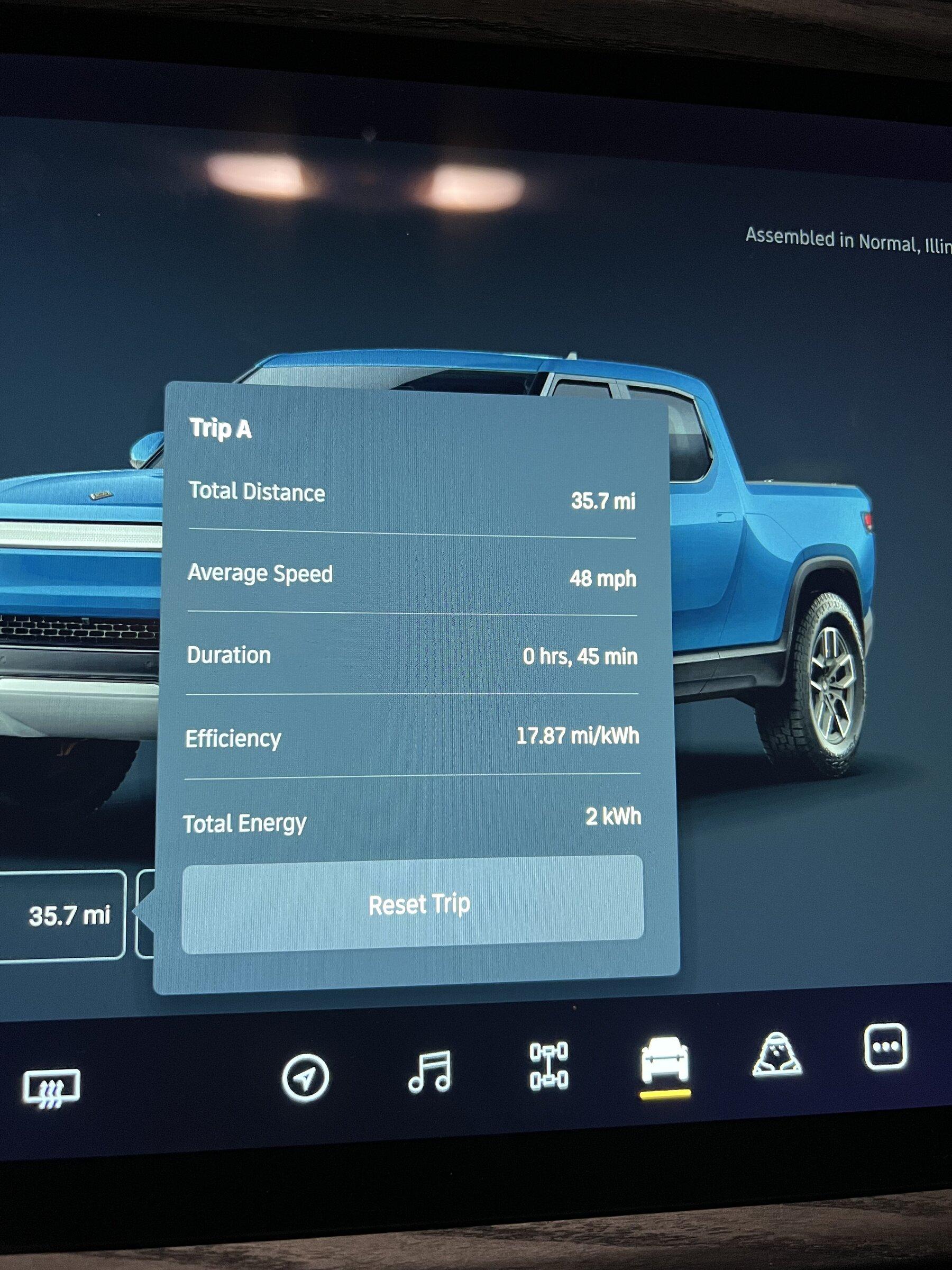

leg 2 (return trip) started at 40% SOC (got up to 42% SOC) and arrived home at 37% SOC
35.7 miles
17.87 mi/kWh
2 kWh used
Overall 2.23 mi/kWh
A couple of observations in general I noticed on the trip:
The trip meter doesn’t give correct information when you have gained energy via regen. I watched the trip meter go from 2kWh used to 1kWh used to 0kWh used then back up to 1kWh and 2kWh used. The trip meter didn’t appear to understand that wasn’t consumed but gained energy.
