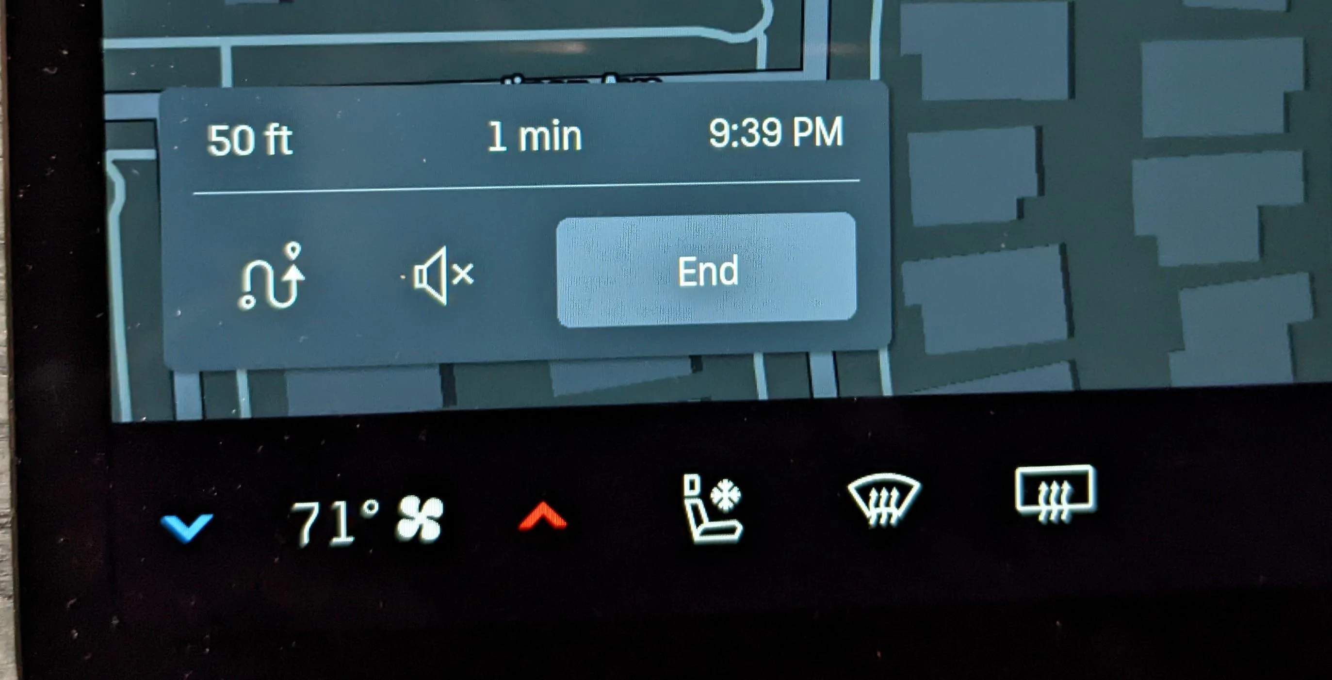

You can mute the turn by turn to just get a chime. Put in directions to somewhere, bottom left corner you'll have the map like then the middle will be a speaker icon with a line through it, that's the mute / chime. Press that to get Alexa talking again.

Thanks I’ll try again in the morning - I’ve done the reset and am pretty sure it’s not the volume on mute but will look again to make sure.

Tried again to get voice navigation to work after the soft reset and turning the mute on/off, selecting Chime and Voice back and forth but can never get the Voice to work. Saw a similar thread on a different Rivian forum also unresolved. I'll reach out to Customer Service and report back if anything helped.
