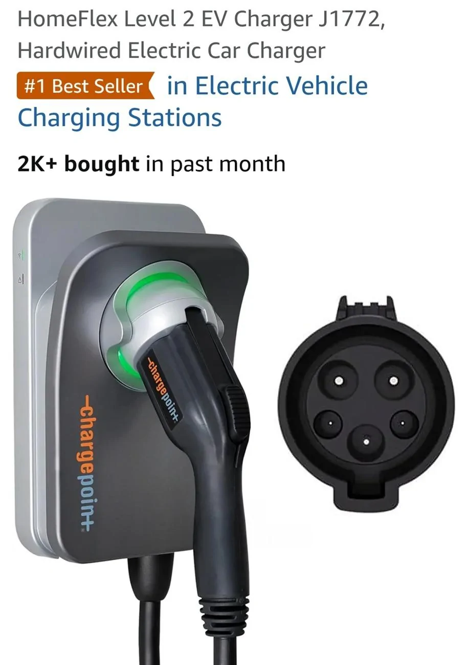

I am happy with my hardwired ChargePoint flex. Not an issue with it. Have a 2025 R1T large.
Same here - but in reality any good "charger" will work. Wired preferable. Remember that it is not really a charger - just a smart relay.
One thing against ChargePoint - they do not have thermosensor that will cut the power if it overheats the outlet (if not wired). If you choose nonwired installation, look for a "charger" that has this. I have one outlet melted as a certified electrician used a cheap one.

I have ChargePoint HomeFlex, zero issues. Hard wired
Rivian R1T R1S New to EVs and unsure which brand of home L2 charger to go with Screenshot_20250214_180327_Amazon Shoppin
