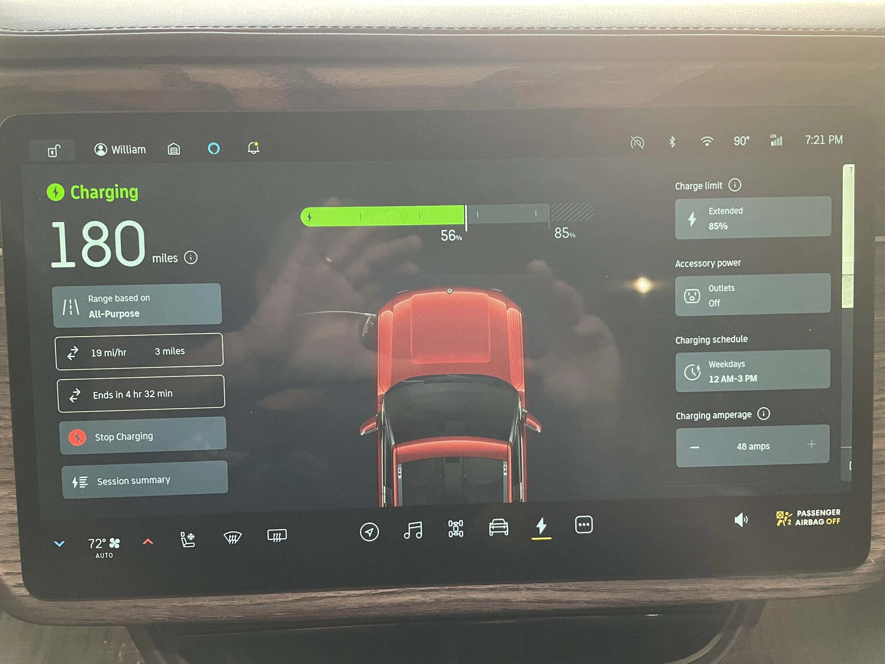

I plugged my truck in this evening during my on peak hours and it started charging. The schedule in the truck is correct, but it ignored it. Had to manually stop the charging. I get hit with demand charges during peak hours!
Mine did the same last Friday afternoon when it shouldn't have. But hasn't this week now.
