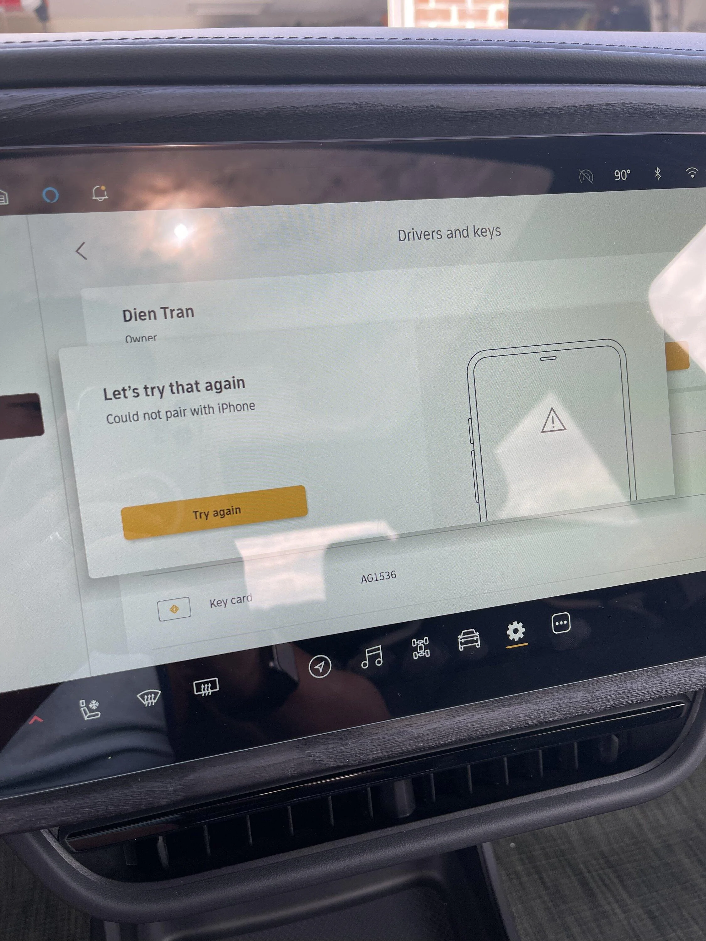

Just picked up my R1T last week. Chris my service Rep that delivered my Rivian tried to set up my “phone as key” could not get the set up done and said that it was a known issue and Rivian was working on a fix. I left it at that and picked up my truck. Submitted a service ticket and Rivian service rep pushed a new update to my Truck 2022.39.03. Still not working.
Any one else having this issue?
I have a iPhone 12 Pro Max on the latest firmware (16.1) as suggest by the rep after our initial call. It just gets stuck in an endless loop. Deleting the key and trying again gives the same results. Sent invite to my wife phone and results were the same. Otherwise still enjoying the truck!

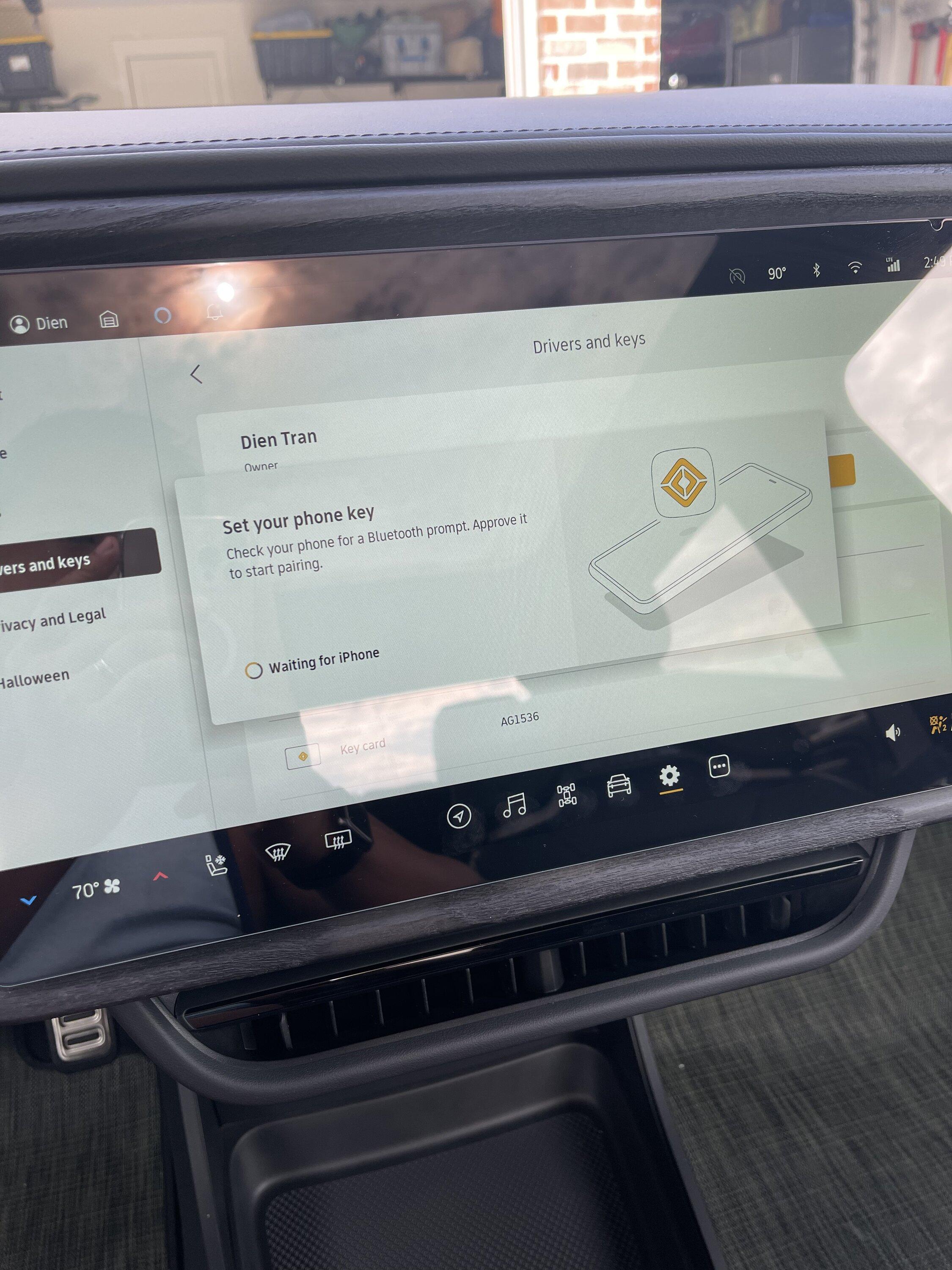

Seconded. Picked up today, would not pair. Looks like the same problem as you. Pixel 6a. Service center said they've seen a couple of these now. Mobile service is coming out next week to take a closer look after we spent about an hour at the SC trying everything including diagnostics.

Picked new today, would not connect. iPhone 12 Pro Max. My pickup coordinator said she had seen others have the same problems. After I got home she asked me to reboot the truck (left steering wheel button and hazards) and try again. Still no luck. Rebooted phone, did not work. I guess I will just wait until they come up with a fix, and carry the fob around like I have for every other vehicle I've had. Bluetooth audio streaming still works, I was worried about that when I read about some of these phone as a key issues.

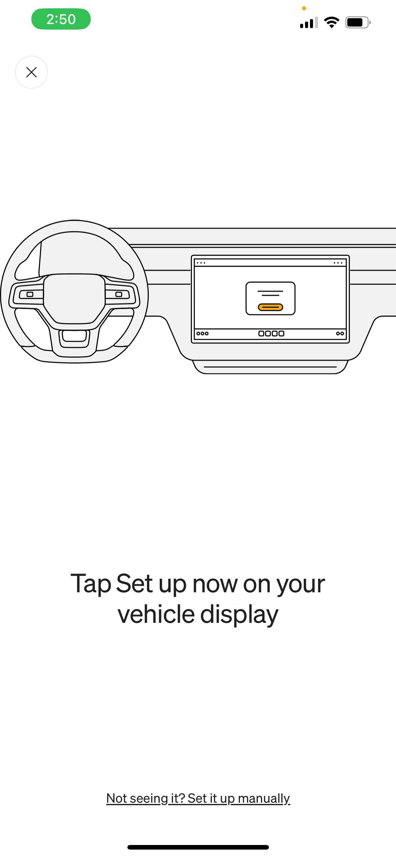

Having the same issue. Have tired deleti g key, logging out , restarting phone. I even restarted the car. Same issue.

When I picked up my new R1T last week the delivery person was unable to set up PAAK with my iPhone 12 Max. Oddly, he also couldn't get it to confirm the fob as a key—even though each button on the fob does seem to work. A technician at the service center also tried unsuccessfully (we spent at least 30 mins reseting the vehicle software, signing out of the app, deleting and reinstalling the app, deleting all Bluetooth connected devices, setting correct Rivian permissions) and they advised me to submit a ticket and drive home. I subsequently spent an hour on the phone with a service rep going through all the same steps as had been tried before, but it always reports "unable to pair". I now have an appointment at the service center, but I am not confident that this will be resolved and it's a 2+ hour drive each way.
For the record my phone pairs immediately for use via the vehicle's audio, accessing my phone contacts, etc. The camp speaker pairs with the phone, and the vehicle connects to the home WiFi. Disconnecting all of that pairing does not resolve the PAAK problem.
This seems so similar to previous users in this and other threads, except for the failed fob pairing. Any thoughts? Advice?
I really love driving this truck, but it would be nice to be able to use the phone to control the vehicle remotely, and to add my wife's phone as a key.
