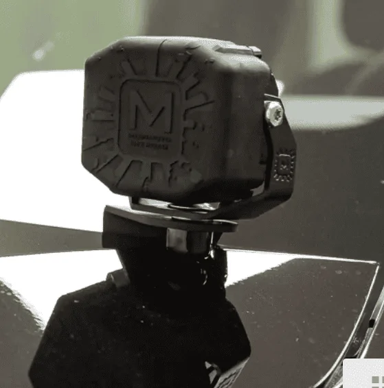

These guys built and wired an R1S snd R1T for SEMA a few months ago. Parts of the build are starting to come to production.
https://www.weistec.com/rivian.html
I had seen this truck and video but the link was helpful as I did not know they already had the A piller mounts ready. unfortunately their design has it sitting much higher than the 1EV with that cut out logo under it. also I would prefer Black but nice to have another option.

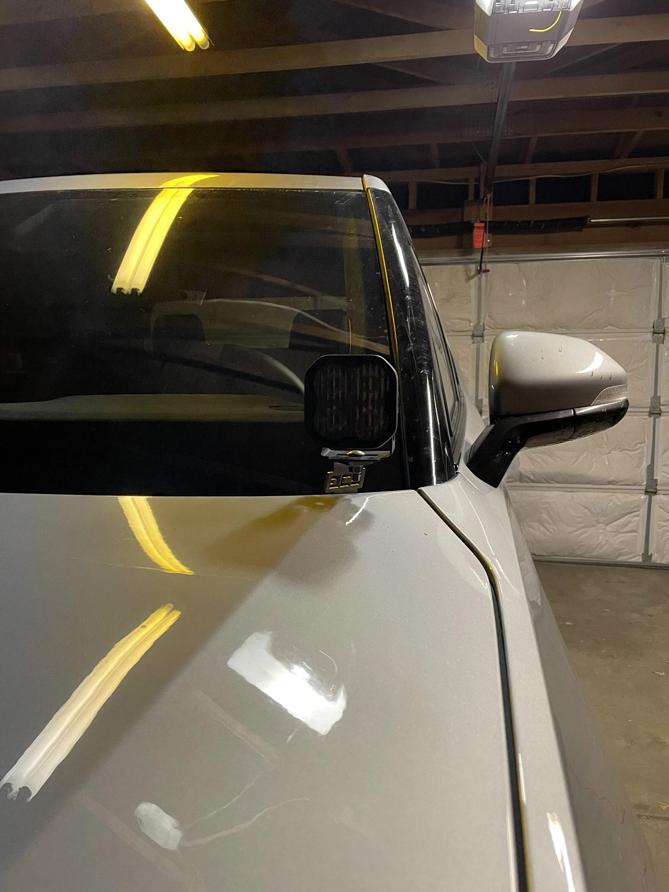

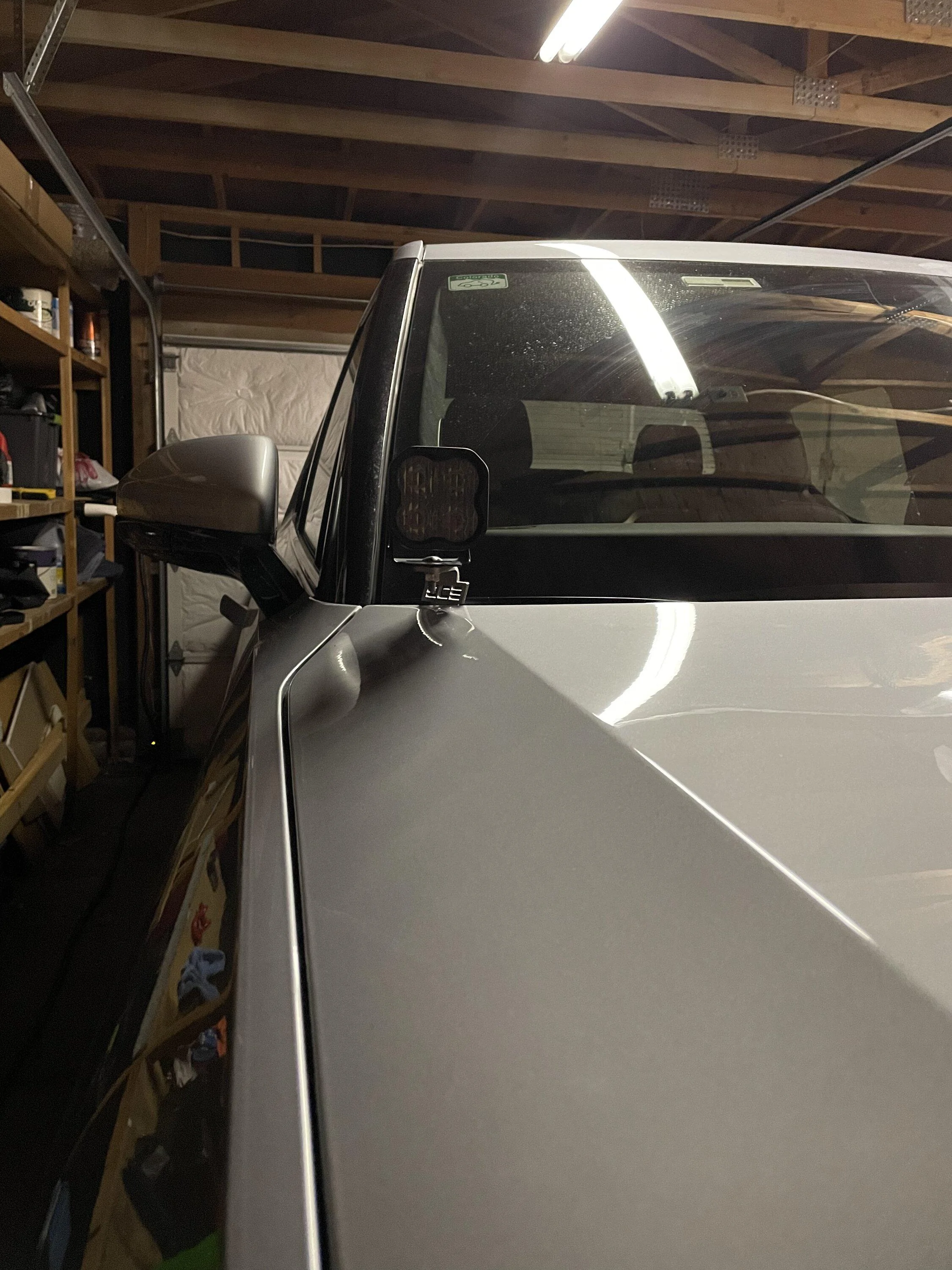

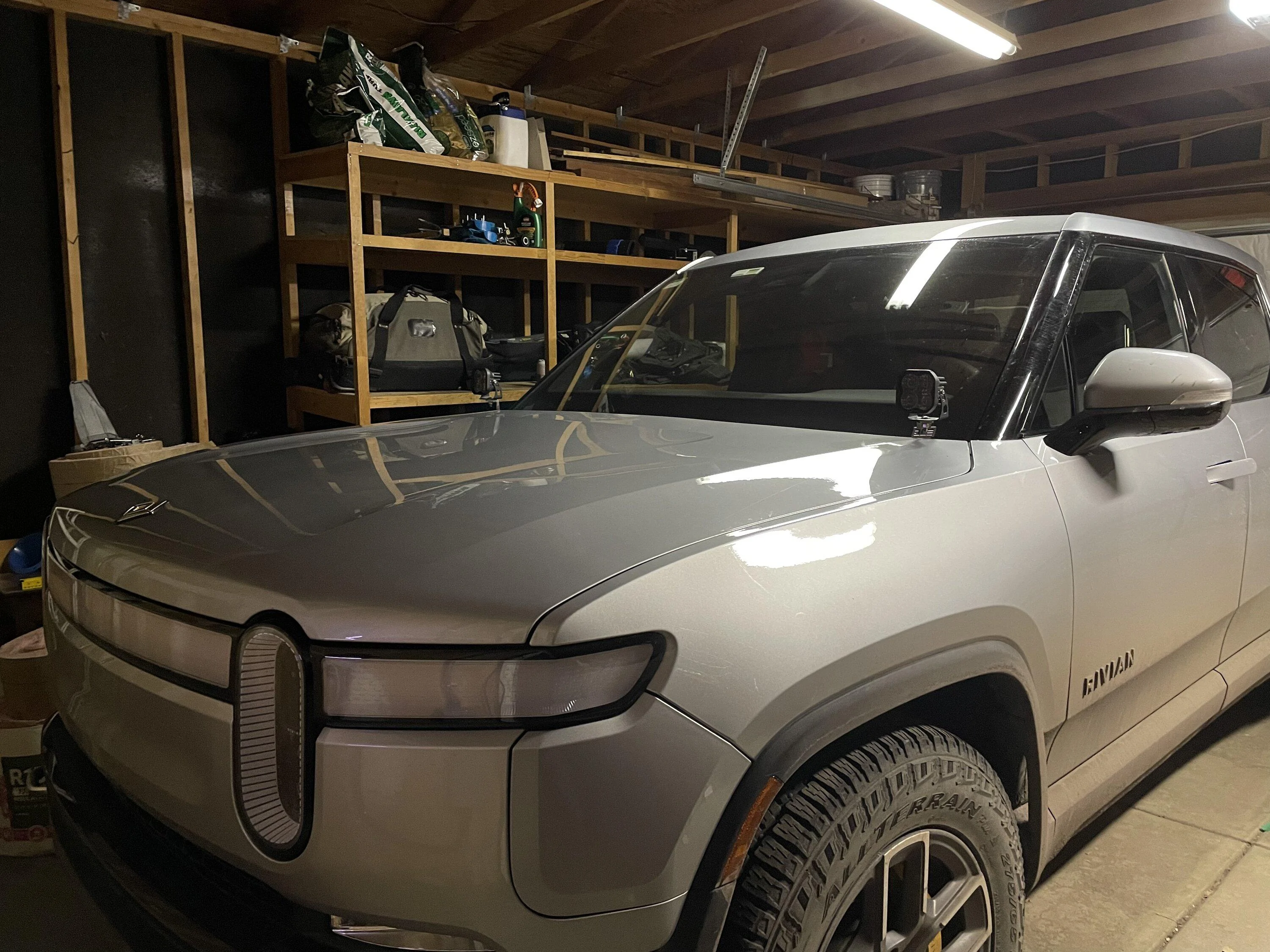

I ordered the DCE pod light mount kit and finally installed them this evening. Pretty simple to get the brackets on. Now have my Diode Dynamics SS3 Pro’s on there. Just need to find a good harness with remote… or determine how to wire them into the cabin.
Rivian R1T R1S Pod lighting, aux, off-road, flood, lightbar -- anyone install these? A59C98EE-E049-4BA1-9BC4-E7180CE6D275
Rivian R1T R1S Pod lighting, aux, off-road, flood, lightbar -- anyone install these? 912701DE-A4CD-4335-90C5-C897EEDF6ED5
Rivian R1T R1S Pod lighting, aux, off-road, flood, lightbar -- anyone install these? 22D9CA37-4CDA-4C46-90D1-6159F4EE5622

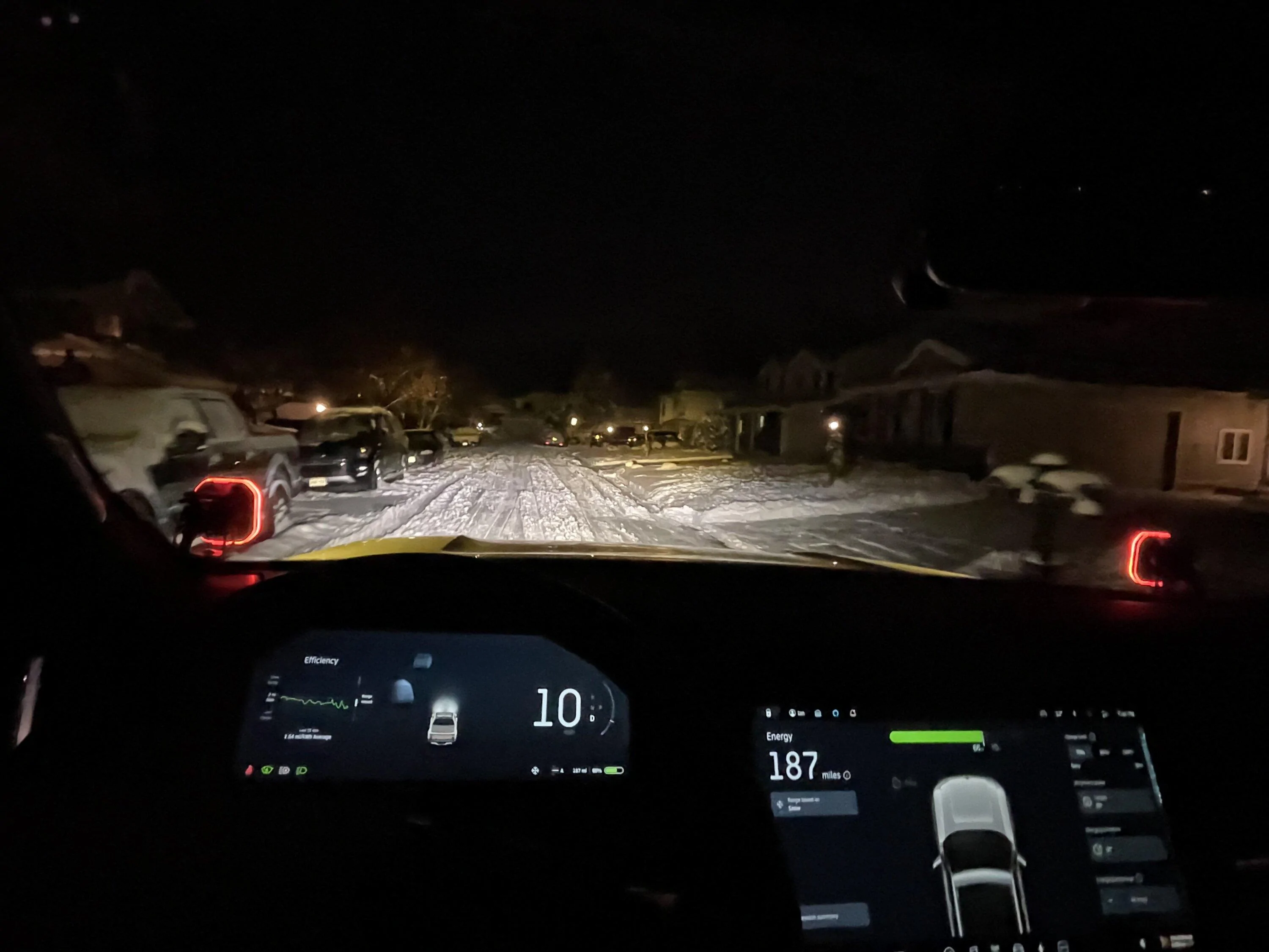

Also I have orange covers for wintery things.

Nah, I'm thinking about just using my old wiring harness with remote fob I used to use on my Grand Cherokee. It worked well for years, so why improve something that worked well already. I'm just going to wire them straight to one of the 12V batteries in the frunk tub as Weistec Engineering folks did it that way, and I imagine 1EV will do something similar.
That said, running those low on the hooks might be okay for fog light duty, but wouldn't be as useful for spot/flood duty afar as they'd be quite low. Thoughts?

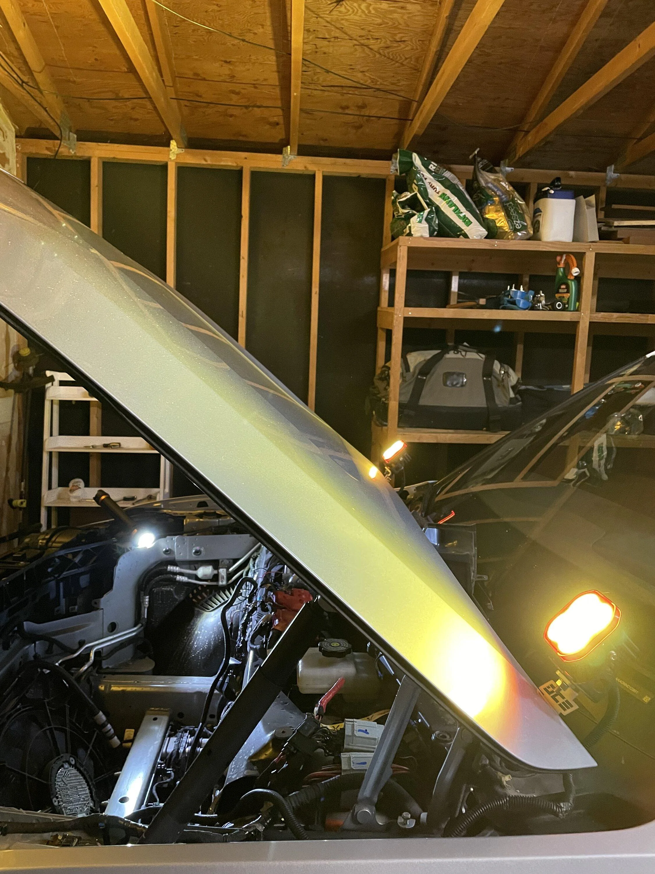

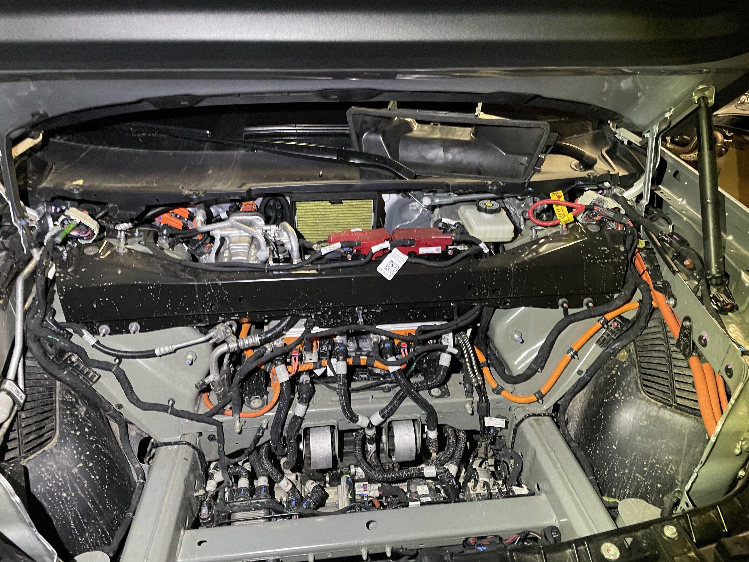

Finished the wiring job in a few hours. Essentially removed the clipped plastic sections around the frunk tub, the tub itself, and got access to the 12v batteries.
I wired my remote switch directly to the secondary (passenger side) battery, and tucked the 4-channel control box under the frunk weatherstripping so it sits nicely in the frunk for now. Put everything back together and voilĂ .
Crazy the amount of engineering that goes on under the frunk!
Rivian R1T R1S Pod lighting, aux, off-road, flood, lightbar -- anyone install these? B11994B5-D7BC-4446-A63A-B051A5AB543F
Rivian R1T R1S Pod lighting, aux, off-road, flood, lightbar -- anyone install these? 09CE64B4-474A-4BF9-A798-8F0D3274AF59
Rivian R1T R1S Pod lighting, aux, off-road, flood, lightbar -- anyone install these? F594EFF3-10D2-48BD-9A29-2DE046FFB85C

Any closeups of wiring to battery? easy access to ground spot.

Hmm... I didn't take many photos. In retrospect I suppose I should have for posterity and these moments. It was pretty simple though. There are both positive and negative terminals, so I just wired directly to those on the secondary battery.
