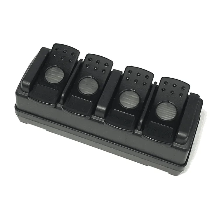

@WattTruckMatt Thank you for sharing the Trigger. This is the control solution i was looking for. definitely going to order this today. although it will probably tempt me to fill all 4 switchse with more lights or maybe a train horn (even get crazy and hook it up to the onboard air? LOL)

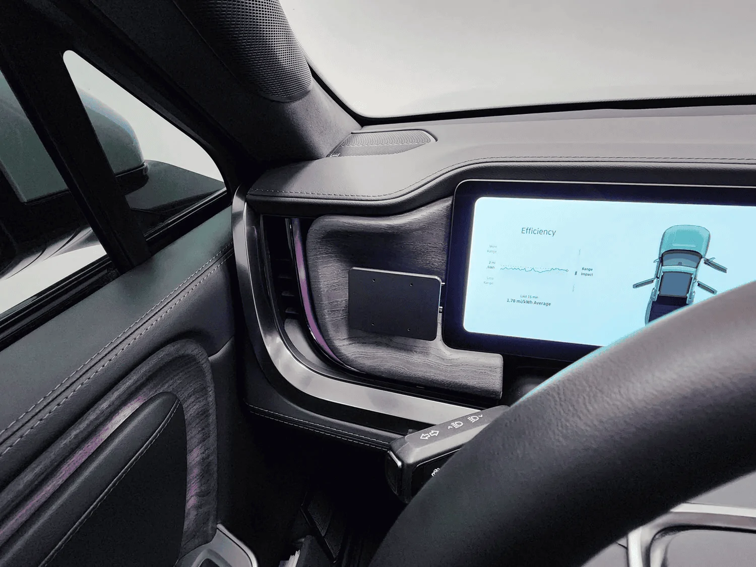

anyway where are you thinking for mounting the switches? im torn between the simple visor clip or maybe on the left of the steering wheel. I would love it out of sight but also learned from my Jeep that Aux light need to be easy to reach IMO.
The mount from Proclips could work. I bought this to use on the right side of the center screen with a magnet mount for my wife. It also works on the left side of the steering wheel.

Would have to take some measurements to make sure the toggle box fits.
The mount comes with a strip of double-sided tape but it's easily removable and stays in place just fine without it. Could throw the switches on the dash when needed. All in all, not the most esthetic solution but it's something.
https://www.proclipusa.com/products/855822-rivian-angled-dash-mount
Agreed. Nice find!
Let me/us know how you like it because it looks like I can easily carry this product. So, if it turns out to be a quality product, it could make a good candidate for a future lighting combo.
is that purple ambient lighting or is it just the reflection? I didn't know we could change the color yet.
That's a pic from the Proclip website. I imagine it's just a weird reflection. Rivian hasn't enabled color-change on ambient lighting. Hopefully someday.
