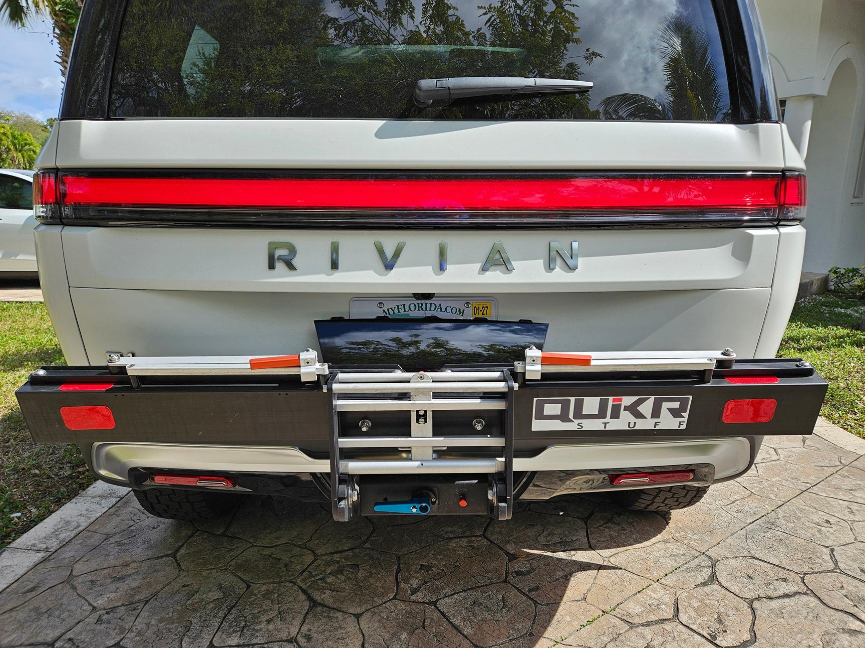

The Mach 2 addresses both gripes I have. I have been using it for the past 3-4 months and here are some thoughts:
The Good:
1. Installation and removal is such a breeze. No tools needed and it is much lighter than my previous bike rack set ups. It is a quicker set up

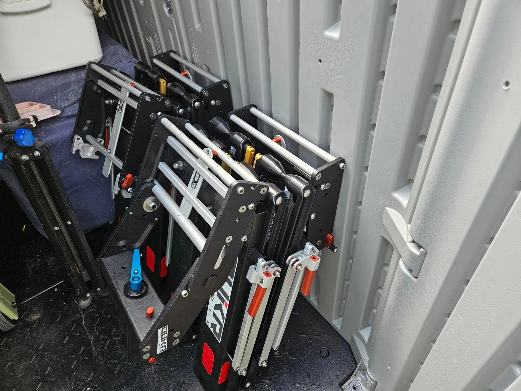

2. Storage is great. It folds to a less bulky state.

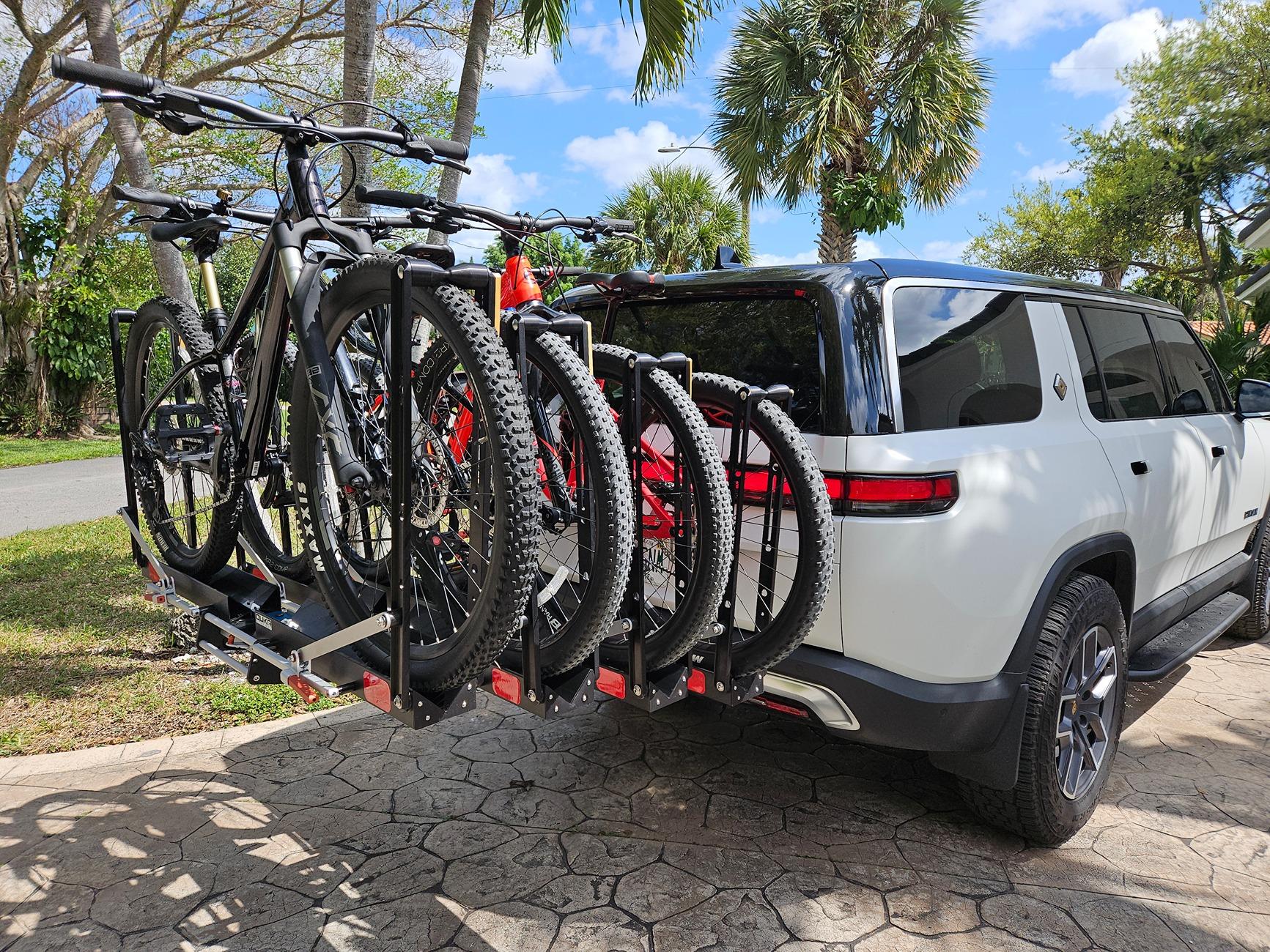

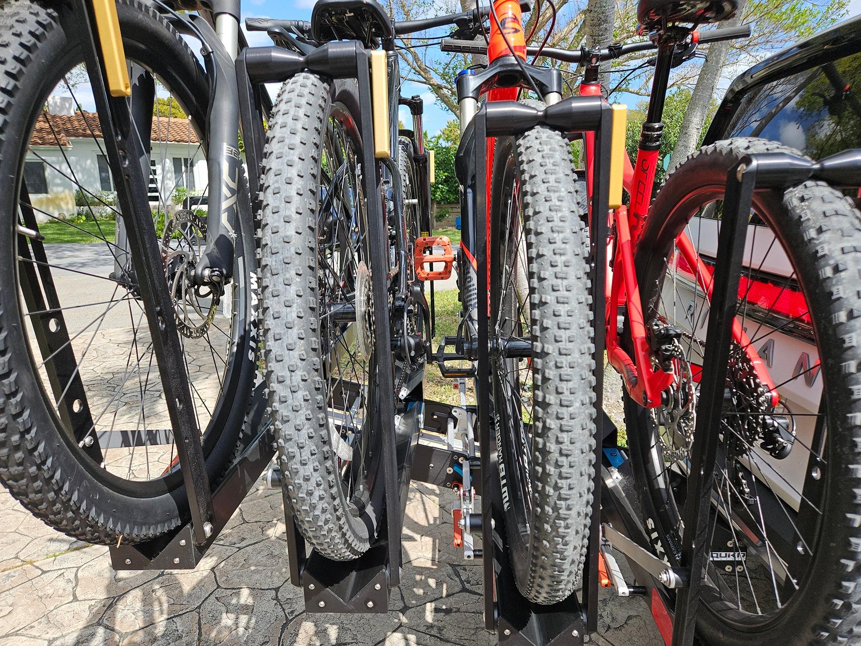

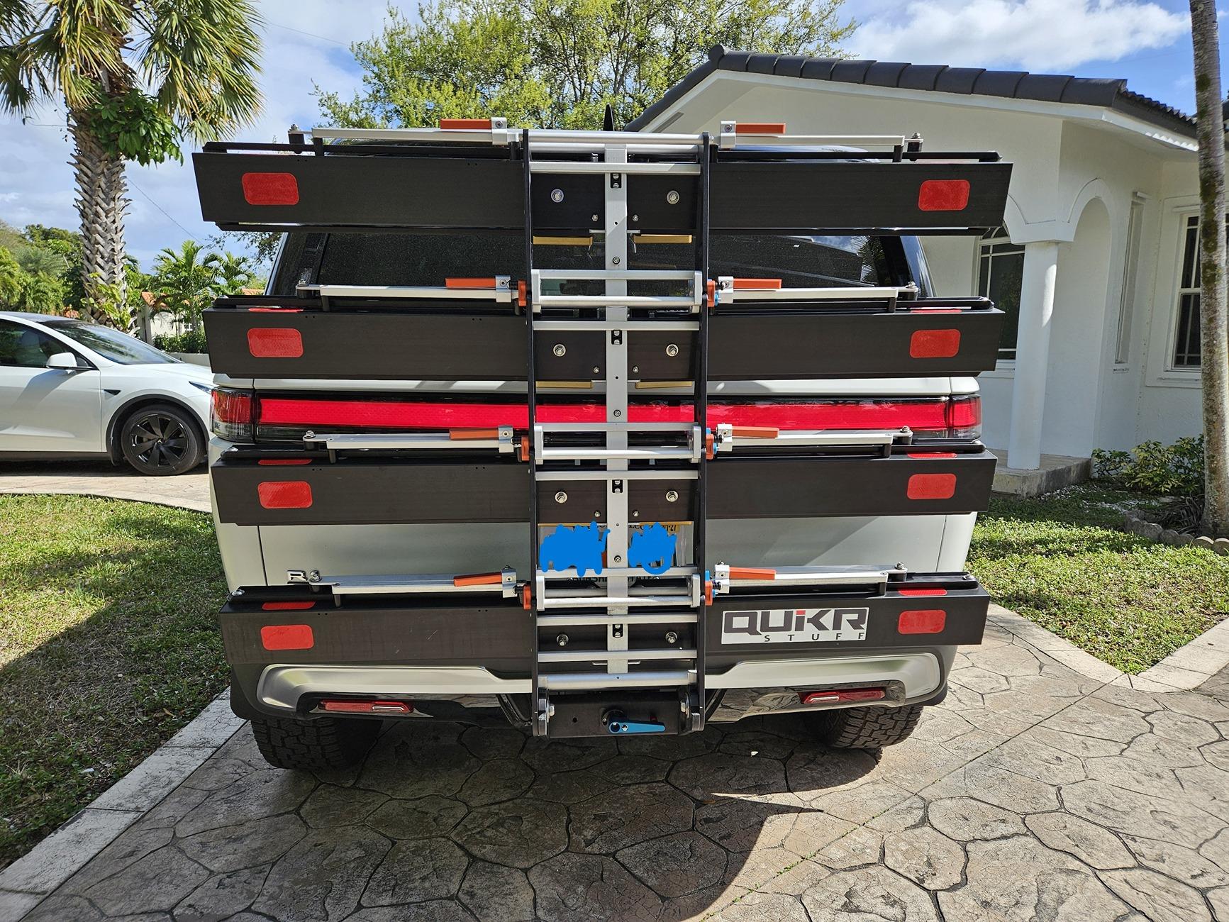

1. As you add a rack the platform increases in height. It is a good thing in a sense that the bikes are not touching and rubbing. It just takes more effort to put the bikes on as you increase the number. There is an accessory ramp that you can buy to help with this. I did not get it.

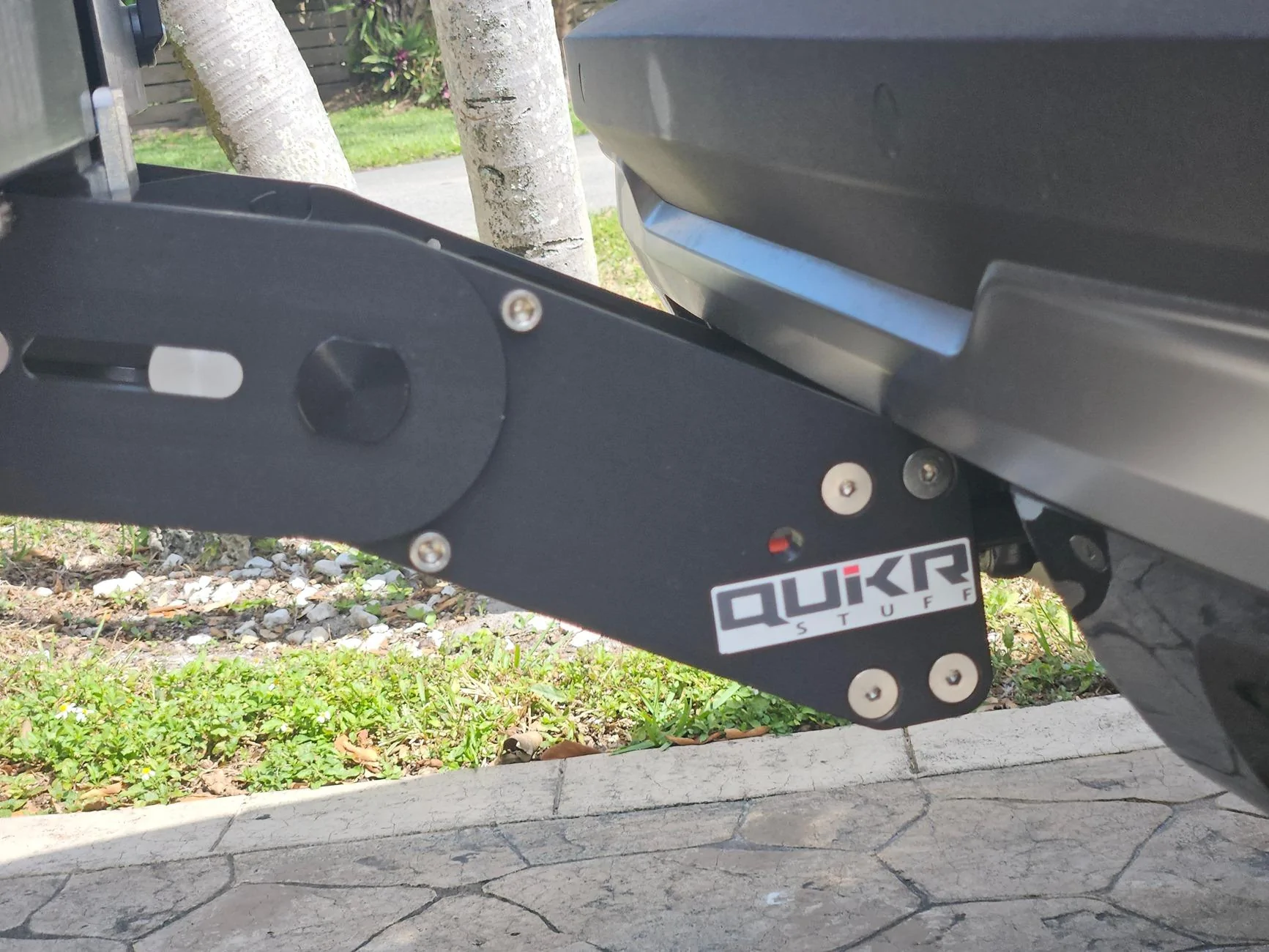

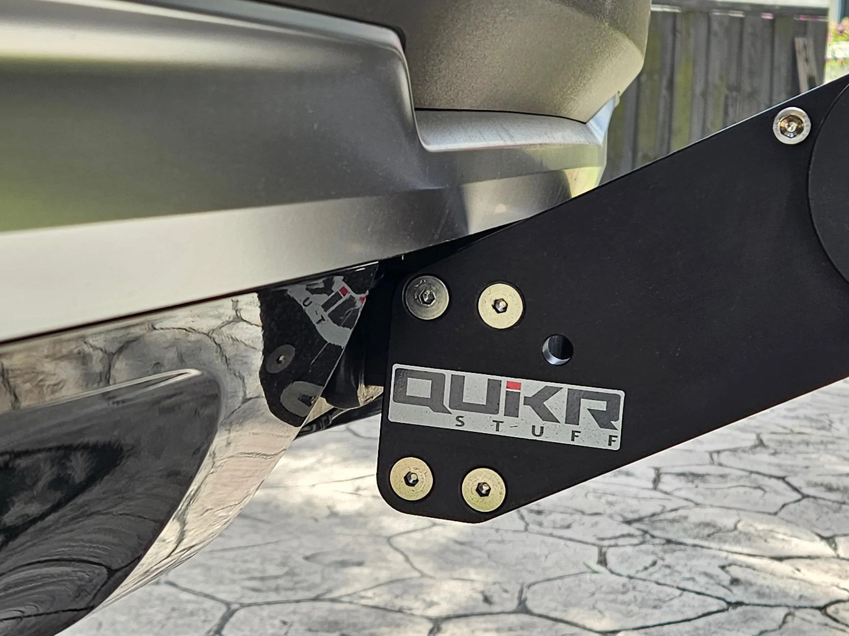

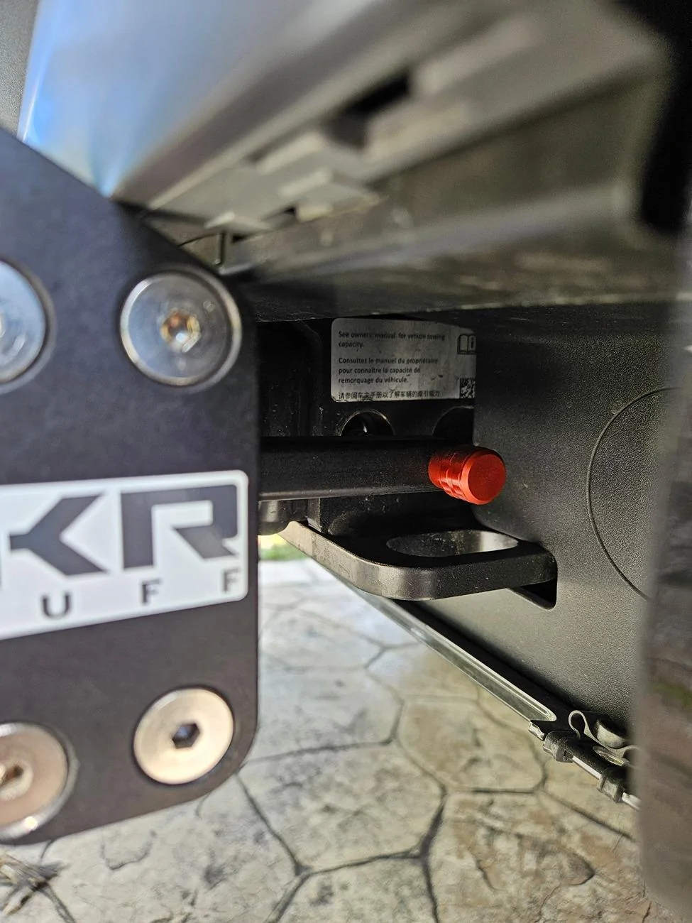

2. The base rack comes in contact with the bumper quite slightly. When I use it as a 1 bike carrier I can slightly pull it out so it doesn't touch the bumper.

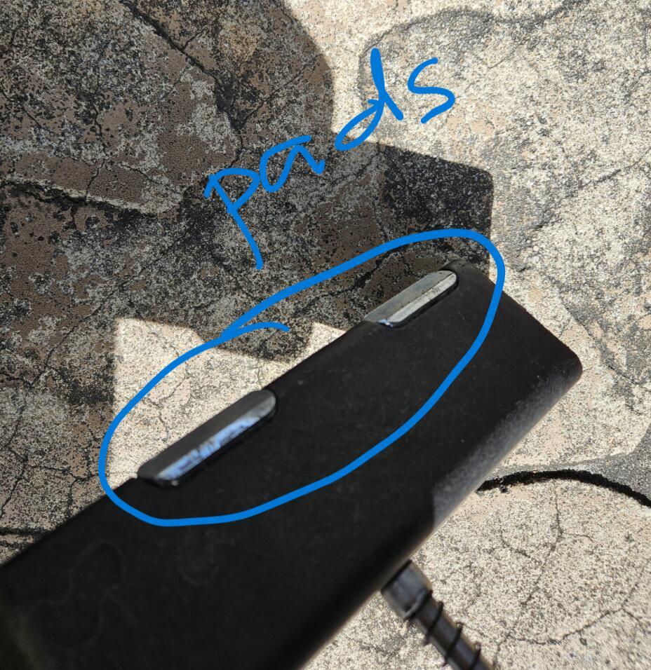

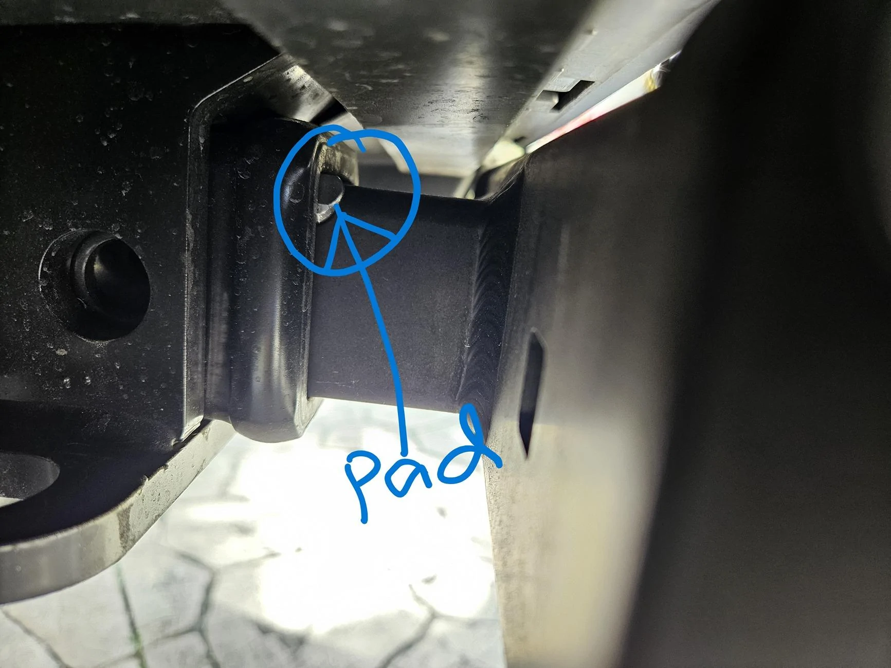

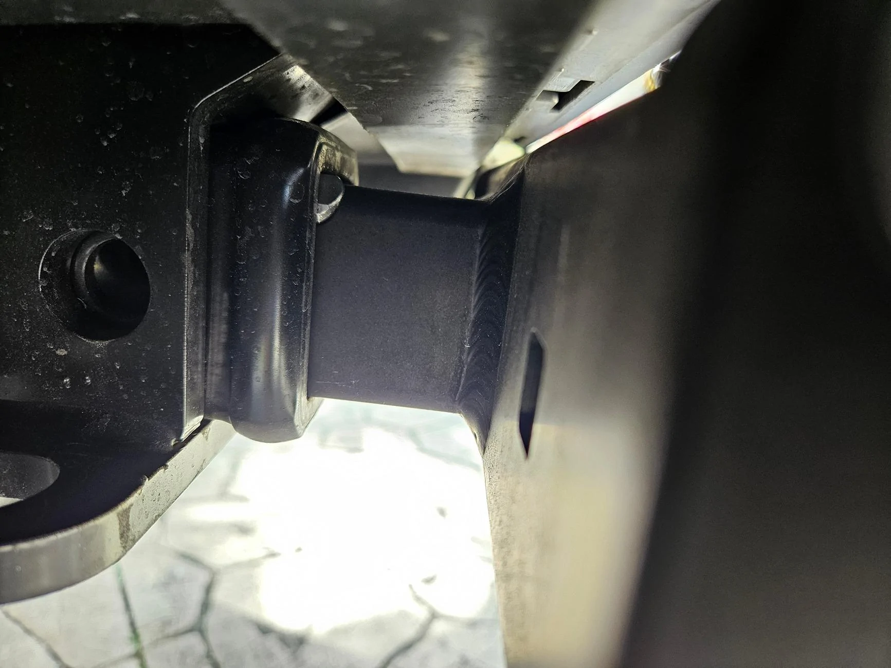

3. Because the hitch of the R1s is recessed, the tube part that goes into the reciever does not go all the way in. There are pads that expand in the tube to secure the hitch and a small part is out of the tube. Since I only carry 4 adult mountainbikes it is not a problem, If it was 4 ebikes then That would be a problem I guess. This rack is also rated for ebikes.

It is an expensive set up but if you look beyond the cost and for the amount of use that I do, it suits me and my family well. I cross shopped it with 1up and the main reason I went with Quikr is the no tools, the ability to go 1-4 bikes in a breeze and the compact storage. You can technically put all 4 of them in your trunk! Hope this helps someone.

Height from the bumper
Rivian R1T R1S QuikrStuff Mach 2 Hitch Review 1 to 4 bike rack with R1s 20250222_122244
Height from the last rack:
Rivian R1T R1S QuikrStuff Mach 2 Hitch Review 1 to 4 bike rack with R1s 20250222_122307

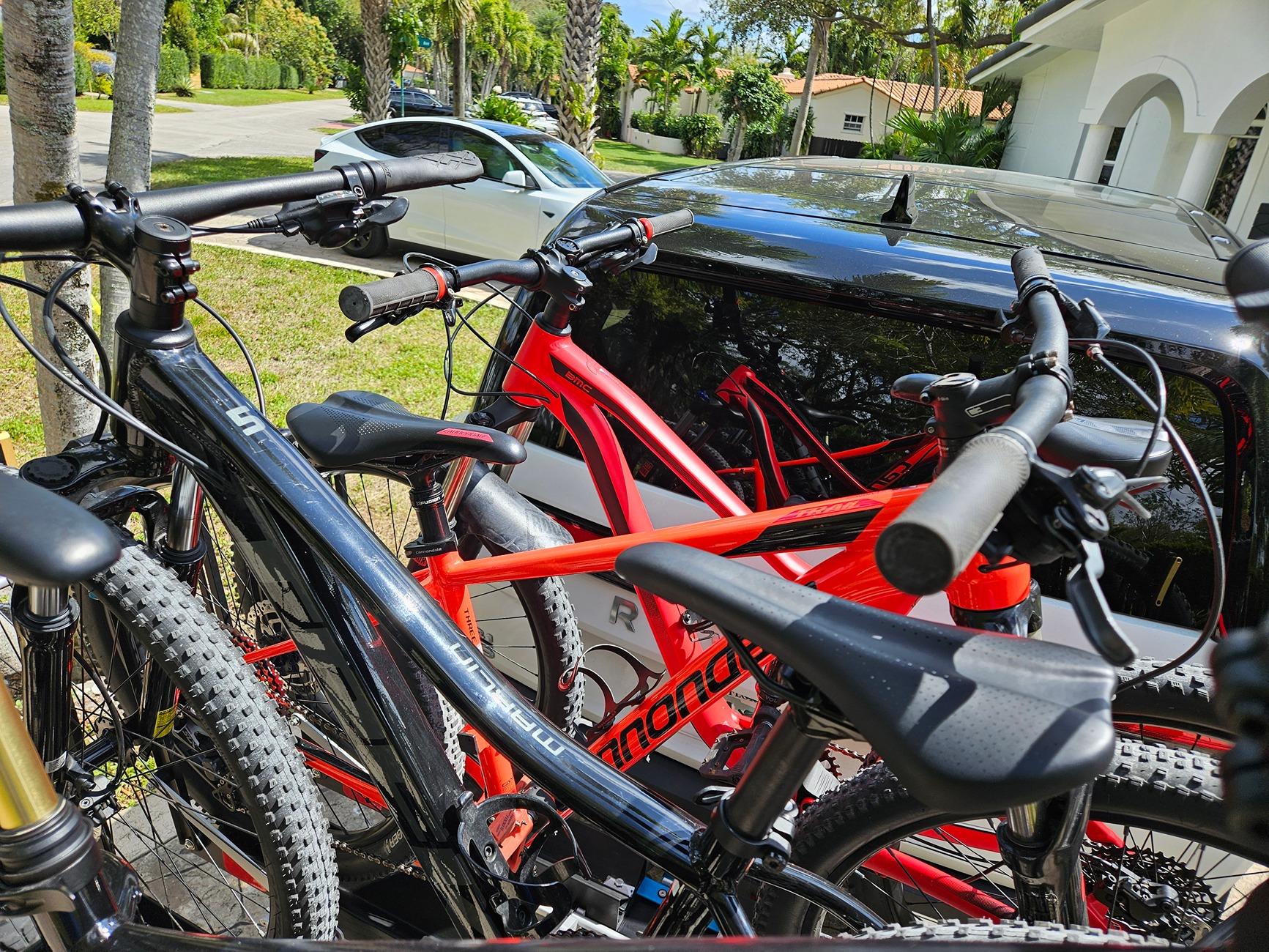

Distance handlebar to the rear of the R1s
Rivian R1T R1S QuikrStuff Mach 2 Hitch Review 1 to 4 bike rack with R1s 20250222_121702
Folded up on the R1s
Rivian R1T R1S QuikrStuff Mach 2 Hitch Review 1 to 4 bike rack with R1s 20250222_141634
Rivian R1T R1S QuikrStuff Mach 2 Hitch Review 1 to 4 bike rack with R1s 20250222_141616

Good review on the QuikrStuff Mach2 bike rack--something I was eyeing. Not to my liking, I feel that the rack is too close/touching the rear plastic bumper. However, that rack does seem very solid overall. I heard the original QuickrStuff designers sold their 1UP company and now that the non-compete is done, they re-entered the market with this offering.
From a design standpoint, I think the R1S hitch receptacle is about 1" too recessed in from the rear bumper for this issue and it's a reach to get in to put in the hitch lock pin.

I have the QuickStuff rack and it has been awesome. I also bought the ramp. Makes it so much easier to load an ebike. You can also get all the locks keyed alike even if you add on something later.
I like the stadium seating for the bikes to get higher so they don't hit but the downside is probably a bit more wind drag. Probably less of an issue on an R1S. It wasn't cheap but was worth the investment. Make sure you heed their warning about what order to do things so you don't break anything.

quick question: does the tube part that goes into the hitch receiver stick out more so when you position the base to not touch the bumper? (Disclaimer: know nothing about hitches or racks) thanks!

I have the QuikrStuff rack which I use for three heavier e-bikes. Modular, lightweight and ramp make this the best by far of multiple bike racks I have owned.
Regarding the ‘too close to the bumper’ question, I use a receiver extender (actually from 1Up!) to give the rack a little space from the back of the R1S.

@Quadsquad, Wouldn’t it reduce the weight carrying capacity of the rack if an extender is used? I ask because I too own QikrStuff Mach 2.
