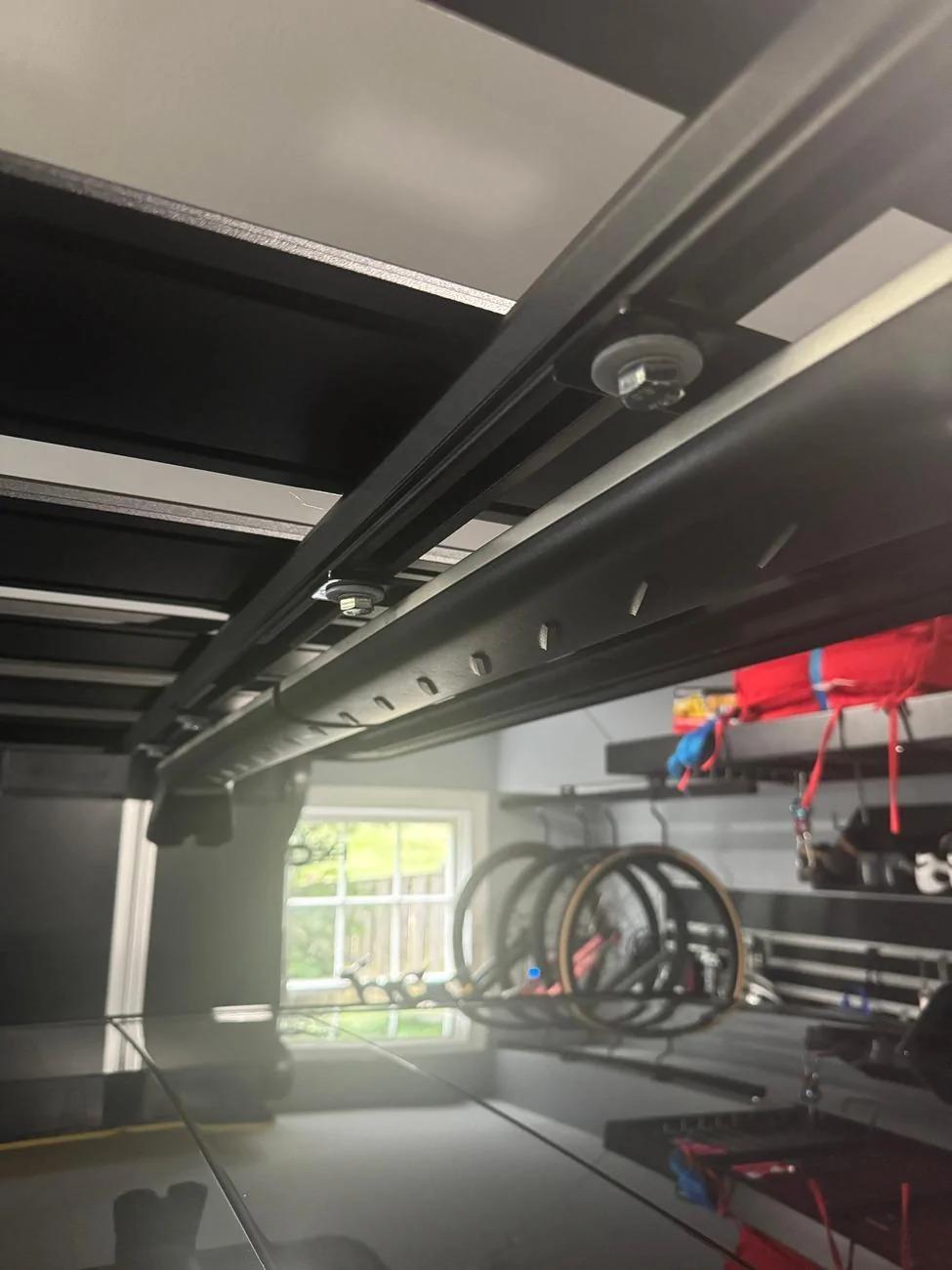

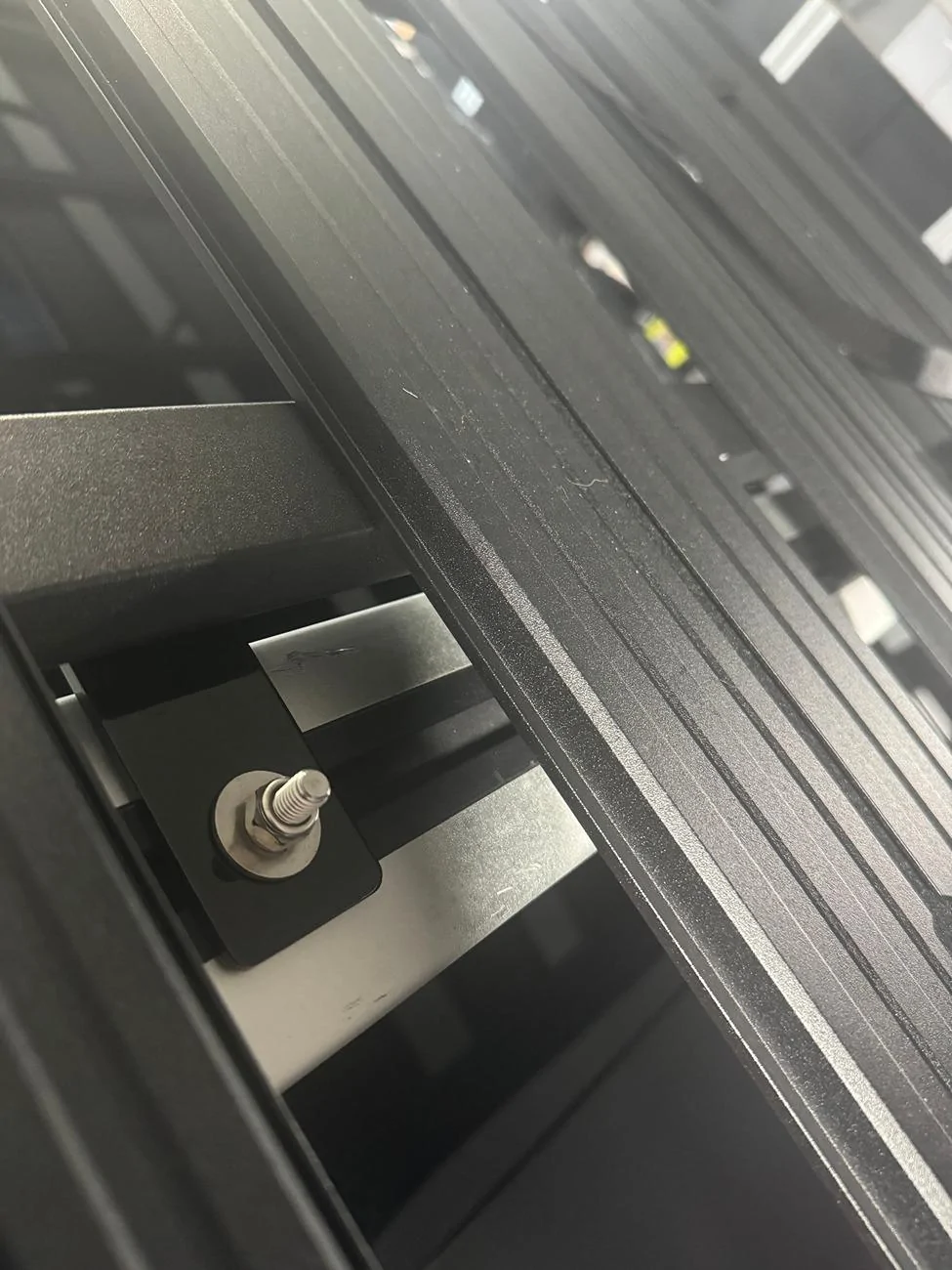

I just purchased a Rhino Rack Pioneer 6 Platform and found the rack very well built.
I wanted the slimest profile possible and didn't want to use bulky clamp style mounts.
Since the OEM bars and the Rhino Rack use t-tracks, I thought a t-track to t-track solution would give me the best look and slimmest profile. But such a thing doesn't exist! Maybe it does and I couldn't find it. But it was very difficult to find a solution to go from t-track to t-track.
I ended up using the UpTop 1" Tent Riser kit as it allowed me to stagger the t-track bolts forward and backward for the crossbar and the platform, if that makes sense.
It didn't provide any advantage over a clamp style mount, it was just as bulky, and was definitely more work. Oh well.
¯\_(ツ)_/¯
I got a Rhino Rack 84" x 49" and used two of the HD adapter kits... however, the plates that come with that kit are sized such that the bolts impact the Rivian roof bars. Also, the large pieces that you screw into are too big for the t-slots int he Rivian bars. So I got some T-slot bolts to go into the Rivian bars and I used SendCutSend to recreate the Rhino Rack HD adapter plates (added 25mm of length). Now it works great. Using SendCutSend to make the powder coated plates was easy as pie.

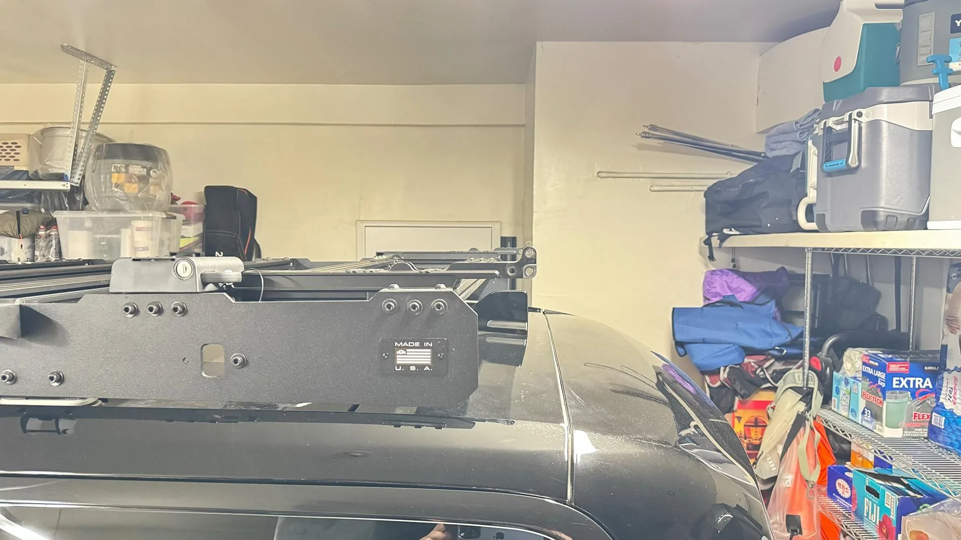

I have the Prinsu rack on my R1S. I saw the Overland Ruff Rack in person and it is noticeably taller profile than Prinsu. For me the Prinsu rack is the best option for the money. The Pro style is a significant upgrade from their original rack and while the rack doesn’t taper in the back once it’s on you don’t notice it. It is more than half the cost of the ORR rack and even at the same price I would take the Prinsu with its features and strength.
