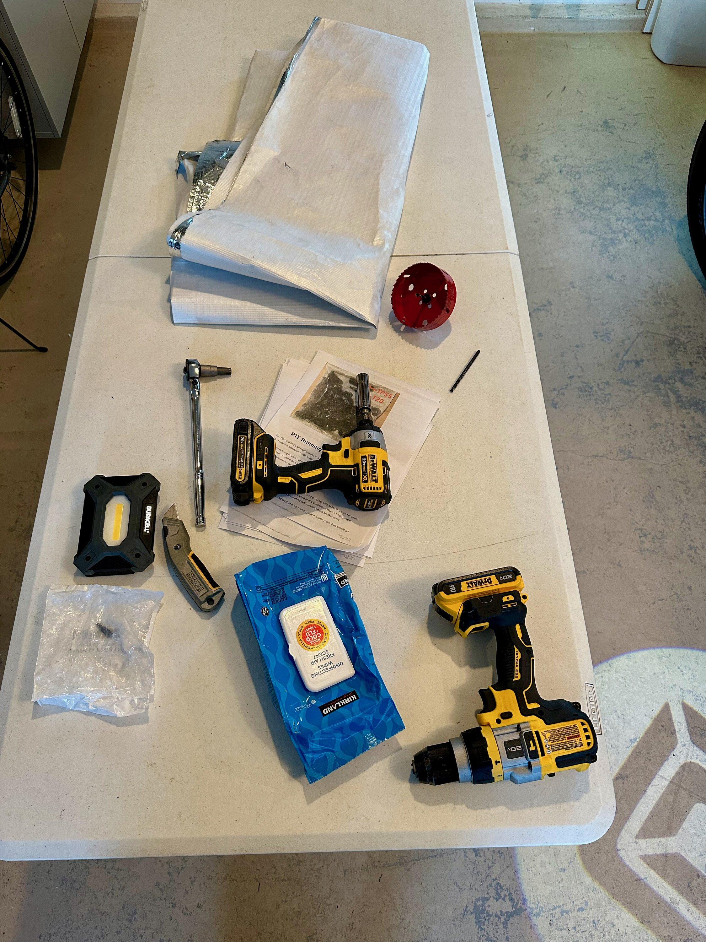

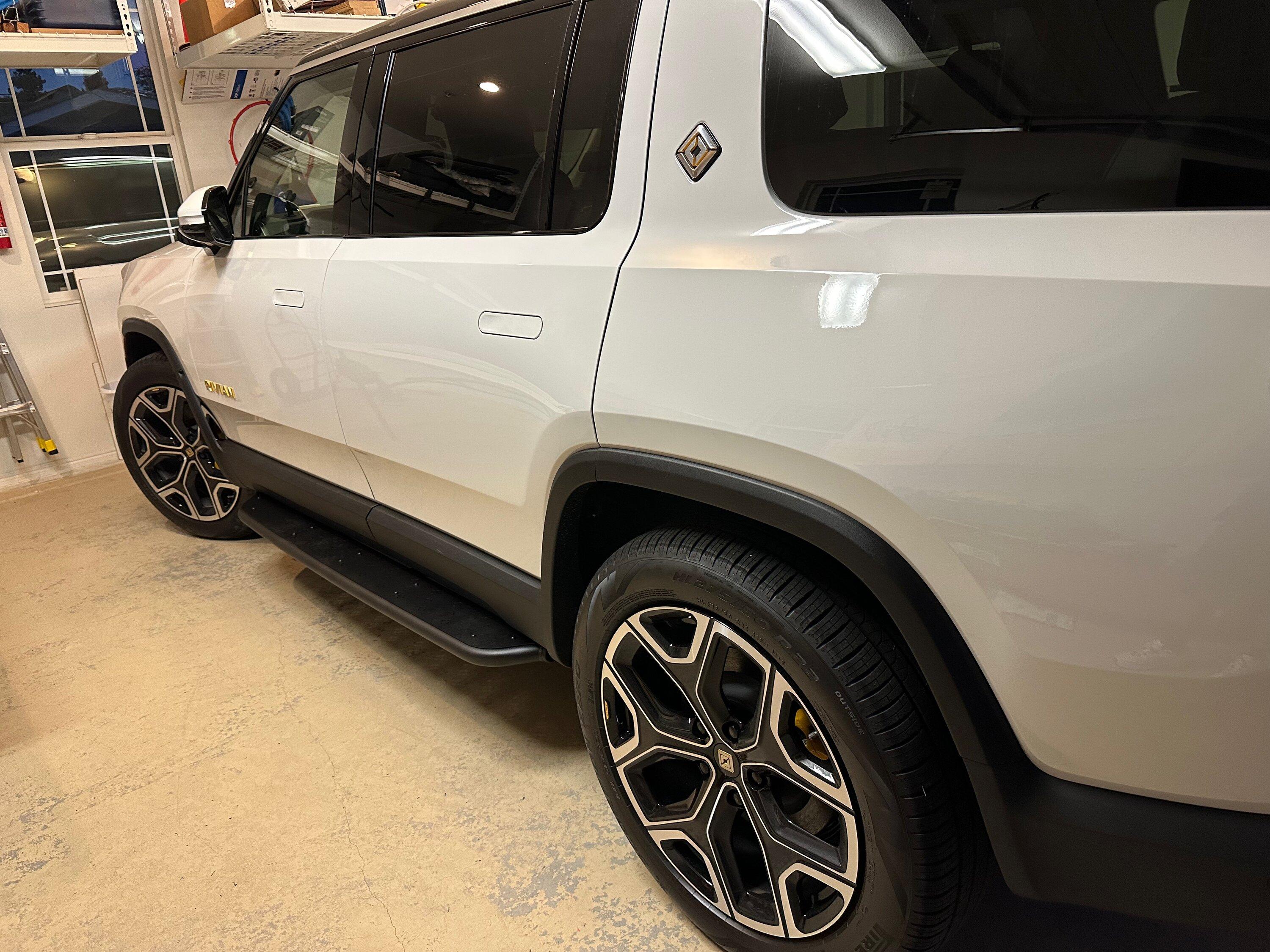

Got them this week have installed them, attaching pictures of the R1S with boards and the tools used.
Boards are easy to install - I did it by myself took 2-3 hours considering everything - followed the instructions. Some tips below -
  1. R1S needs to be in off road mode max height.
  2. Used the 4 inch hole cutter, easiest method.
  3. I used the template provided in the instructions but made a hole to center with a regular drill bit, then used the 4 inch hole cutter, this saved time, you could also use the hole cutter on the template directly - take your time to get the template aligned correctly.
  4. Does not matter day or night take a light with you under the vehicle.
  5. Do not use a drill with the supplied TP55, almost took my hand off :) use a drive ratchet (pictured) with as long a handle as possible - it takes strength to unscrew the factory bolts.
  6. Careful when putting the bolts in with the running board attachments and tightening them back - make sure the threads are going in right.
  7. I placed the running board on two chairs then went under the vehicle to attach them.
  8. Before super tightening everything make sure the boards are lined up from the outside - will save you a few iterations.
They are a pleasure to use - Happy Family :like:
