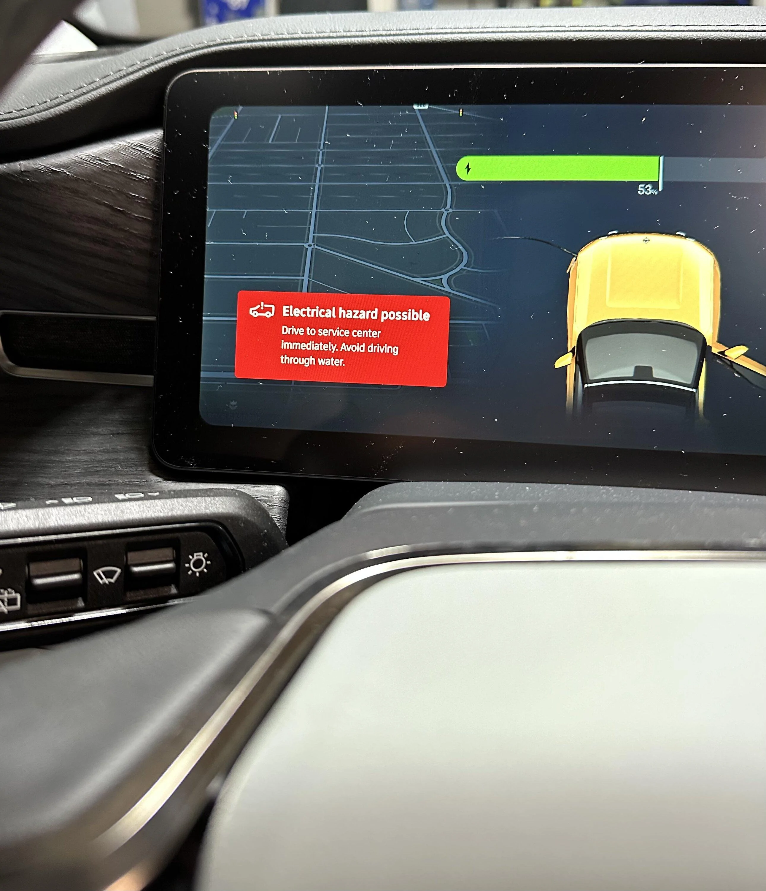

One week in and 450 miles and mine wouldn't charge either - also started giving me this very scary error message.
I had no issues DC fast charging, but the first time I tried to level 2 charge at home this error popped up and then every time I tried to plug in the car the charge port was red. Full reset didn't help.
Car's been in the service center for a week and on mine they said they're replacing the onboard charger.
Edit: This is a quad motor large pack, 2023
