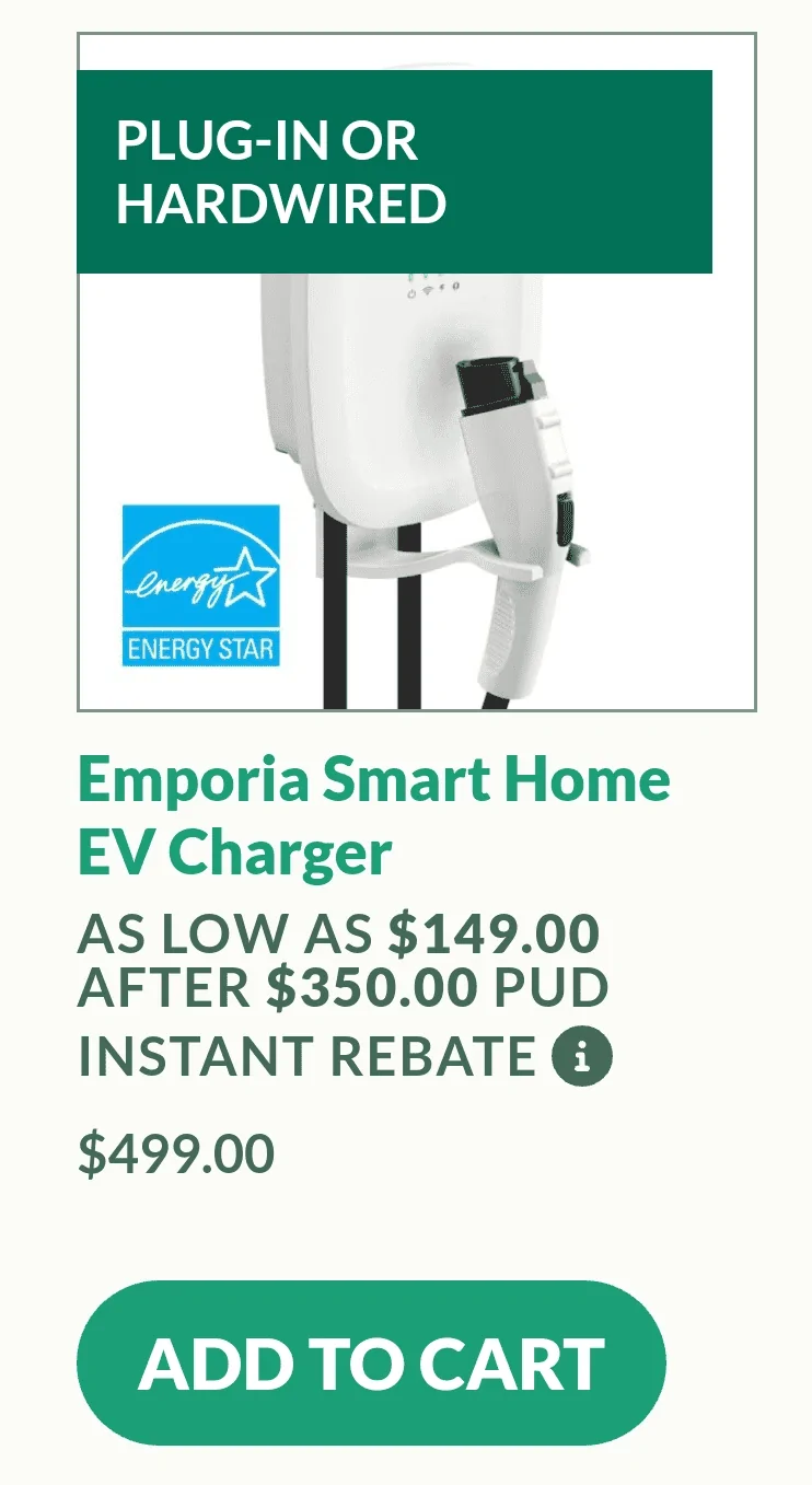

I recommend a quick check with your local PUD. They might have some discounts there as I picked up my Emporia charger for $150. I charge my R1T at 40 amps (as well as the wife's Model Y) using a 14-50 though you can hard wire it and get 50 amps.
Rivian R1T R1S Recommendations for home charger? Screenshot_20230528_171616_Edge

The Emporia charger is a great value and is usually around $399. Itā€™s also a smart charger and you can monitor all your charging stats and energy usage. If I hadnā€™t got the Rivian charger at the original price I would have bought the Emporia.

I can also recommend the Emporia. I paid $399 without any incentives. Iā€™m currently charging at 40A plugged into my 14-50 outlet, but plan on hardwiring to get 48A. I donā€™t need scheduled charging because my rate isnā€™t time sensitive, but itā€˜s available. Itā€™s upgradable, easy to set up and has worked flawlessly so far.
