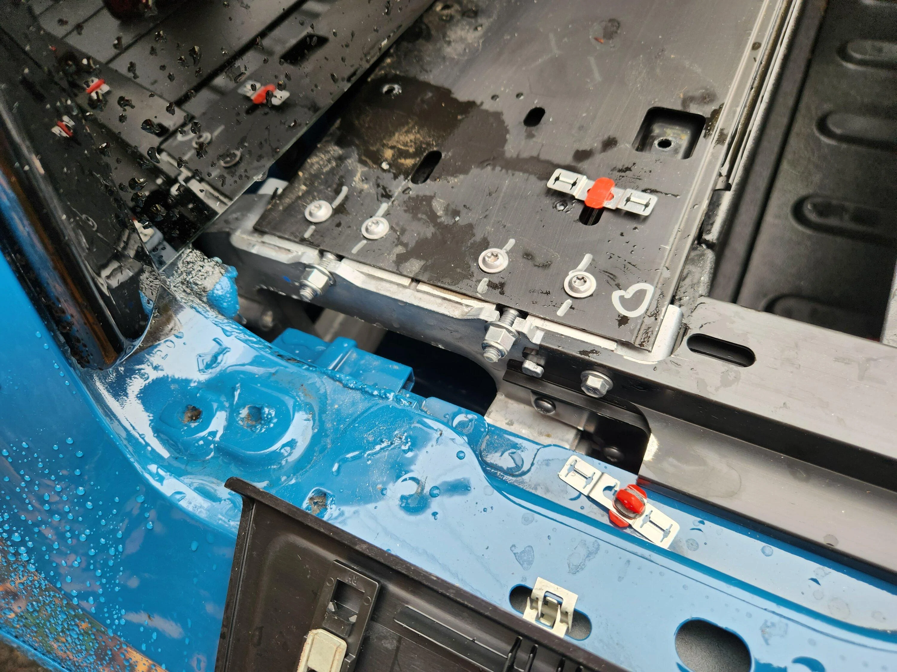

Edit: So I took a crack at it. Not very hard. All of the plastic just pulls right up except for the one right behind the rear glass. I took these pictures backward as I had already ripped it apart. Pull up the side plastics and then the little plastic covers behind the rear glass that cover up these torx, then pull those out.

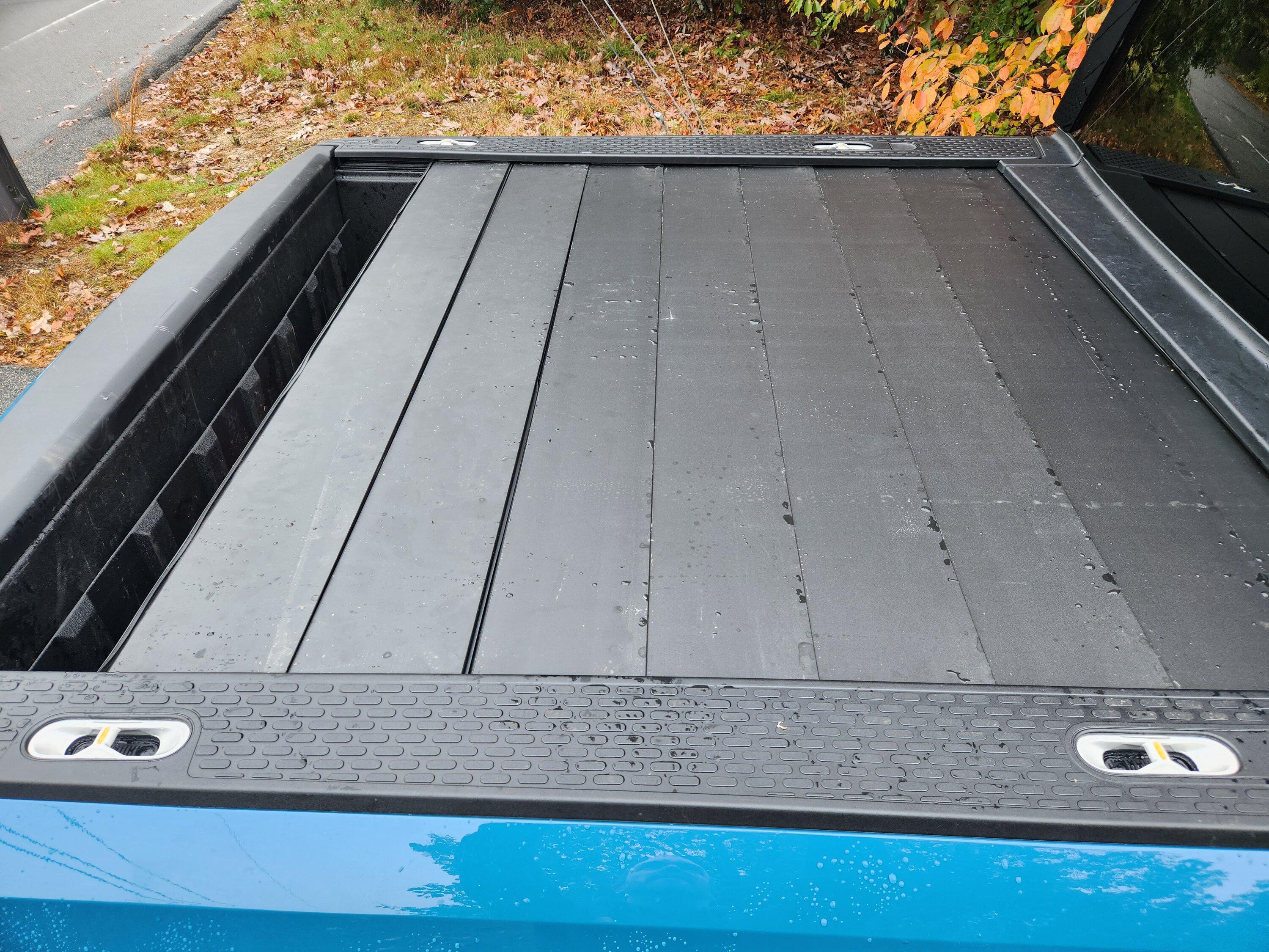

The top cover will be removed (with the plastic on it). Kind of a pain because it flips behind the rear glass, and its basically impossible to install again without undoing the torx bolts that hold it to the cover, installing the metal cover again, and just relying on the clips to hold the plastic cover in place.

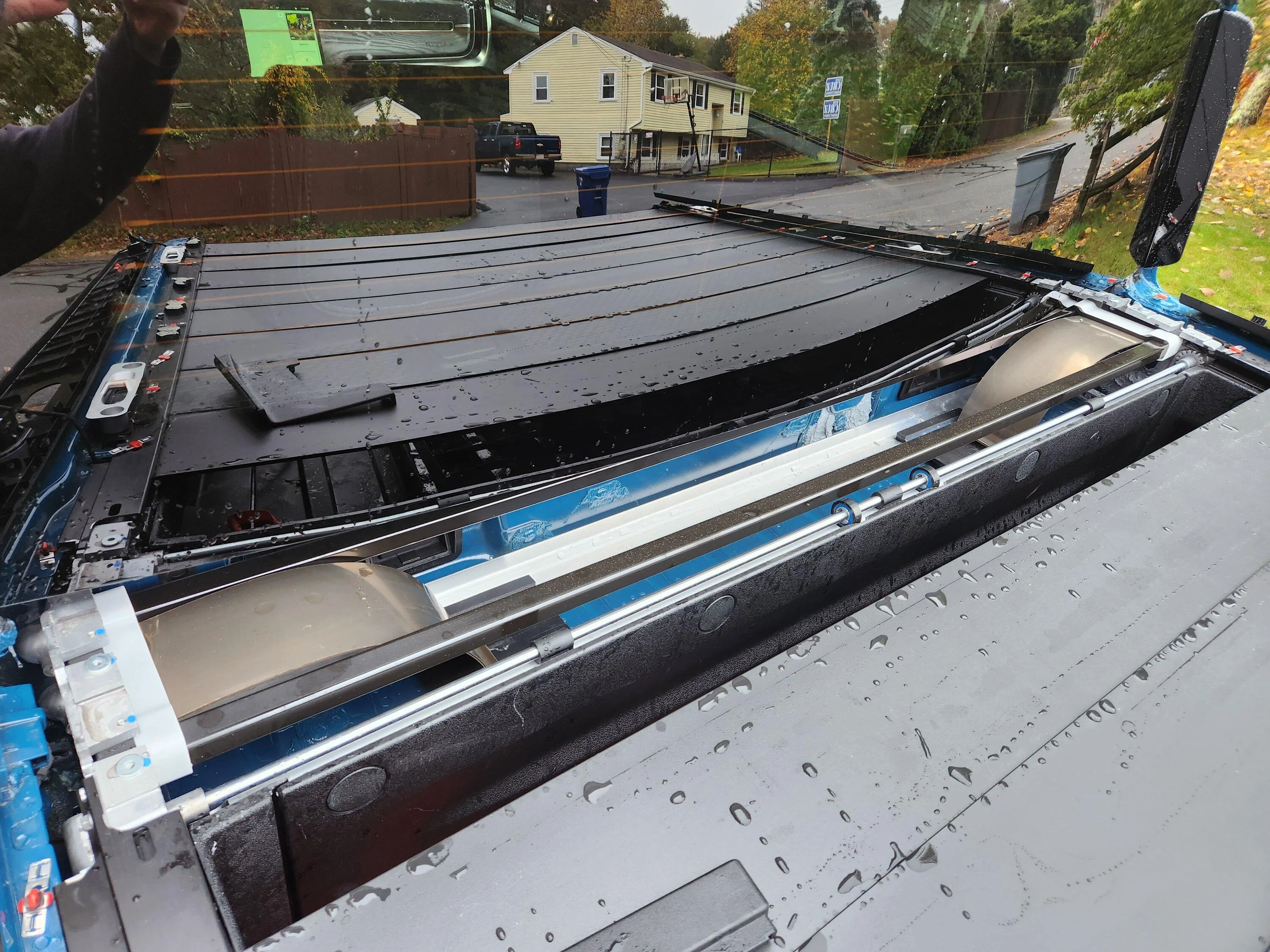

Oddly enough... I seem to be missing an entire slat...

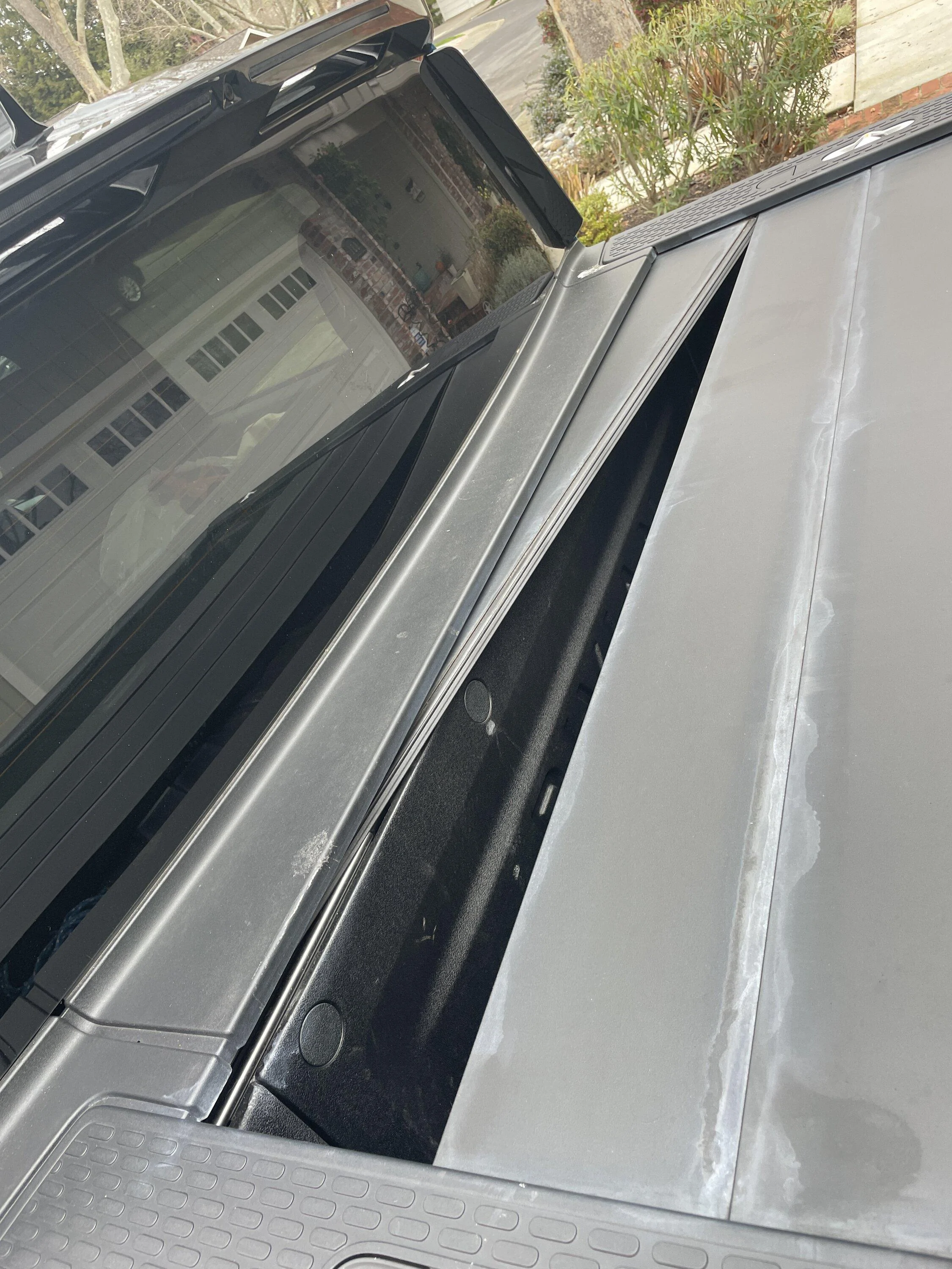

6 months, 5000 miles, and approximately 20-30 opening closing events for the cover, it finally died. Now it looks horrible, can't stow my bike, poor aero, :mad:
Despite constant application of PTFE dry lube (see stains in image), I believe a small stick or other tree dropping is the culprit.
DIY does not look promising. I'll try Rivian service to remove it and request being as high as possible on the rework once it ever starts.
