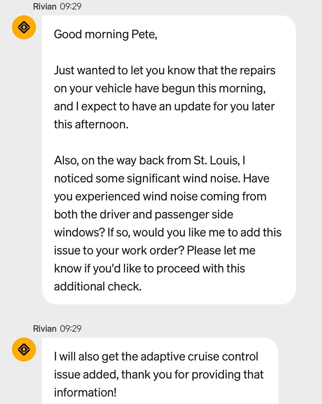

I have faith in the mothership!
The mothership is great! They actually created new a new ticket for wind noise based on what they observed during the drive to normal - I was prepared to live with it as a minor inconvenience based on everything else.

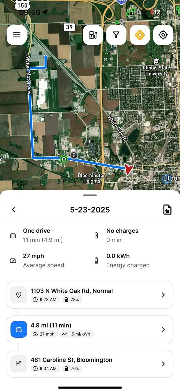

She’s moving again! Hopefully get an update soon.
