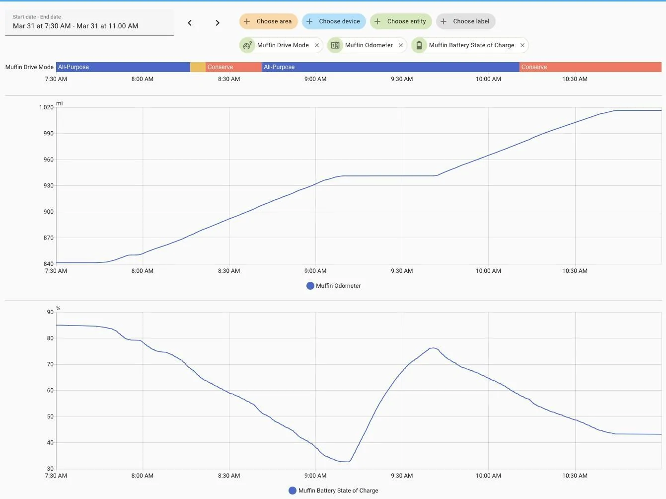

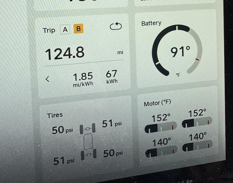

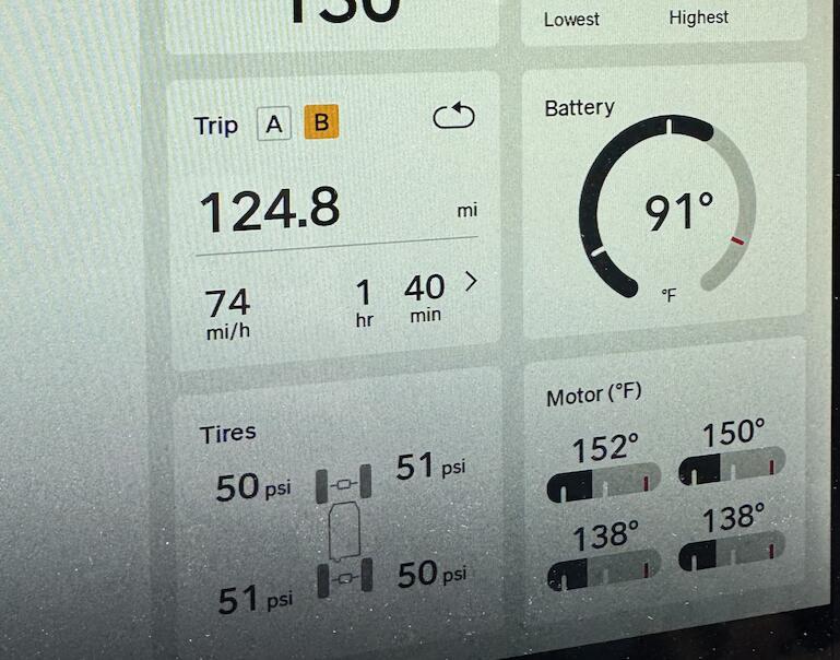

One thing I noticed, and will ask about (considering the front motor suspicion) is the efficiency:
  1. The TriMax needed to take a charging break on the way from STL to Nomal and on the two legs of the journey averaged 1.39m/kWh (@67mph average) and 1.72m/kWh (@48mph average) respectively - mixing AP mode with conserve (other than <10 min in sport). Matching the lower efficiency I've been seeing to date. Without charging I'd have only just made the trip leaving at 85% SOC - as it consumed ~99kWh.
  2. On the way back, the loaner Quad Motor R1T with 20" AT tires did 1.85m/kWh (@74mph) over the 125 miles I got trip data for - in AP the whole way. ~67kWh. No need for a break and arrived home with ~30% left.
The wind was mostly east-west, and there's very little elevation gain (a couple hundred feet total) - so I'd have expected to see very similar consumption, ideally showing greater efficiency for the trimax with street tires/wheels. Will mention it to them, incase it helps work out whats going on.
Muffin Data:

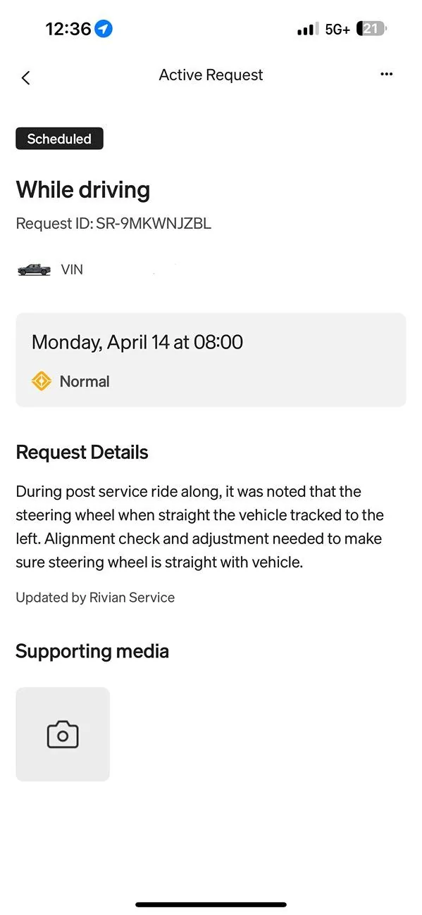

Erm. They can’t align it, as the guy who does has not turned up today and the duty SC manager can’t get hold of them - they would like to keep it in until they can. Currently you need to hold the steering wheel at around 1 o clock to drive straight, if the wheel were an hour hand. So I’m driving back to stl in a loaner, need to wait in the reception here until they have got enough charge in it to make it back :( Another 7 hours of driving wasted and a Saturday written off - oh well.
Rivian R1T R1S [Resolved again!] Why am I doing this to myself - long time Rivian customer close to giving up. IMG_4735
Edit: removed photo of factory floor at Rivian’s request (don’t know if they are reading here, but certainly are Reddit where I had posted the same picture).
7,170
13,927
It sucks they couldn't do the alignment. I'm glad the rest of it is ironed out.
