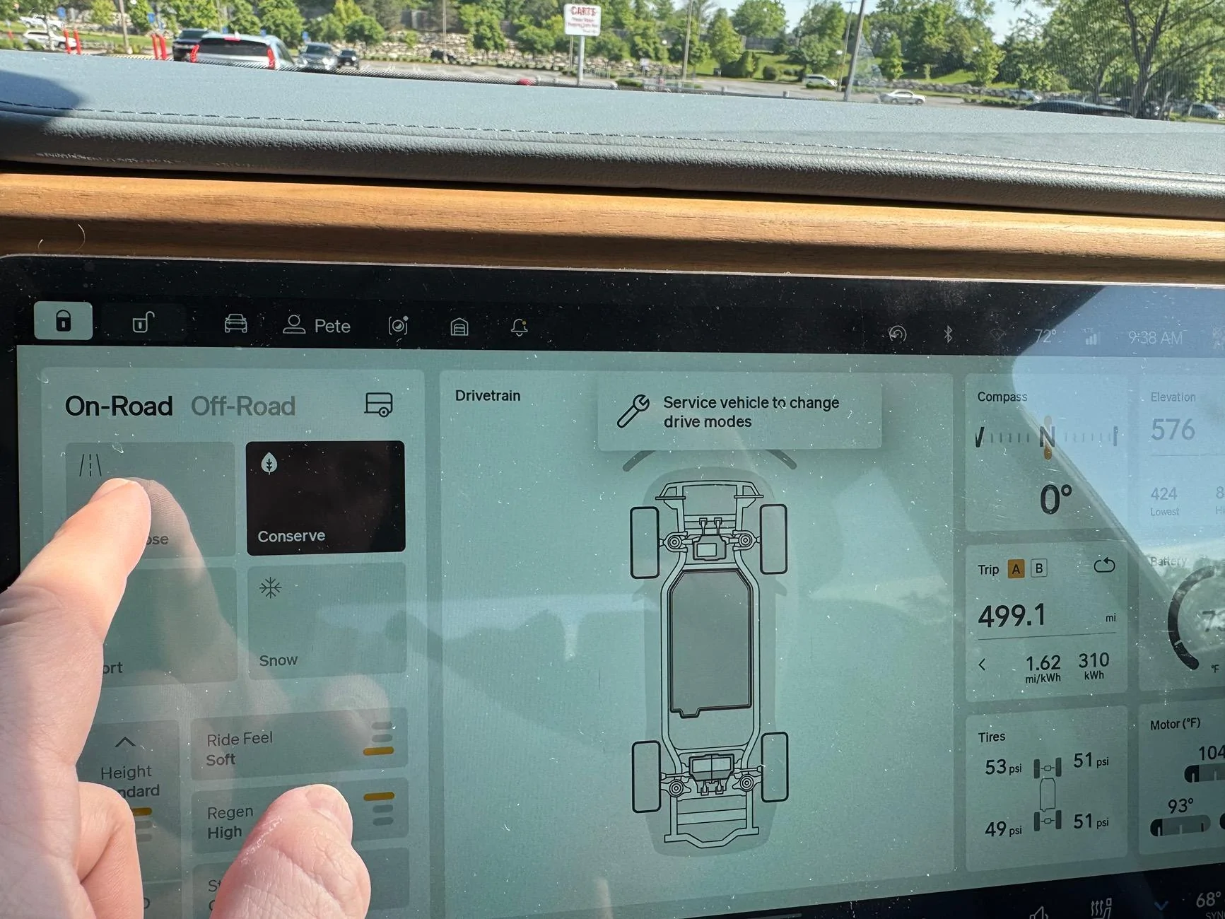

Sigh. It’s like it heard me telling people how Rivian had fixed everything.
Rivian R1T R1S [Resolved again!] Why am I doing this to myself - long time Rivian customer close to giving up. IMG_4993
Rivian R1T R1S [Resolved again!] Why am I doing this to myself - long time Rivian customer close to giving up. IMG_4991

After a hard reset (soft reset did nothing earlier) and sitting on the driveway for an hour, it seems to be working again - but I’m spooked; just when I thought this was all over and was starting to plan a road trip/picking out a roof top tent.
