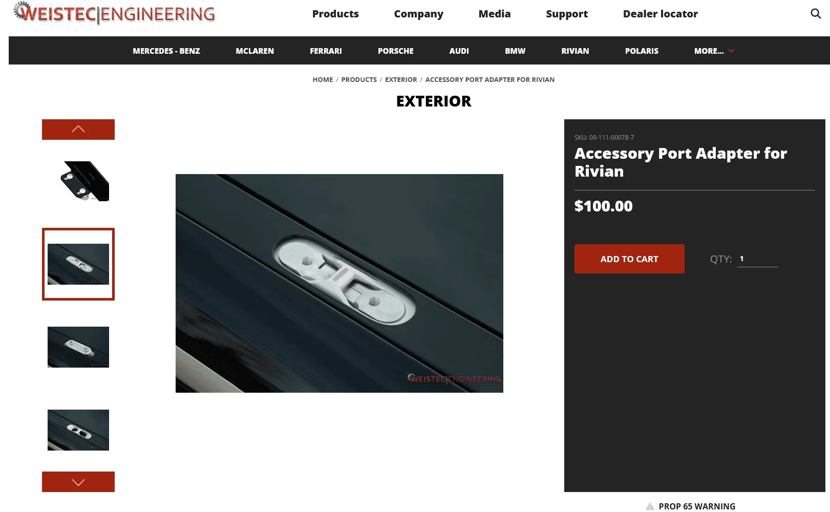

So I’m trying to come up with the best way to attach some custom 80/20 extruded aluminum accessories. The accessory ports for the cargo crossbars provide some major advantages over bed rails if I can find a good solution. Right now, it appears the only adapters I can find are made by Weistec:
https://www.weistec.com/accessory_port_adapter_for_rivian.html
Although I can respect that R&D costs need to be recouped, $100 per adapter is just too much for me (similar adapters for Molle panels, for example, are about $5 each).

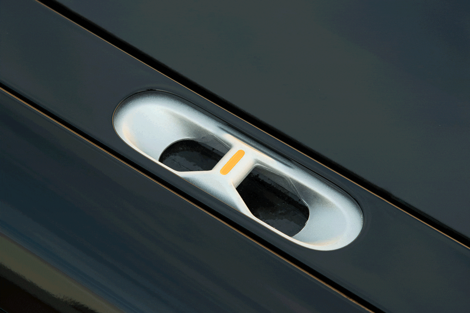

I've been dreaming of a wire cable slipped under and then pulled in tension to lock whatever is needed down to the port. Haven't heard of anyone else thinking about that and I don't know if it is because it is wildly unsafe or plausible.

I'd be idly curious to see a video how these install? Do the factory inserts remove? Or do you drill through them?
I believe the lower pair slide in from each side of the yellow bit, then the top cover sandwiches around and only bolts to itself with no modifications to the stock anchor system needed. Same bolts hold whatever you want to mount down too. Smart (but expensive) solution.
goldburger
Feb 5, 2022
1,670
1,951
Neither, based on the gif on that page
Rivian R1T R1S Rivian accessory port adapters (to attach some custom 80/20 extruded aluminum accessories) access-adapter
Also the video on that page haha
