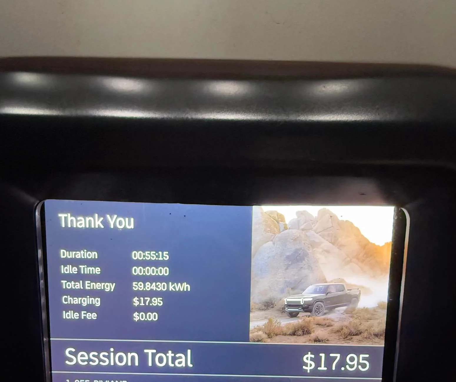

Hello, newbie question again. Is there a setting I need to adjust? I went to charge at a Rivian Network charging station and they promote all over the place that it can get you 140 miles of range in 20 minutes and up to 200KwH. https://rivian.com/experience/charging I got not even close to that. It took about an hour to get 120 miles and was getting at most 77Kwh but was mostly around 59KwH.

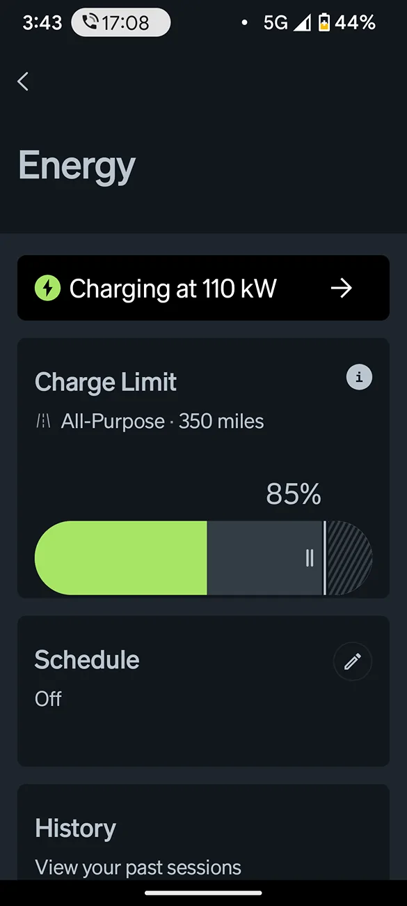

Also seeing slow charge rate at the San Antonio RAN today.
Navigated here by GPS. Ambient temp 70F. SoC ~35% at session start.
Plugged into charger 2 slots away from the only other Rivian charging.
Was charging at 130kW initially. Other Rivian an left. Charge rate dropped to 110kW at 50% SoC.
Not at all what one would expect from a 300kW max advertised rate.

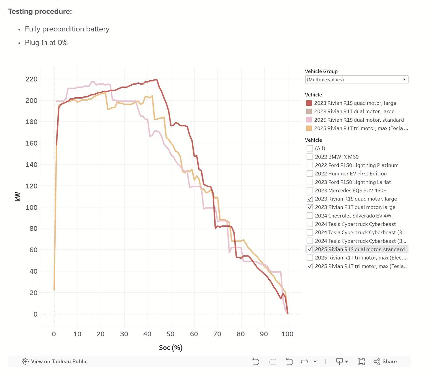

The period of time that you can expect 200kw or over is very small. For the large pack it's from about 2% to 45%. After 45% it drops significantly. If you plugged in at 35% and weren't getting fast rates for the first 10% or so, it's likely one of the reasons listed above -- ambient temp, battery not at optimal temp, you were using a shared charger.
About the only time you can really expect to get the optimal speeds is on a road trip -- you've driven an hour or two so the battery is nice and warm and you're arriving at a low state of charge (10% or lower). When you plug in under these circumstances, you'll notice very fast rates initially before it tapers.
EDIT: You'll NEVER see the 300kw advertised rate. No Rivian can currently charge that fast. 220kw is the fastest possible. The 300kw is the max the stall can offer - potentially for a non-Rivian to take advantage of.

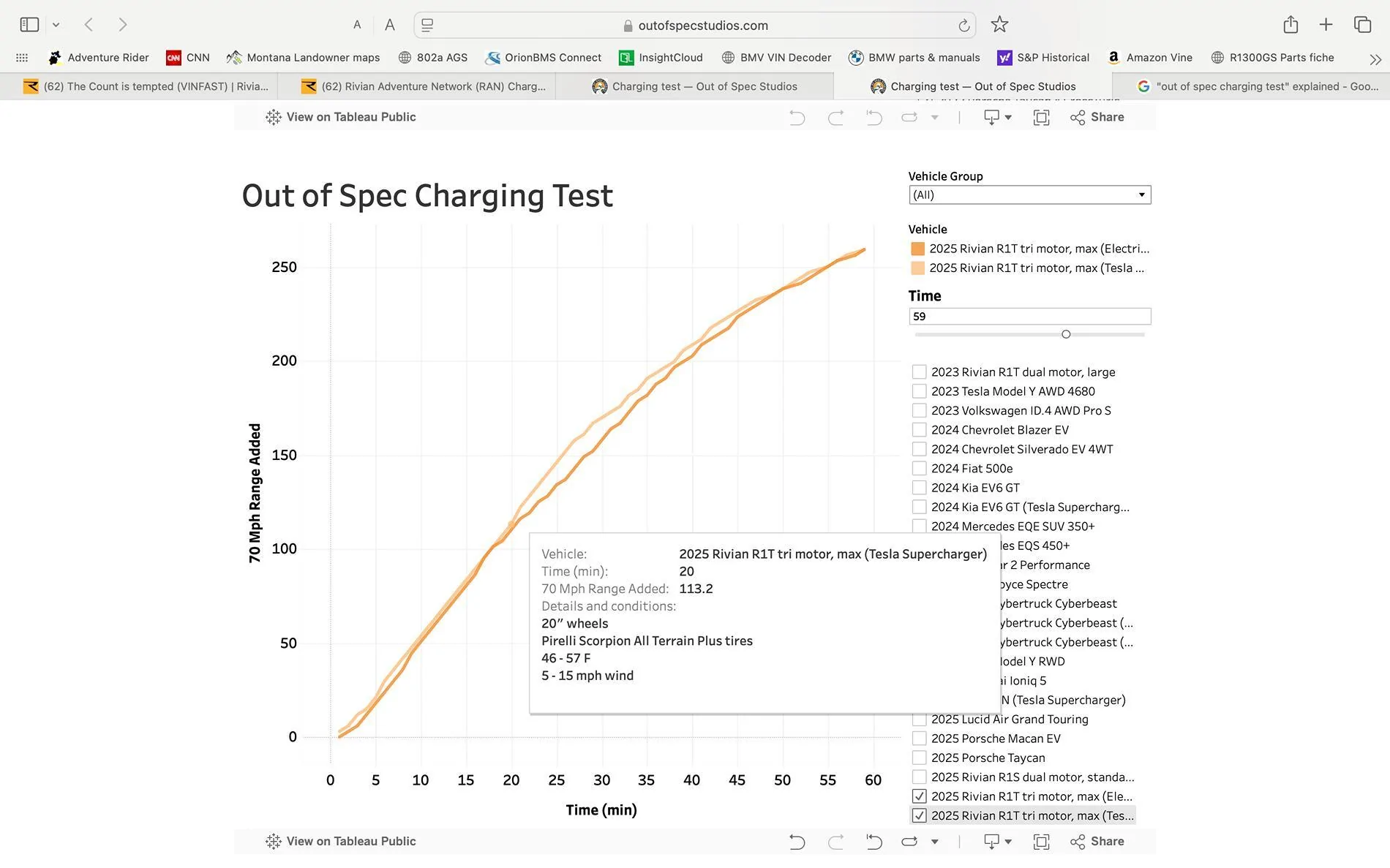

Here you go. The charge curve or various Rivian batteries.
https://outofspecstudios.com/charging
Rivian R1T R1S Rivian Adventure Network (RAN) Charging Rate 1739401265316-p3

Thanks for those useful charts. Good to know what to expect.
FWIW, I did clearly state all of the charging conditions in my post that rule out issues like ambient temperature, battery not prepped, or shared charger.
Mine is a 2013 dual max.
