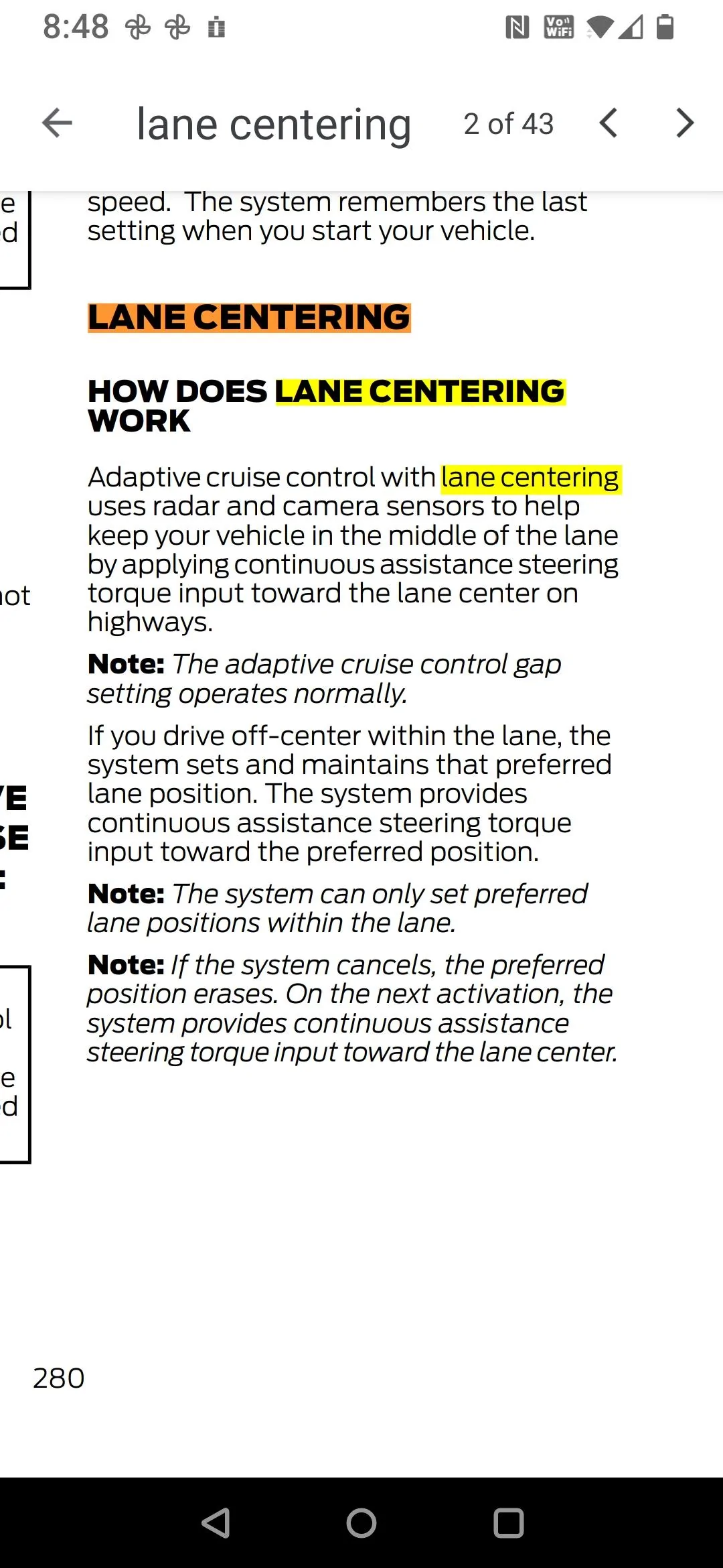

Did you know the Ford allows you to adjust where the truck stays within the lane?
Try this.
Thanks I didn't, but my cheat/hack for not getting warnings is to maintain slight pressure to the left because it slightly hugs the right side of the lane. I have NOT noticed any improvement yet, but I have under 300 miles using BlueCruise atm. If I'm reading that correctly I should notice the centering effect/preferred position while driving and I haven't.
ERguy
Feb 17, 2021
308
464
Midwest
F150
I've only tried it on the Mach E, but it should be similar.
You have to kind of man-handle the wheel for a few seconds. Not gentle corrections. If you hold firm pressure to hold the vehicle in a position while the truck tries to fight you, after a few seconds you should feel the truck suddenly stop fighting you. Then you can let go and continue in the new position of the lane.
If you do it right... It will feel like a tug of war match for few seconds followed by your opponent letting go of their end of the rope.
It's far from perfect even when it works. On my Mach E it will hold the new position well until it goes around a few curves. Then I have to reteach it where to stay again. On a straight interstate it can hold the new position for several miles without difficulty.
Thanks I’ll give that a go tomorrow.
