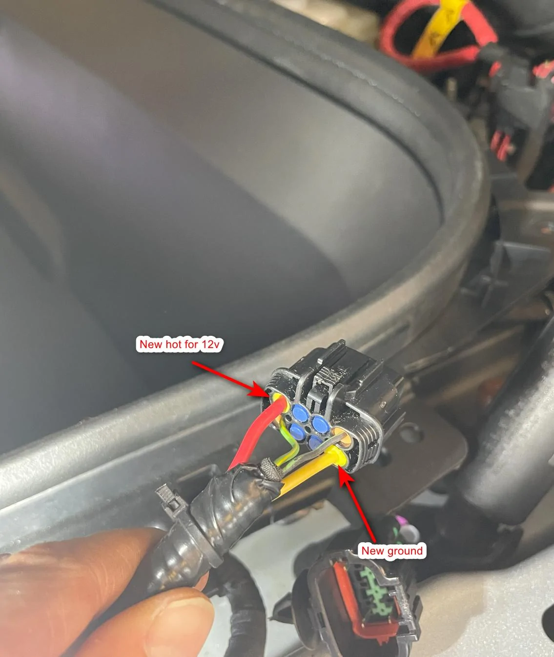

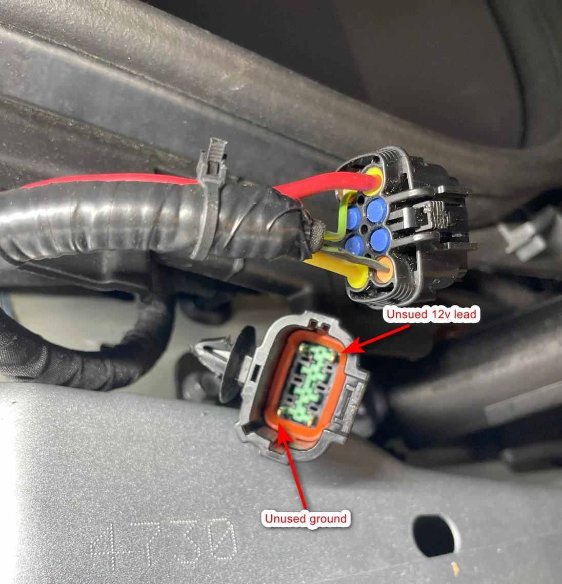

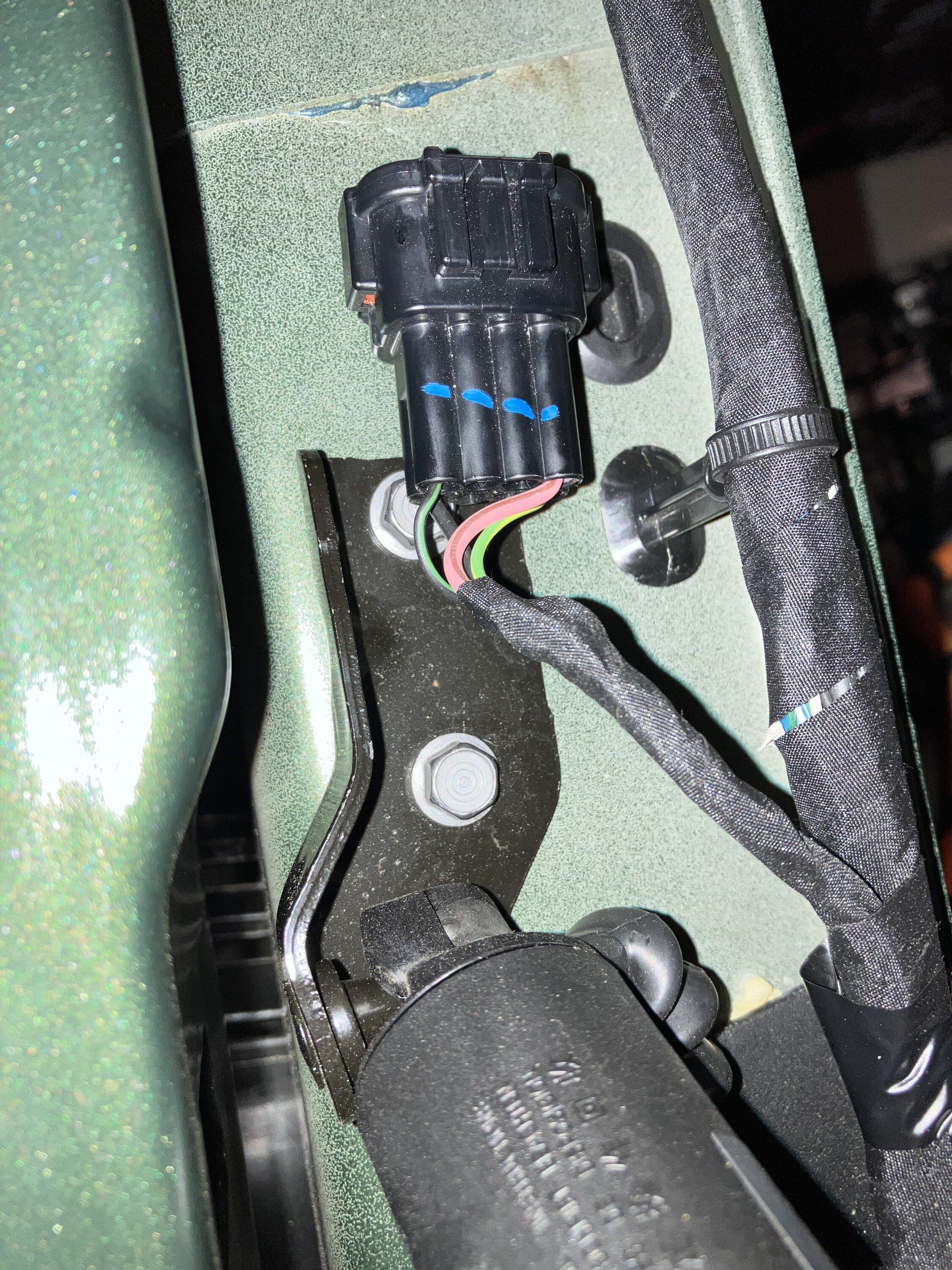

My Rivian R1T (VIN #20xxx) was delivered on 4/26/23 and there is no frunk 12v plug or wiring. I removed the frunk tub and found that the wire harness on the chassis side has 12v power wired to the left frunk plug, but on the frunk side of the connector, there are only two wires for the frunk LED.
In the photo, there are two smaller diameter green-yellow and black-green wires which power the frunk light and the other two larger diameter red and black wires were used to power the 12v power outlet.
Rivian R1T R1S Rivian updates website: Two 12v outlets now (none in frunk) for R1T IMG_0995.JPG
I was going to run cables to the battery but seeing that the chassis harness has power run to the connector, I'm going to see if I can source the mate to the connector pictured above and re-wrap the wiring harness to the frunk with power and ground wires for the 12v outlet.

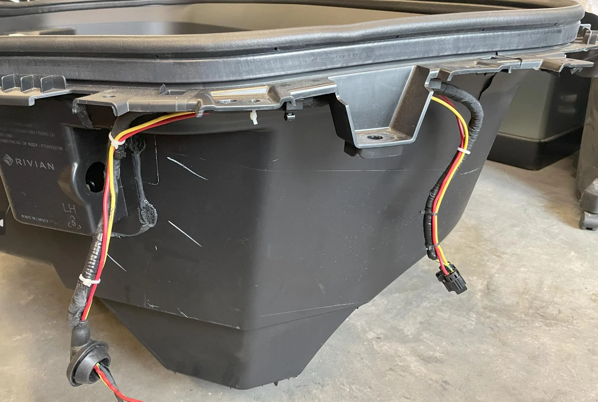

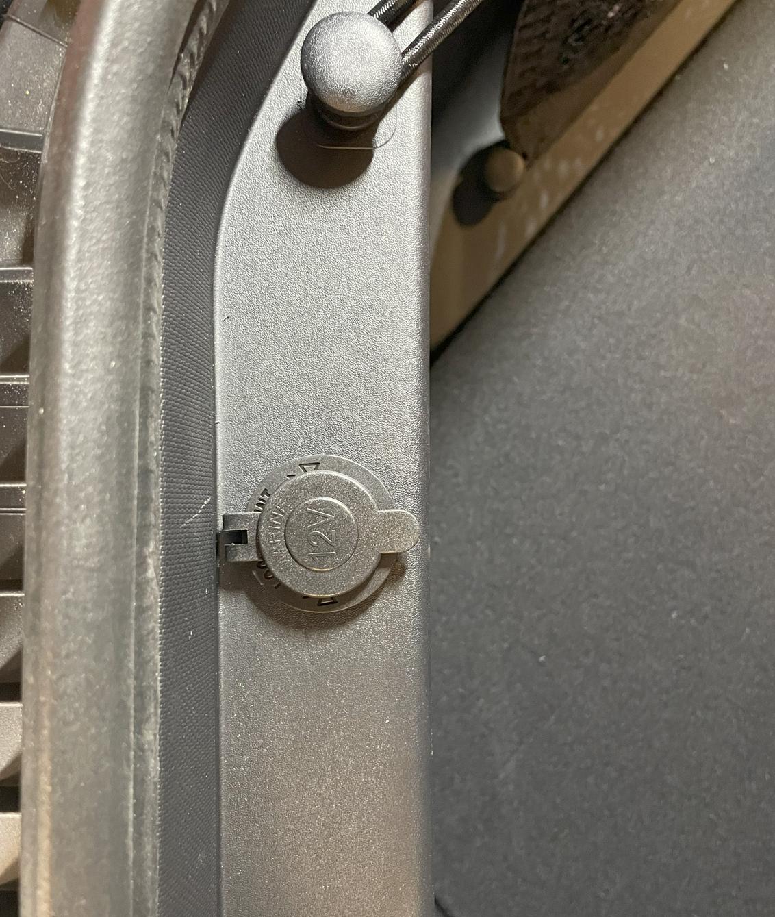

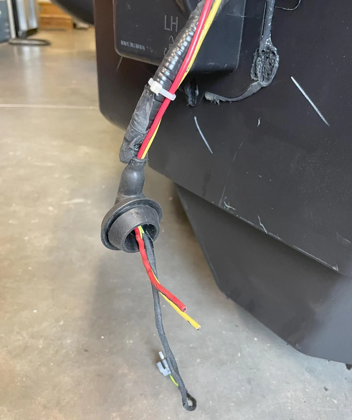

I added a 12V outlet in the frunk of my R1S. I used the existing connector (as shown above) and just added connectors and wires to the female side of the connector. Had to take the frunk out (which is really simple) to gain access to run the new wires.
Rivian R1T R1S Rivian updates website: Two 12v outlets now (none in frunk) for R1T New Wires
