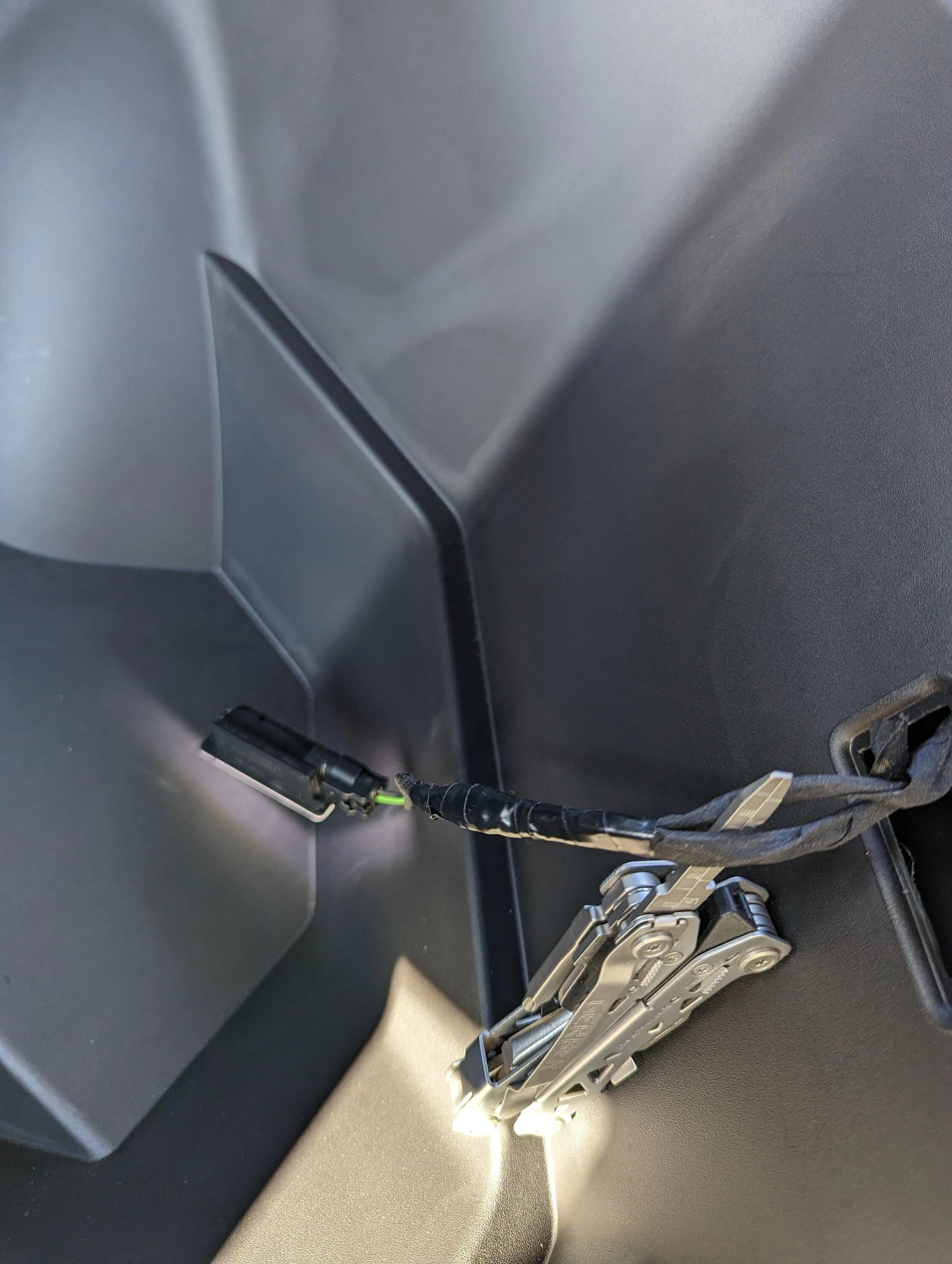

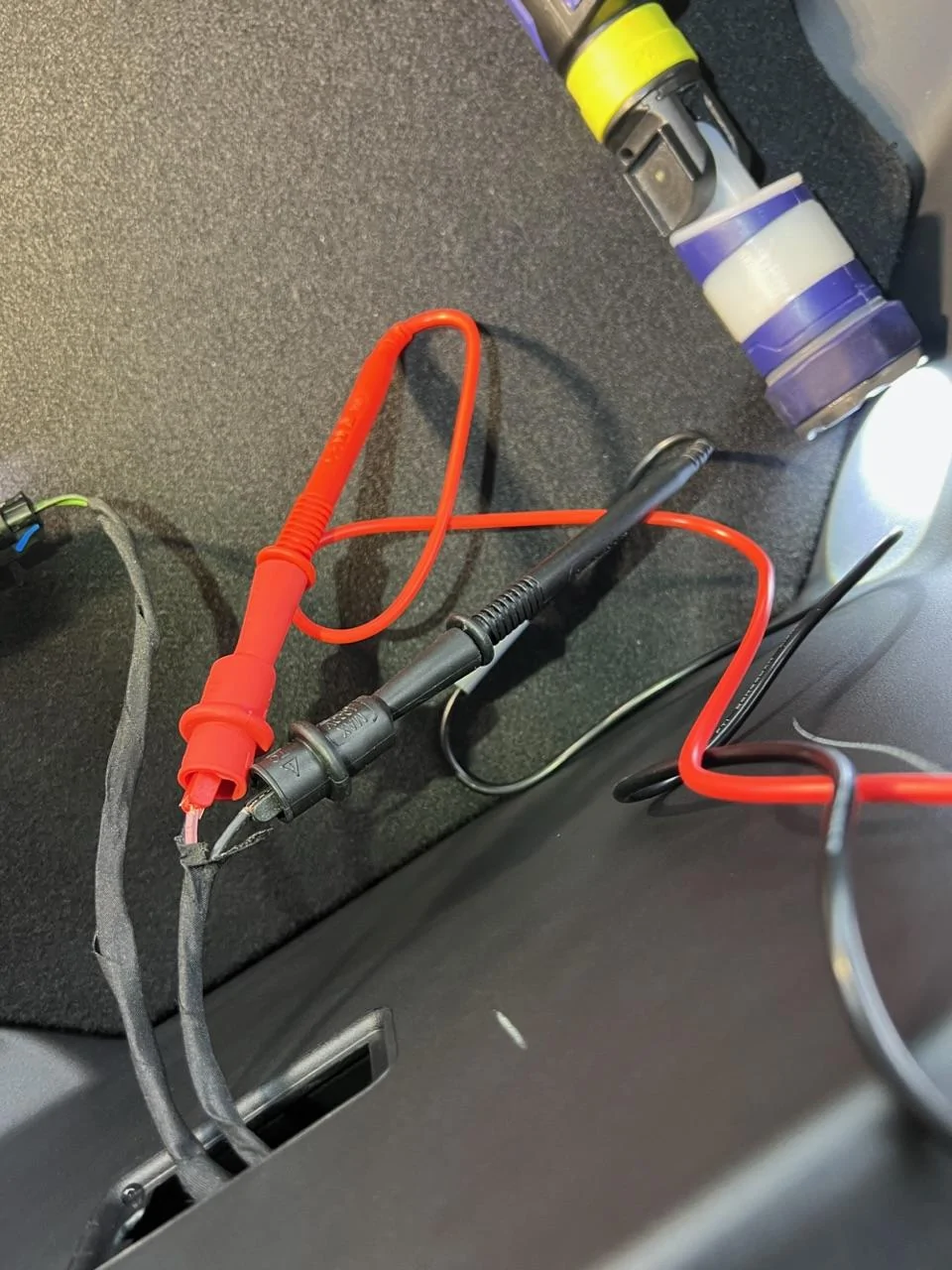

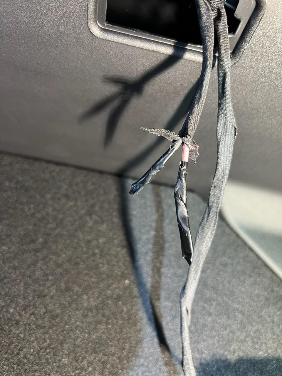

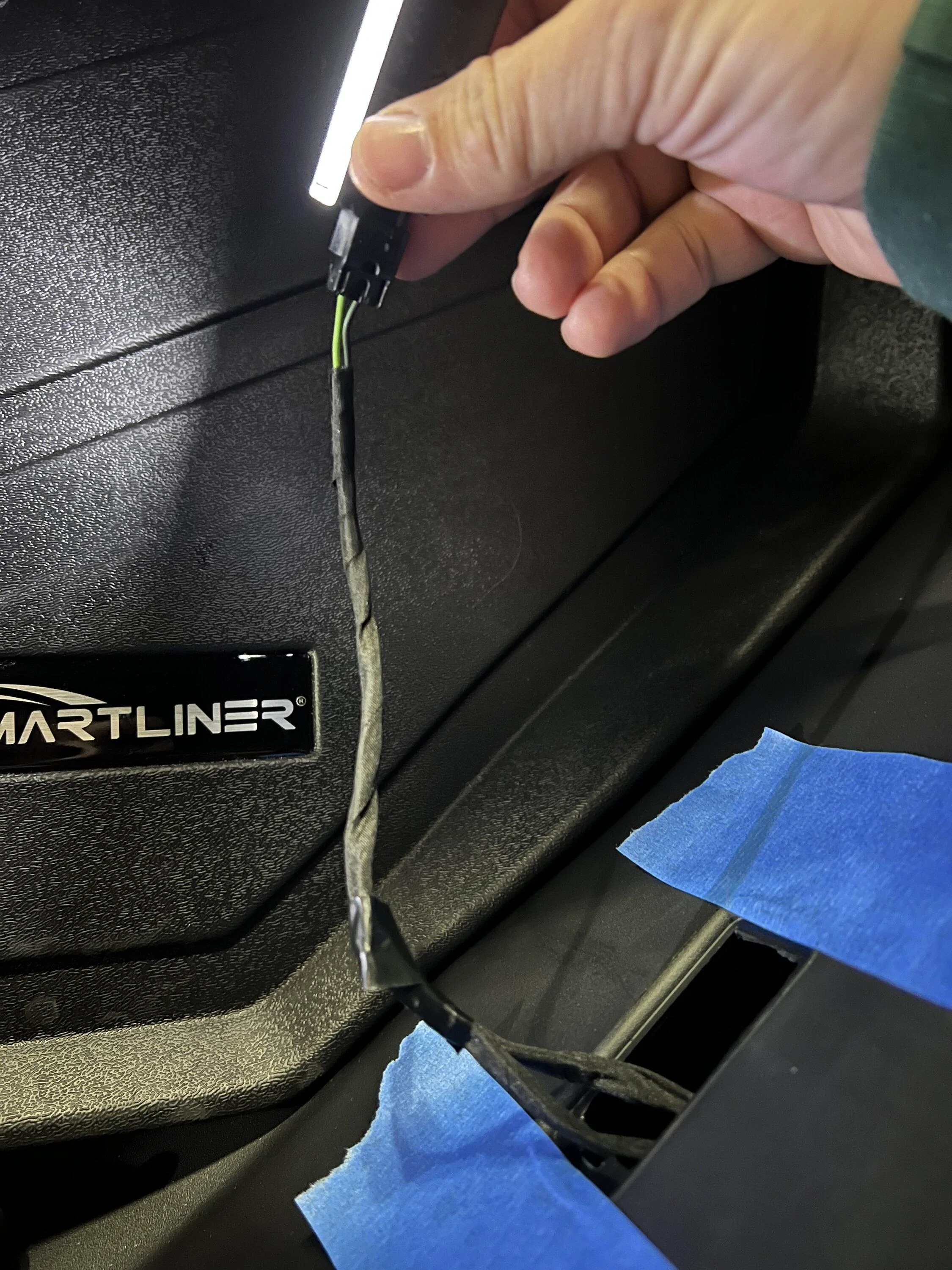

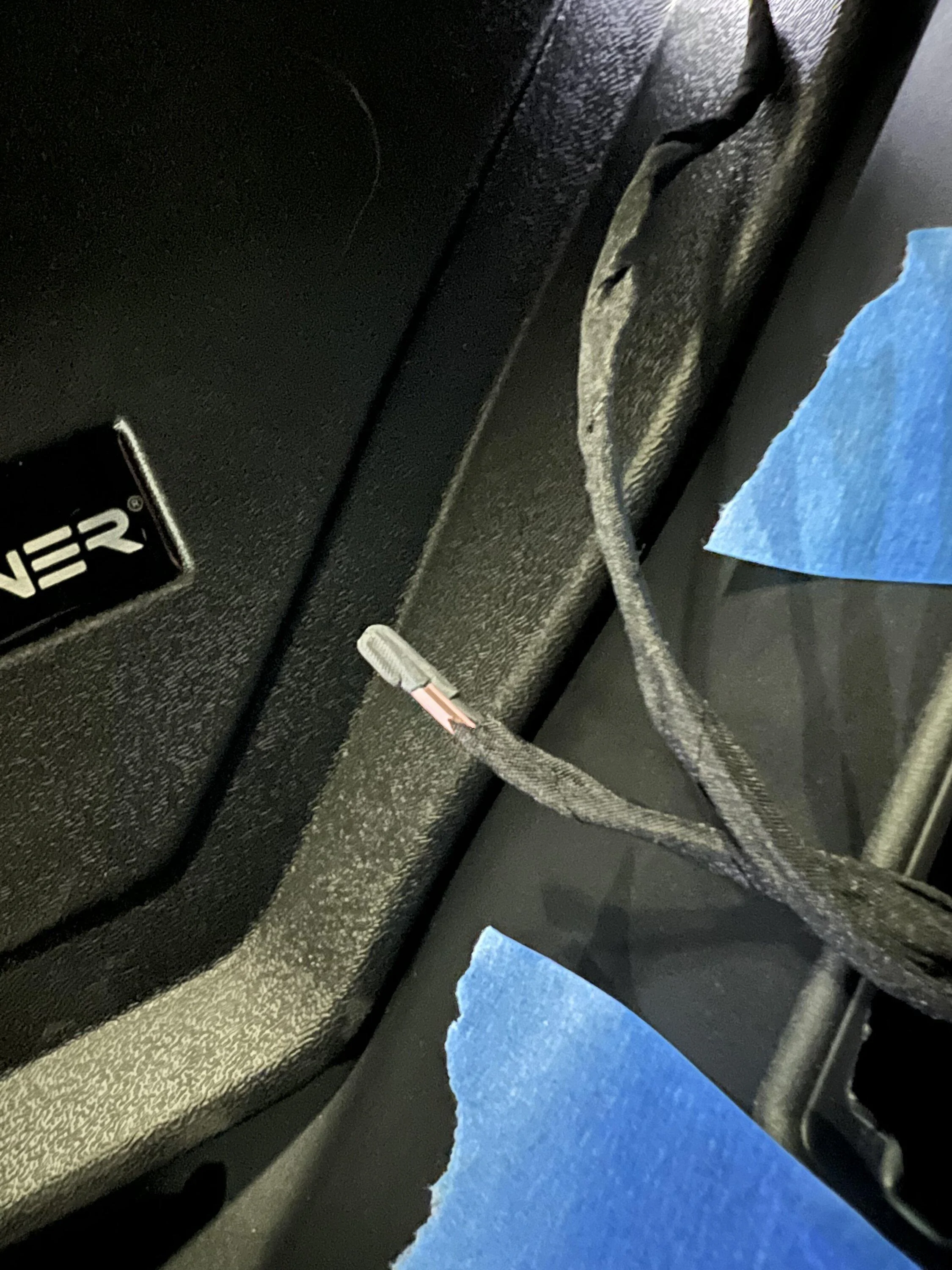

VIN 11919 and no 12V outlet. But I do have some good news... the wiring is there. It's bundled with the right LED frunk light. Looks like whatever connector they used was cut off (or yanked off, as bare copper strands were exposed) and "protected" with electrical tape. Probably the most shotty work I've seen in a brand new (modern) car :D
Anyway, here are some photos showing available wiring. This is good for us without the 12V outlet, as we can now use something like this or this, and mount as it was from the factory, or mount it on the frunk tub vertically.
PHOTOS
Seems like it would be trivial to re-add it. Won't be OEM but if you actually need to use it, that hardly matters.
Totally - it definitely won't be an OEM Rivian-like installation, but I've found a few other OEM options that use some sort of harness connector, and not typical spade connectors. I even found that that used Deutsch connectors, as a last resort.

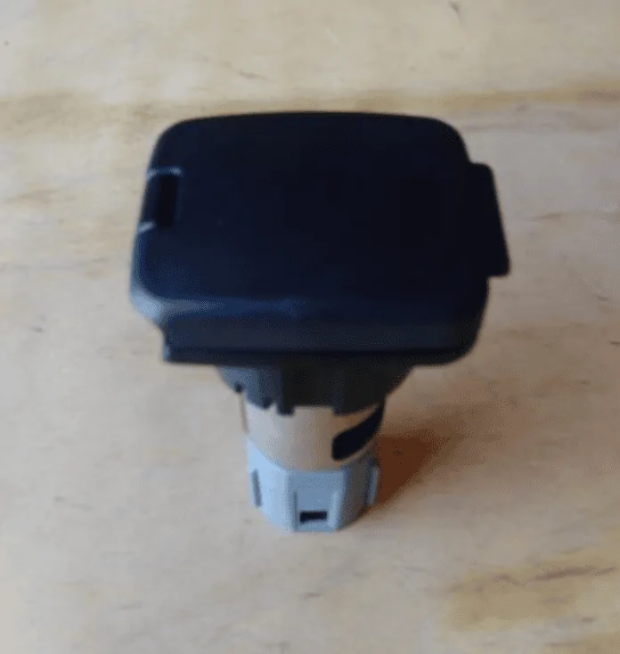

If only we could find out where Rivian sources their 12V outlets...
I found this OEM Ford outlet for $20 on eBay. Closest thing to OEM Rivian I could find.

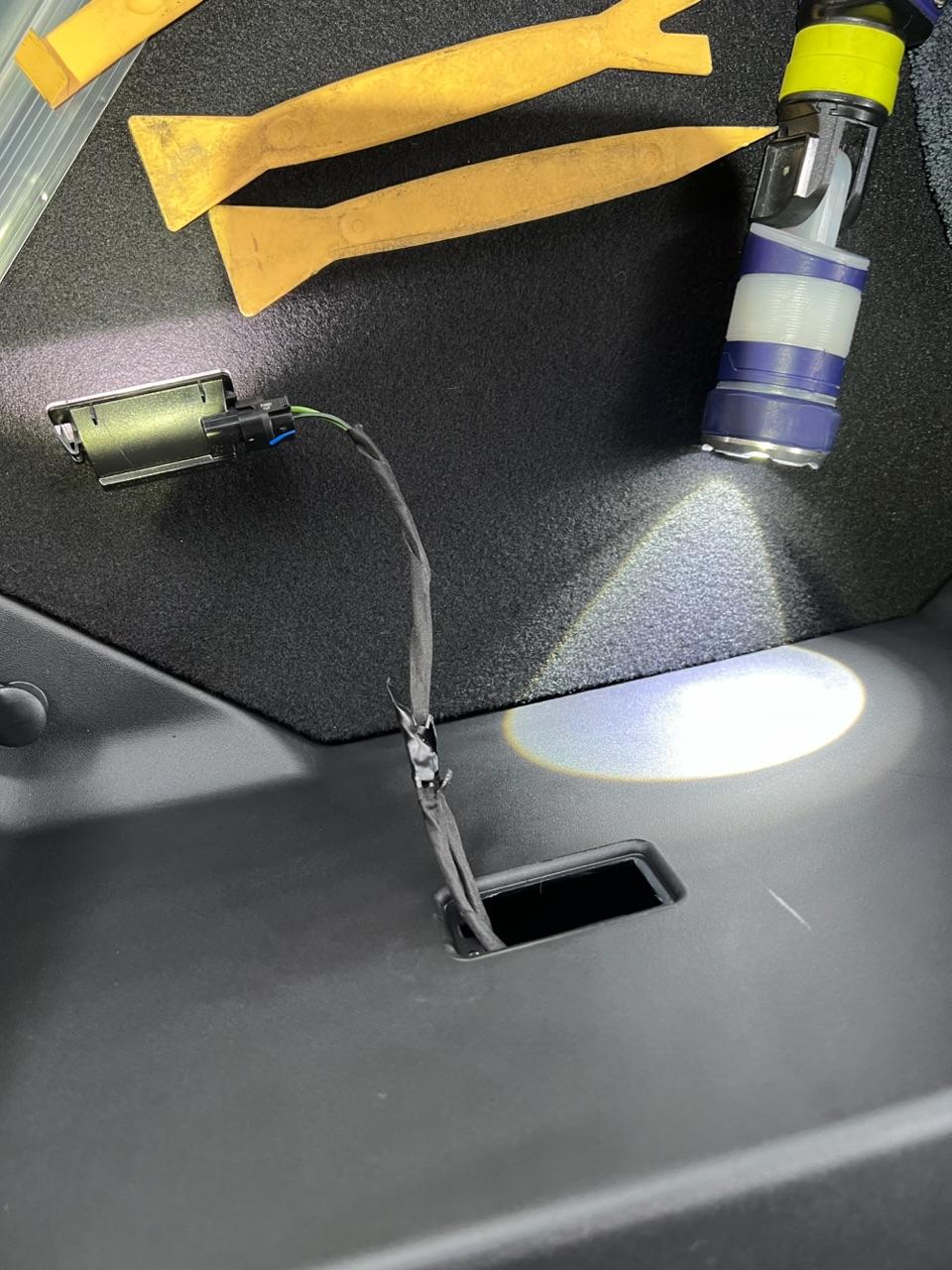

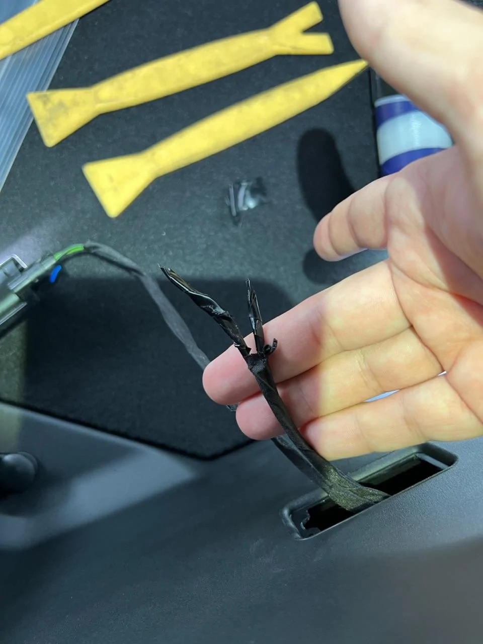

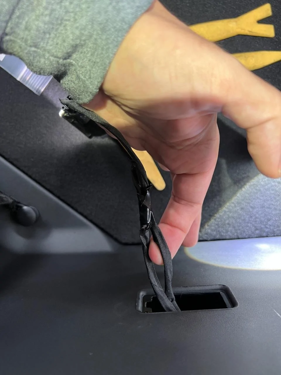

PHOTOS

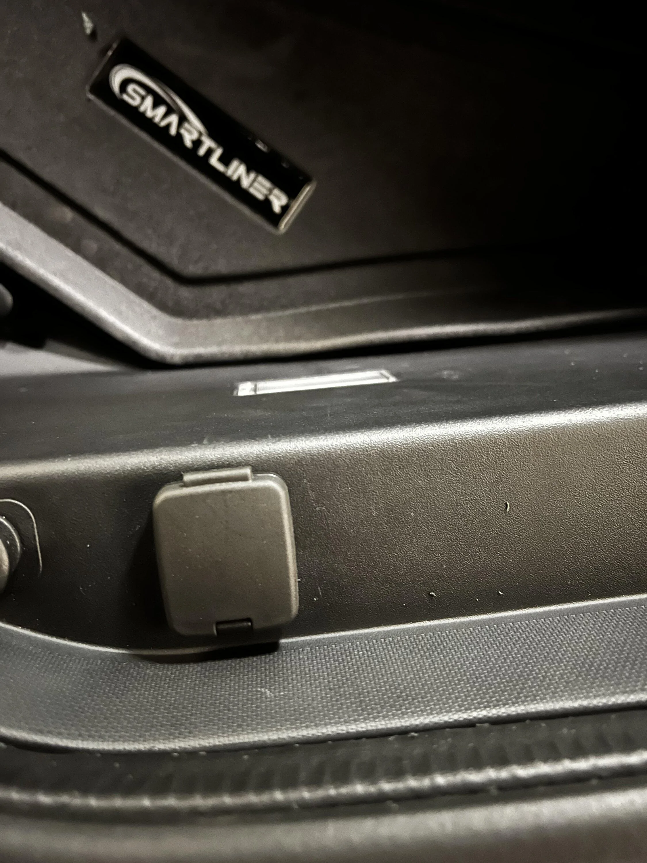

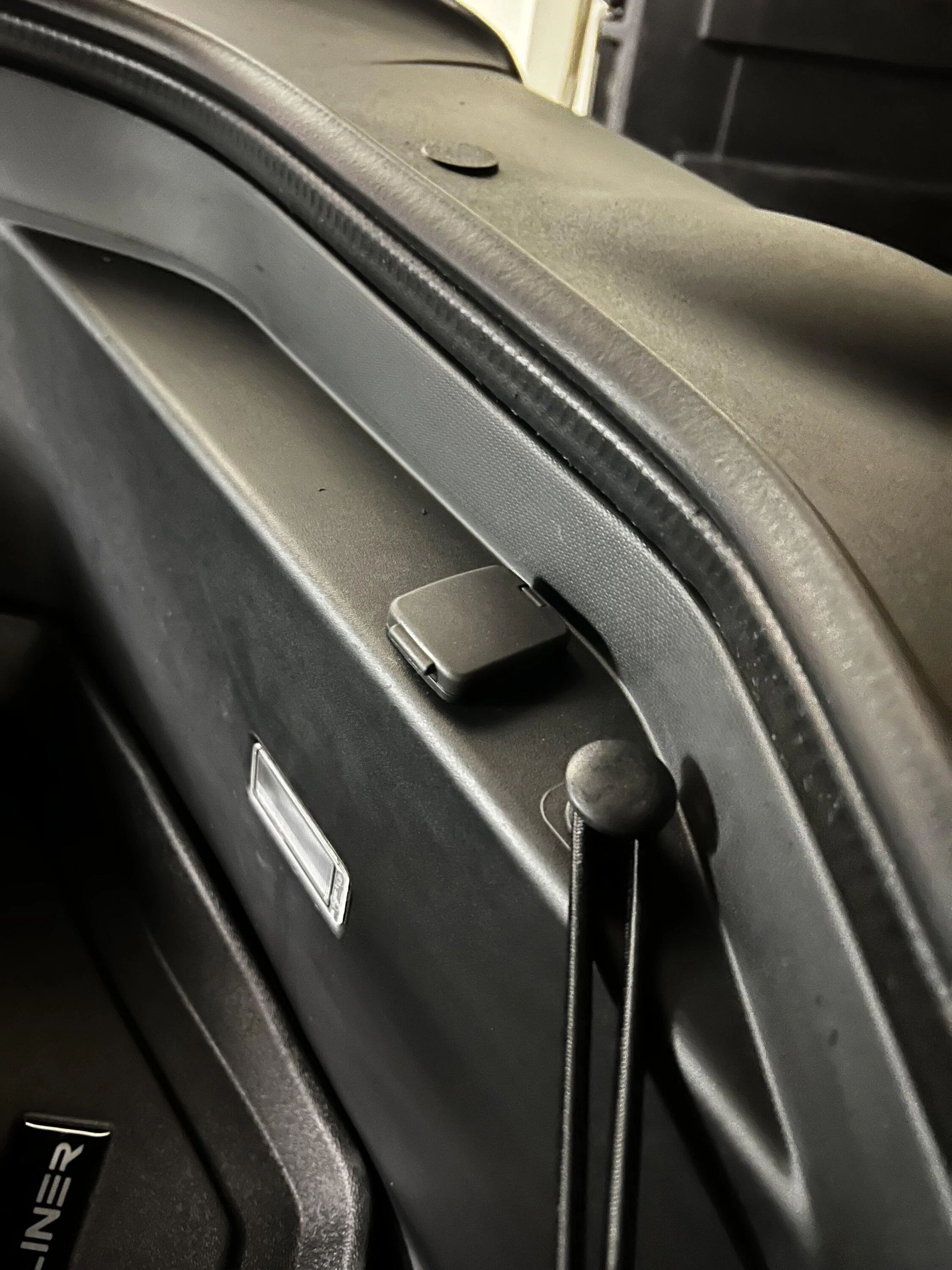

This *is* promising. Are the lights fastened in such a way that removing them would pose any difficulty? When you say 'right', do you mean driver's side (right when you're looking at the frunk) or passenger side (right if you're the truck)?
I'm pretty keen to throw this in as a small mod if mine (12xxx) has the wiring, but am slightly worried about poking holes in a truck with <200 mi on it - or worse, voiding some aspect of the warranty.
Quick edit, since the light turned out to be pretty obvious and straightforward:

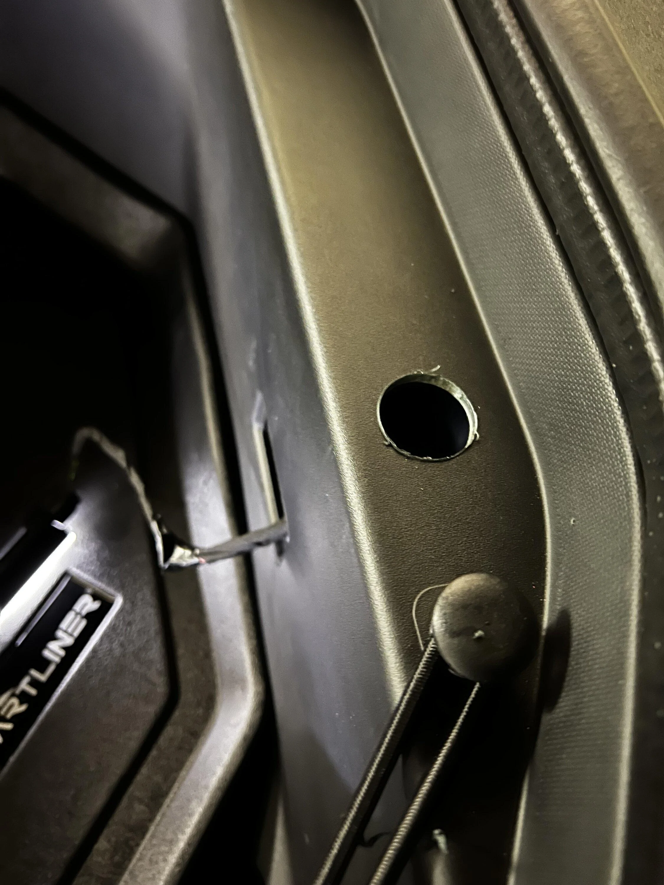

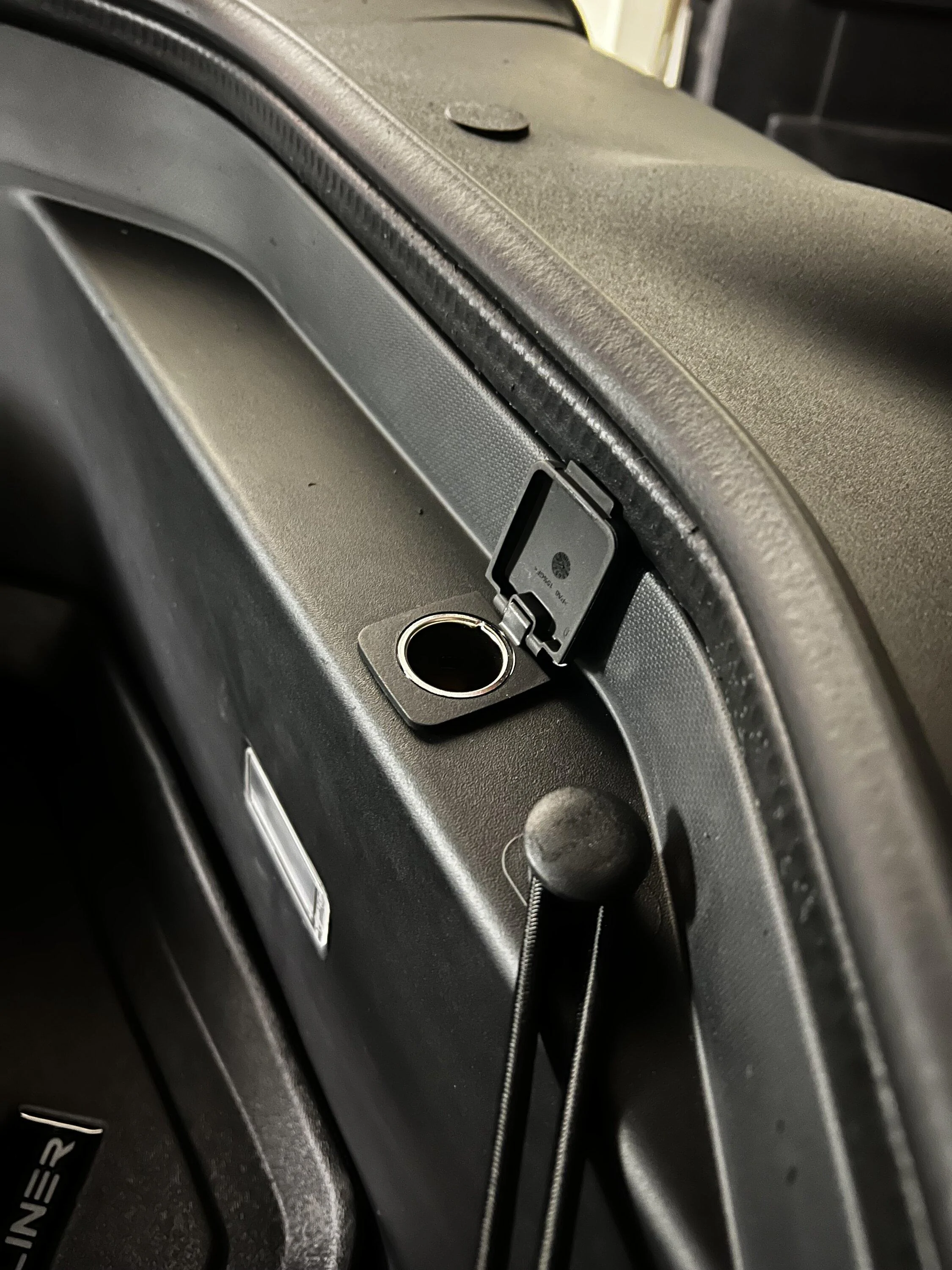

UPDATE: 12V Outlet delivered and installed.
I'm waiting to receive the OEM pigtail I ordered. It will be as close to OEM as I can make it.
BE CAREFUL where you drill your hole! Where I put mine is as close to the left when looking over it as you want to be. It's about where I could tell the Rivian one is located. There is a plastic separator below just to the left, on the inside. You will drill into it if you go too far left. Hope that makes sense... I'm not liable if you drill incorrectly...

I chose these two parts and they happen to be for 2 car brands but the pigtail looks to be an exact fit. I imagine they all use the same manufacturers for this stuff.
12V Outlet: GENUINE FORD EXPLORER CENTER CONSOLE 12V POWER OUTLET WITH BLACK TRIM (No part number)
Pigtail: 1997 - 2020 GM Center Dash Bezel Cigarette Lighter PIGTAIL WIRE - 25776667
