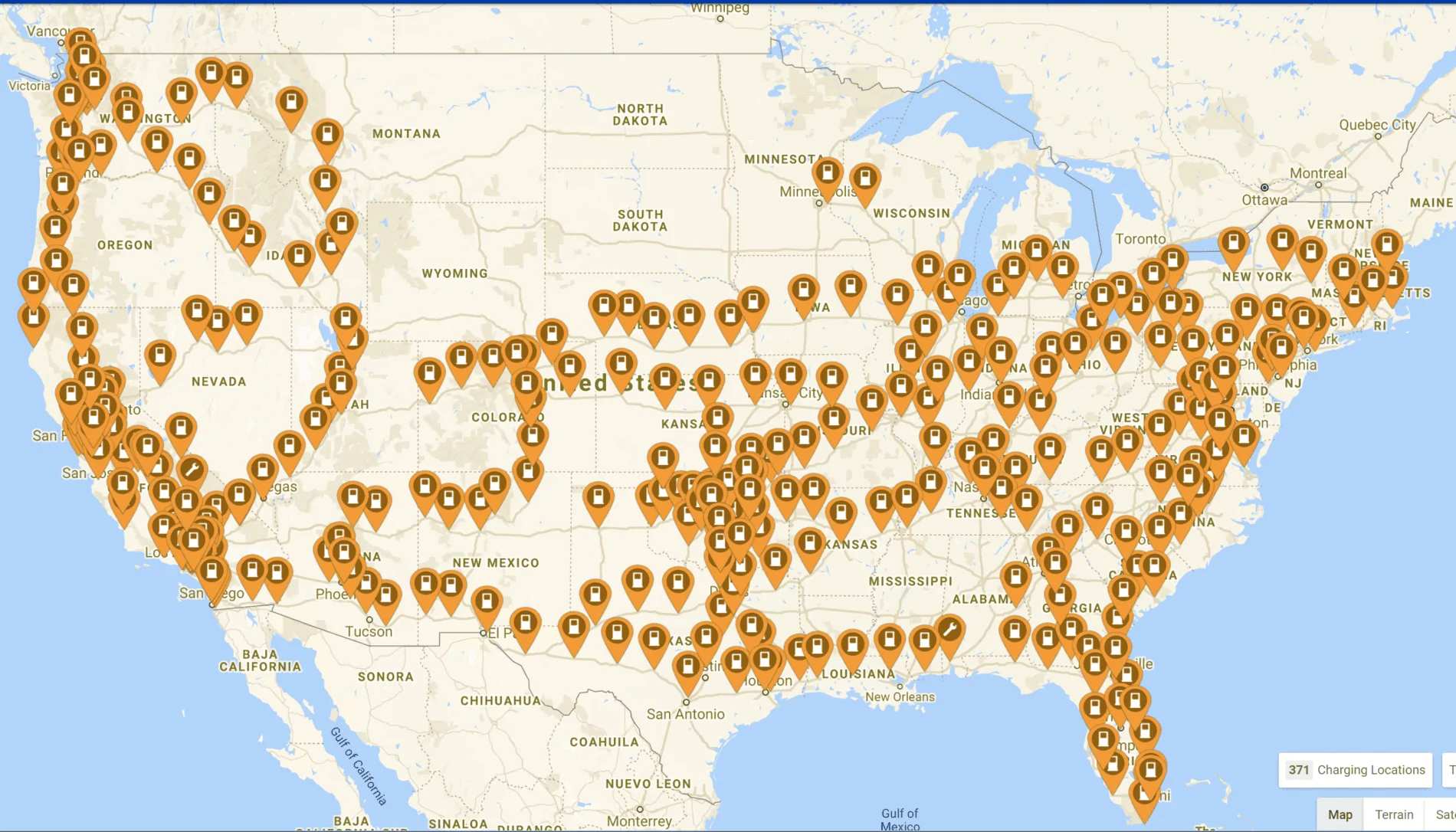

Rivian will use the CCS charging standard. Current map of 120 kW+ CCS (almost all are Electrify America locations with both 150 & 350 kW chargers). The EA network is expanding rapidly, and many more will be available by the time the R1S is shipping. Rivian has stated that they will be capable of 165 kW charging.

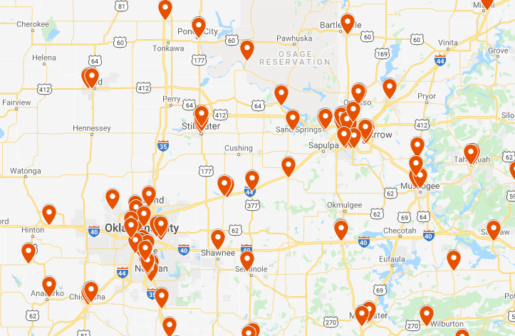

Francis Energy has built a very good network of charging stations across Oklahoma - not sure if they plan on expanding to other states.

Interesting, haven't heard of Francis Energy before but glad to learn of the option. Any idea what their current rates are?
I have their app which shows pricing - they're at $12.60/hr for both CCS1 and CHAdeMO and $1.25/hr for J1772 at stations near me. Not having ever owned an EV I have no idea if this pricing is good or bad?
That depends on the vehicle (and it's SOC, ambient temp, taper rate, battery temp, etc.) and the Francis unit.
They show 2 different DCFC units, but you only listed one price. One is 50 kW and if a vehicle was able to pull that amount (with no taper) it comes out to ~$.25/kWh which for public charging is good but not spectacular. If that is the rate for the (up to) 200 kWh unit, that is a smokin' deal and cost could be as little as $.06/kWh.
If a vehicle (like the Rivan or most Teslas) that can use the full 40A available on the J1772, it is a good deal at about $.11/kWh. If the on-board charger is 32A, the price bumps to $.17.
All of the above assume no taper and therefore not charging to 100%
As a comparison, Electrify Americas current rate for a Rivian utilzing 160 kW on the 350 kW plugs (or 150 kW on the 150 kW plugs) would be ~$36/hr if you pay the $4/mo for Pass+. Otherwise it is $1 + $53/hr. Any vehicle that reports it is capable of charging at 125 kW or above gets pricing in the highest tier. EA doesn't look at actual charge speed, only what the vehcile is capable of. Hyndai/Kia owners got miffed at EA because their vehicles report 77 kW capability putting them in the 75 kW+ tier, but actual charging speeds are less than 75 kW. EA now allows them to sign up and get a reduced rate.
