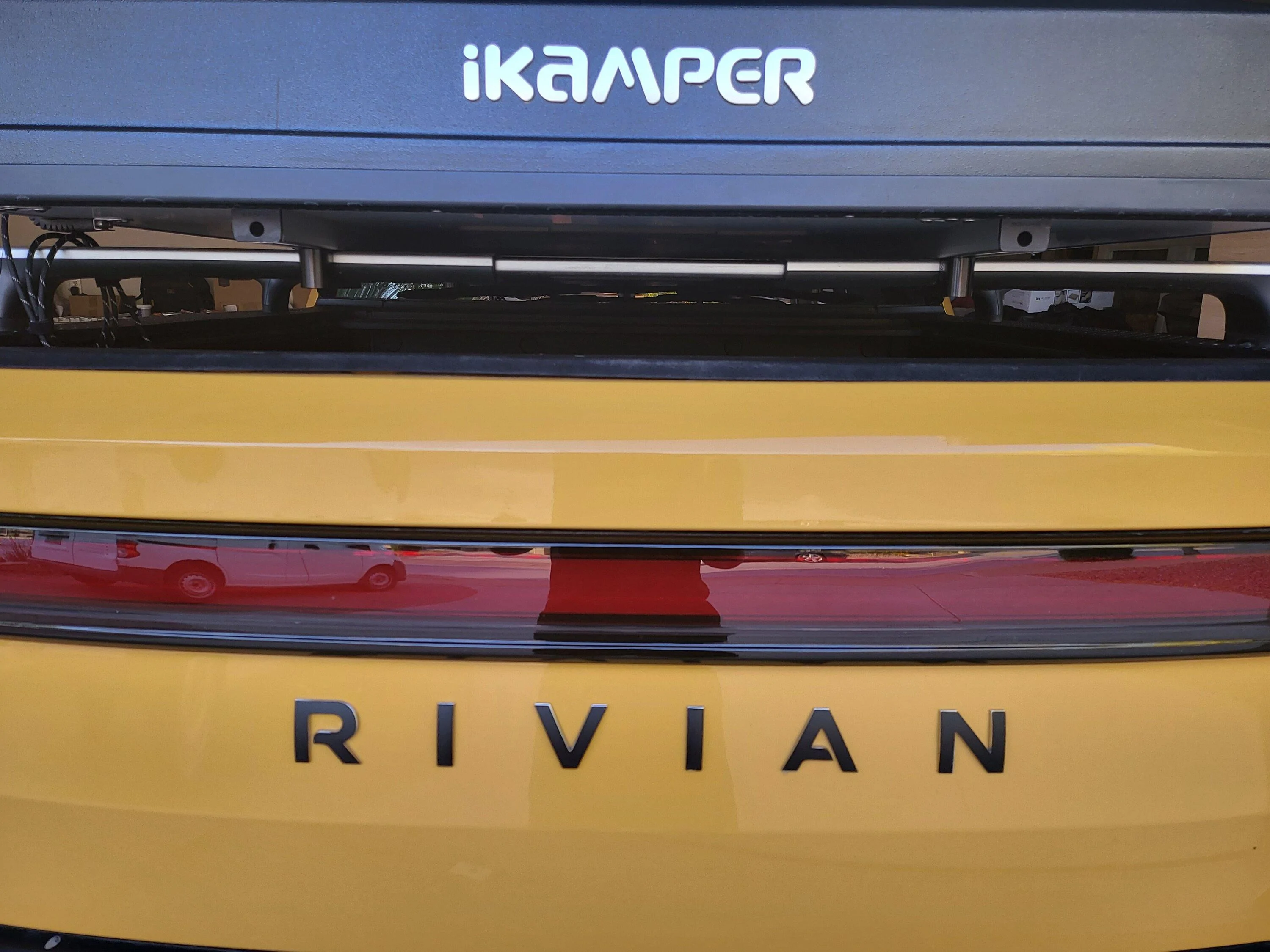

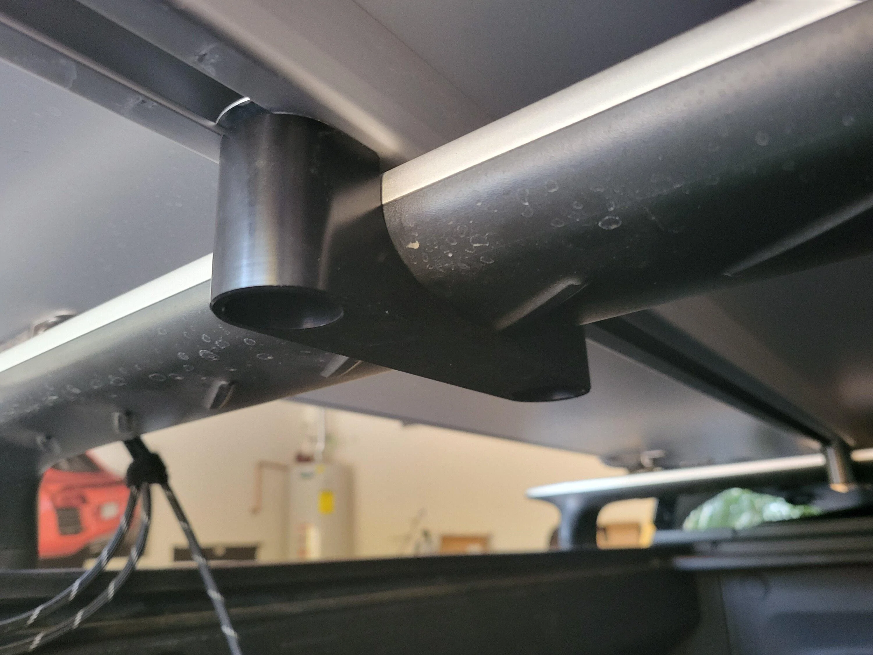

I installed the secure RTT mounts from Wheel Every Weekend. Vast improvement over the factory ikamper mounts. Solid aluminum brackets with keyed safety nuts. Great product!

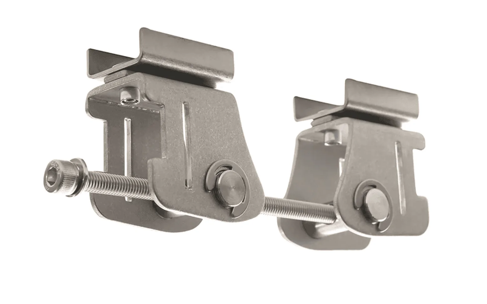

So currently my iKamper Skycamp Mini 3 is installed with the v2 clamps, which have an integrated part that goes in the tent's U-Channel.

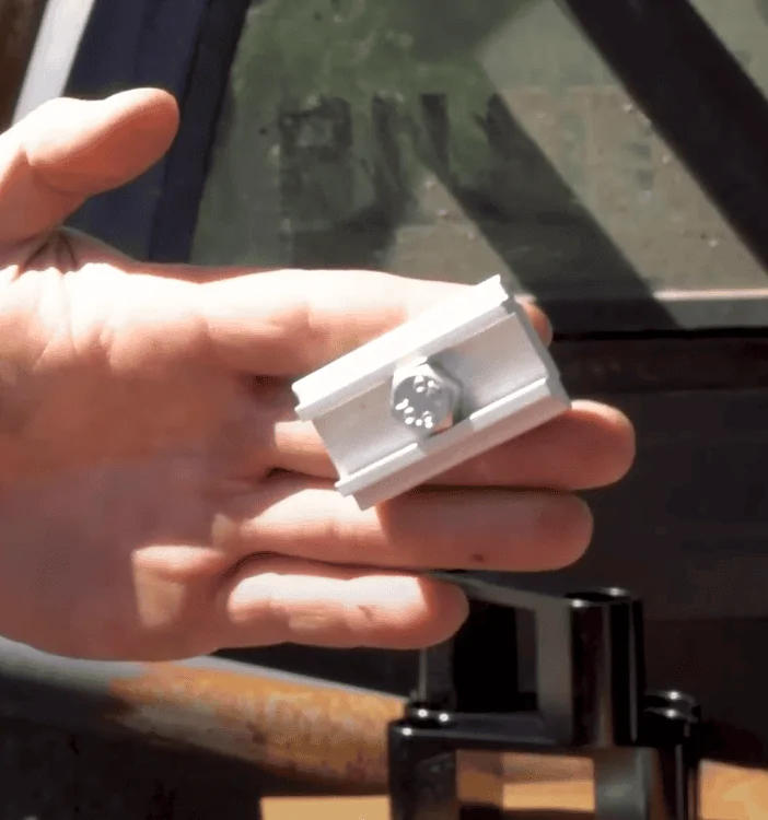

In the WEW mounts installation video, I see him placing an aluminum piece on the bolt, is that included with the brackets (can't imagine, as that seems RTT specific), as from your pictures it looks like you just used a washer? If you used a washer, how do you keep the bolt head from spinning??

They recommend that you purchase the Ikamper v1 mounts and use the included bolts. I bought some 35mm bolts, fender washers and nord lock washers. Two fender washers seemed sufficient to me. Then I wedged a flat head screwdriver along side the bolt head. Might be easier with two people but I did it myself.
There was some trial and error. I didn't want to buy the Ikamper mounts. I also used the loctite.

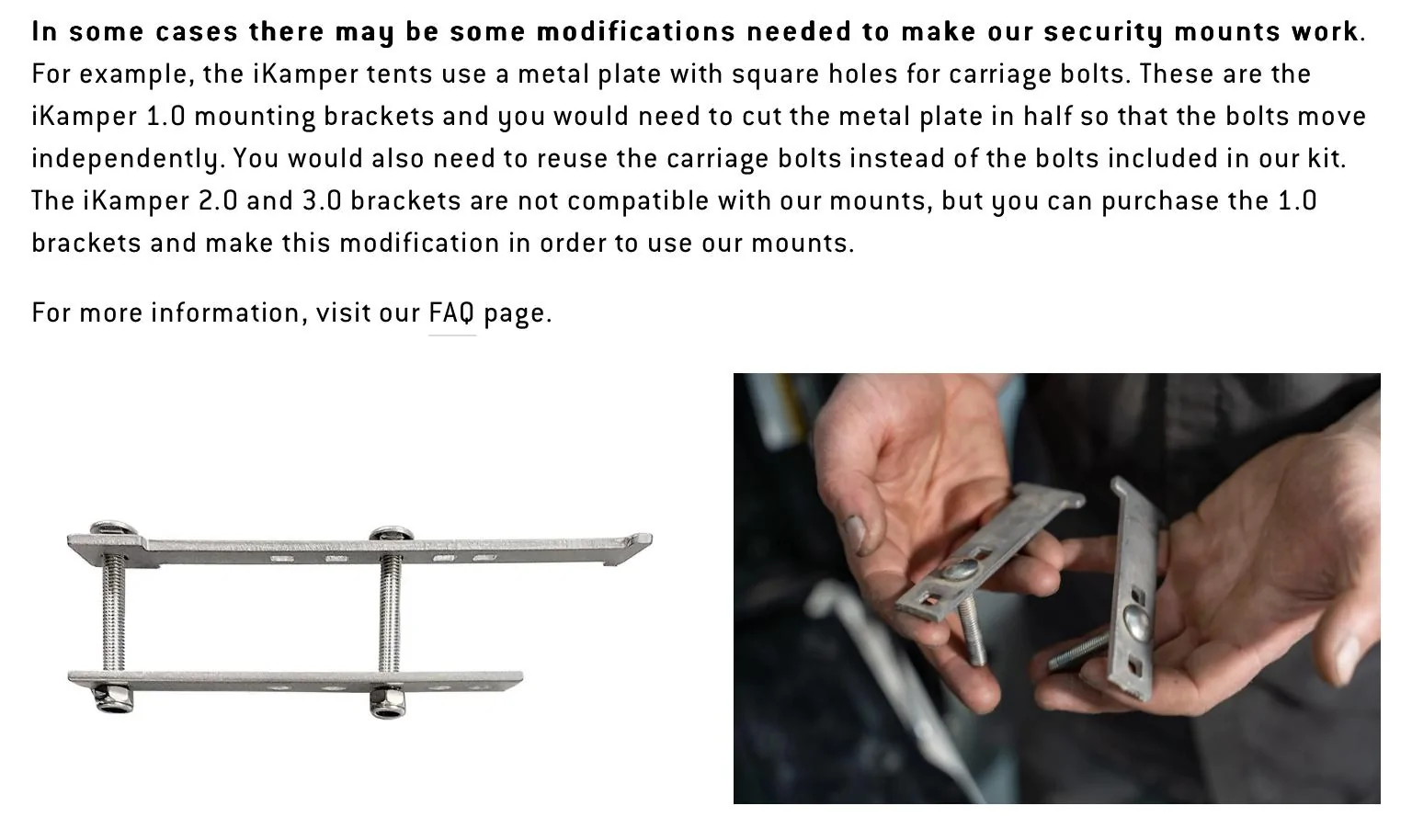

I have the v1 mounting kit and it doesn't line up. Upside: I didn't pay for it, it came used along with the v2 mounts when I got the tent used.
Instead, I got these bolts from Ironman, and while pricy for what they are, they work perfectly. Good mountain hardware is worth it to me, especially when the v1 mounting hardware had me needing to bend the bolts a bit.
Yeah, the instructions aren’t super clear but you’re supposed to cut the v1 bars in half so you’re using them and the bolts but with the spacing needed for the Rivian bars and WEW mount.
Rivian R1T R1S RTT mounts from Wheel Every Weekend IMG_1018
https://www.wheeleveryweekend.com/blogs/tech/how-to-measure-and-install-rooftop-tent-security-mounts
