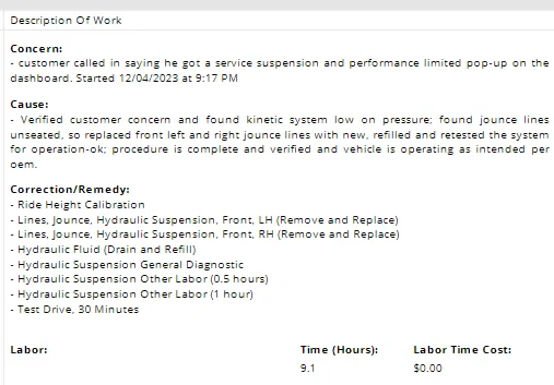

After seeing all the poor service experiences, I thought posting a good one, might help.
On Sunday night my R1S suspension went out, and performance was limited. After getting the vehicle back home, I hopped on the phone w/ Rivian support. We ran though the standard turn it off and back on again procedures, which did not help. I let it sleep overnight.
The next morning I called back in to get service scheduled. I was given an appointment on Wednesday, but could drop it off the same day. I was given a rental and uber to Enterprise. Getting the SUV to the service center was an adventure, being limited to low speeds I had to take mostly back roads.
Upon arriving, I was greeted by name and given a preliminary schedule of when the vehicle would be ready (end of the week).
Later that day, Rivian called to let me know the jounce lines on the driver side unseated themselves and were leaking. They planned to replace both front sets once parts arrived.
On Tuesday, I was able to pick up my vehicle.
