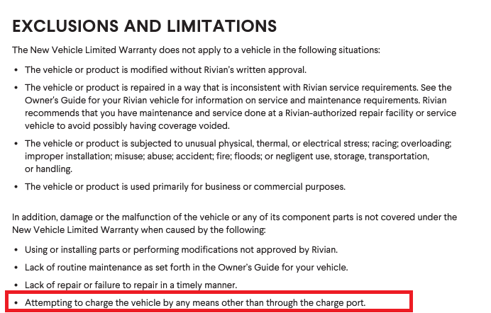

Rivian gets name dropped in this system under development that will add 10-20 miles of range a day from a solar tonneau and integrated battery pack.
https://www.motortrend.com/news/worksport-terravis-solar-tonneau-cover-truck-bed-power-system/
The elephant in the room is this line in the Rivian warranty. Being forced to use the charge port means you're taking at least 20-25% off the amount of energy recovered and can only be done while the vehicle is stationary. (I actually did a test a few weeks ago, if you plug a charger in while the vehicle is in drive it goes to emergency park.) I wouldn't pay for a commercial system that could charge under this exclusion unless they made a legally enforceable guarantee that they would cover all costs related to a malfunction.
Rivian R1T R1S Solar charging kit in the works for Rivian 1685459028432
