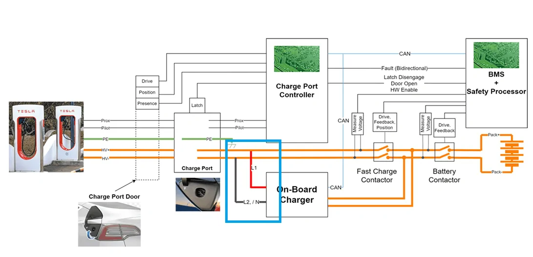

This is exactly why I prefer the CCS method. I don't like the way Tesla exposes the OBC to the external HVDC. I think it's bad engineering.

https://tesla-cdn.thron.com/deliver...-Charging-Standard-AC-DC-Pin-Sharing-Appendix
Blue square is mine. This is the Tesla port. Tesla uses the same ones for DC as they do for AC.
With the CCS port, these are separate pins on the connector for AC.
OBC is On-Board Charger.
To rephrase what I think I saw Tesla noted on this is that, one of the potential problems it raises is that the On-board charger needs to be able to handle the DCFC voltage as an input, right? It also potentially increases the cost of a car.
Withstand voltage. It's basically just passively blocking the input from the internal components of the charger. I'm not sure of the exact implementation involved, but it also means the wiring to the charger and such needs to be electrically insulated for 1kV instead of what would typically be much less. Cost of the connector being less than CCS is probably intentionally confounding the overall cost of the entire charging system.
