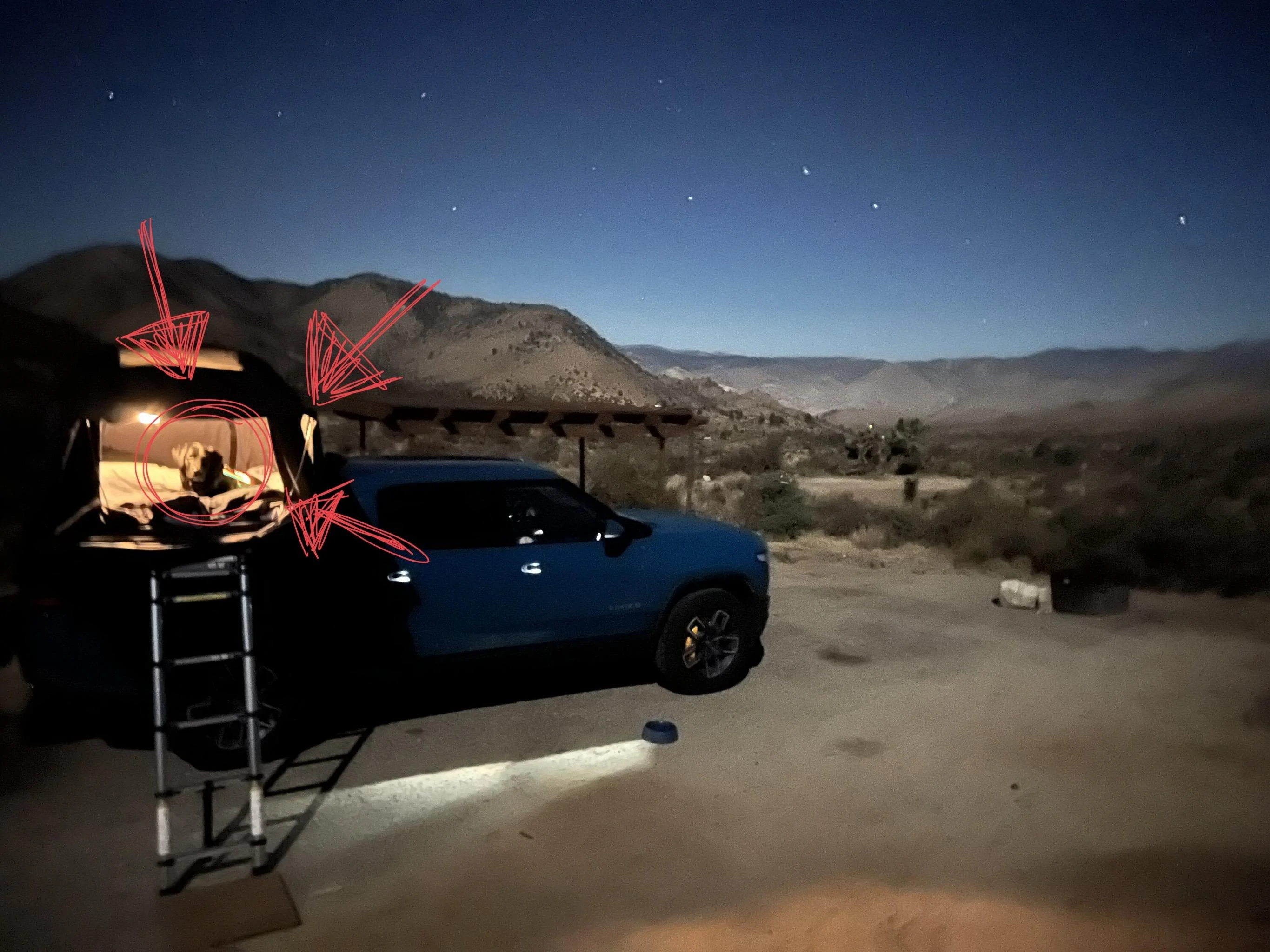

The setup. I was in the Sierra Nevada mountains. I was in San Diego earlier and went through Barstow and Inyokern to charge at the RAN stations. Went up into the mountains to camp.
Arrived around 7:00pm temp was around 32F at this time. I had 49% SOC or 135 miles
Dipped down to the low 20s overnight. Outlets on, camp mode ’always on’ on, running my Icego cooler/fridge and a standard electric blanket to keep warm in the tent.
After 12 hours I used about 1.5% SOC down to 47% or 131 miles.
Quite happy with those results, next to try using my 400W space heater and colder temps.

You forgot to mention you also had a 4 legged heater in your tent!

To follow up. On my last night on my way back to Oregon I stopped to camp east of Eureka. So as promised I used my space heater instead of the electric blanket. It wasn’t quite as cold, low around 32F.
Bottom line is I used about 5% SOC in 12 hours. Probably could be less if my tent was better insulated.
