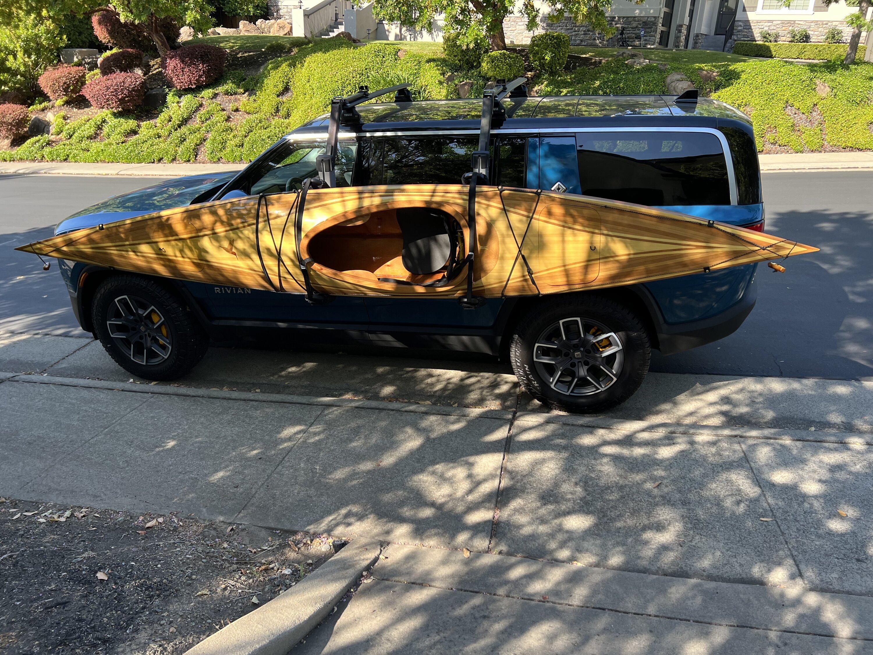

I did use the 60" wing bars. The tech. suggested 53", but the distance between the mounting points on the roof is 48" and I wanted an even overhang on both sides - with the option to install a second hullavator on the other side if needed in the future. So the 60" works perfectly.
No issues with clearance to the side of the vehicle or the mirrors. See the picture below. The forward kayak mount is well back from the side mirror, and the Kayak has plenty of clearance to the mirrors (folded in the picture below). In fact I moved the hullavator further in-board after this picture was taken. I have not driven much since the rack was mounted, and not at all with the Kayak loaded - so no range data to share. I plan to remove the hullavator and perhaps even the crossbars on long road trips if I'm not carrying either the Kayak or the roof box. It takes about 10 minutes to get everything off.

Damn! Wish I knew about this before I bought the Rivan Rack. I'm getting too old to pitch Kayaks up on the roof of my R1T.
Nice boat, is that one of Eric Shade's designs? Shearwater hybrid?
The Hullavator is working out ok for you?
karv
karv
Mar 22, 2022
Folsom, CA
Subaru Outback, Sienna
Yeah, tell me about it. I jumped the gun and ordered the rivian rack as well (before deciding to get the Thule), now gathering dust without a single use.
You got it right - it’s a Shearwater sport Hybrid that I built from a CLC kit a couple of years ago. The Hullavator is working out great. I’ve taken the kayak out a lot more frequently- now that it’s so easy to transport.

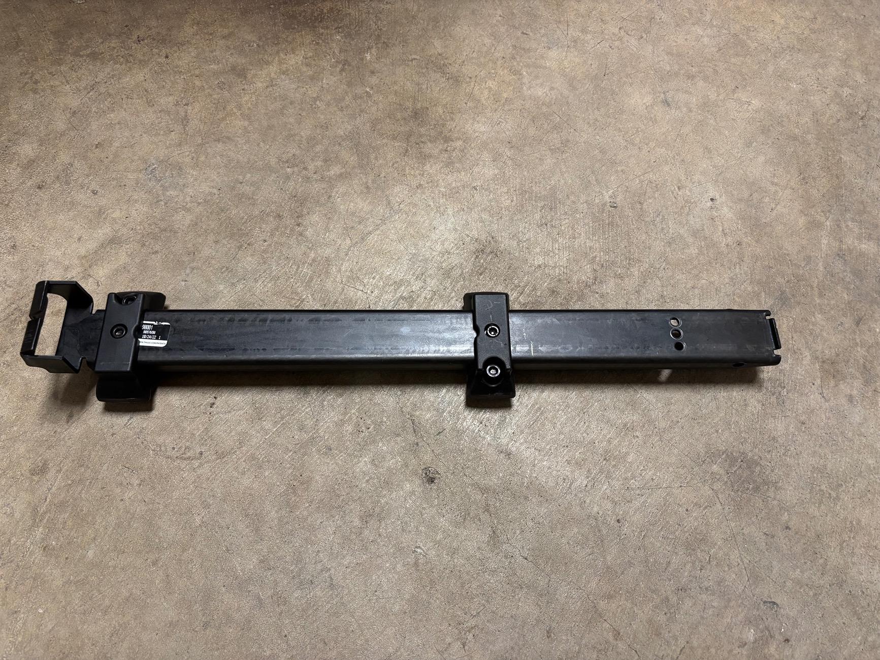

Thanks for this post. Last year, I setup exactly like this using the Thule bar and adapters. But I've had my roof glass break twice with it mounted beginning at the edge near two of the different mount points. Has anyone else experienced this?
I don't trust the Thule adapters and instead paid someone to modify the hullavator brackets to work with the Rivian racks. I think there's enough leverage still for the mechanical forces raising and lowering the kayaks and I have the same clearance as with the full length Thule bars.
