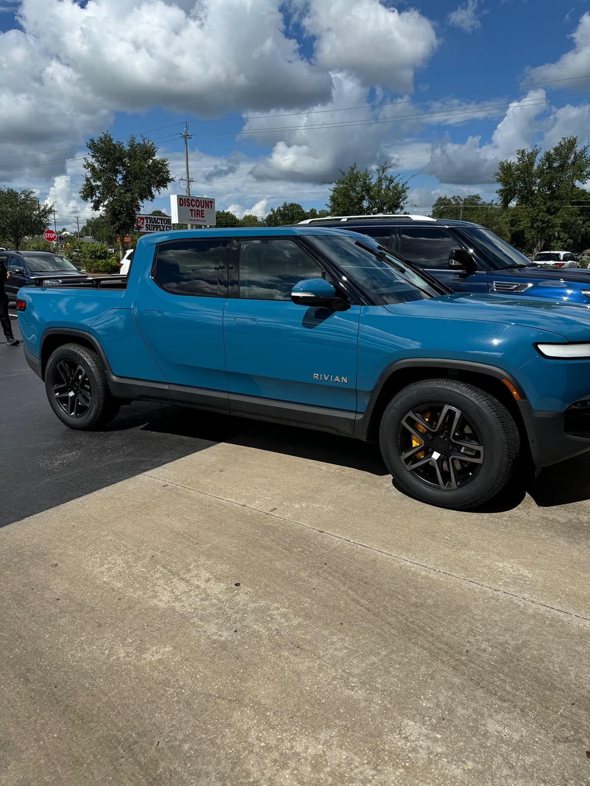

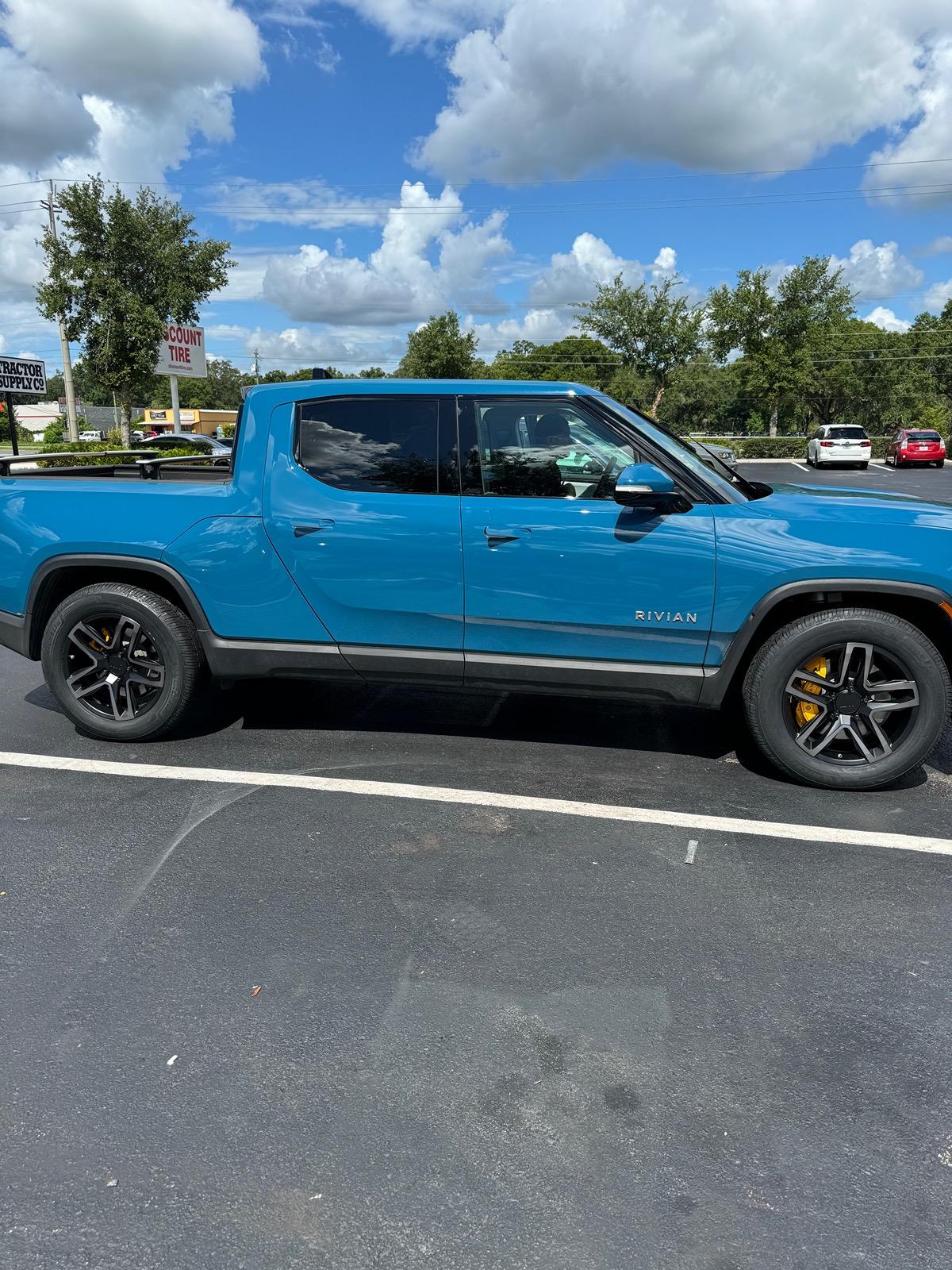

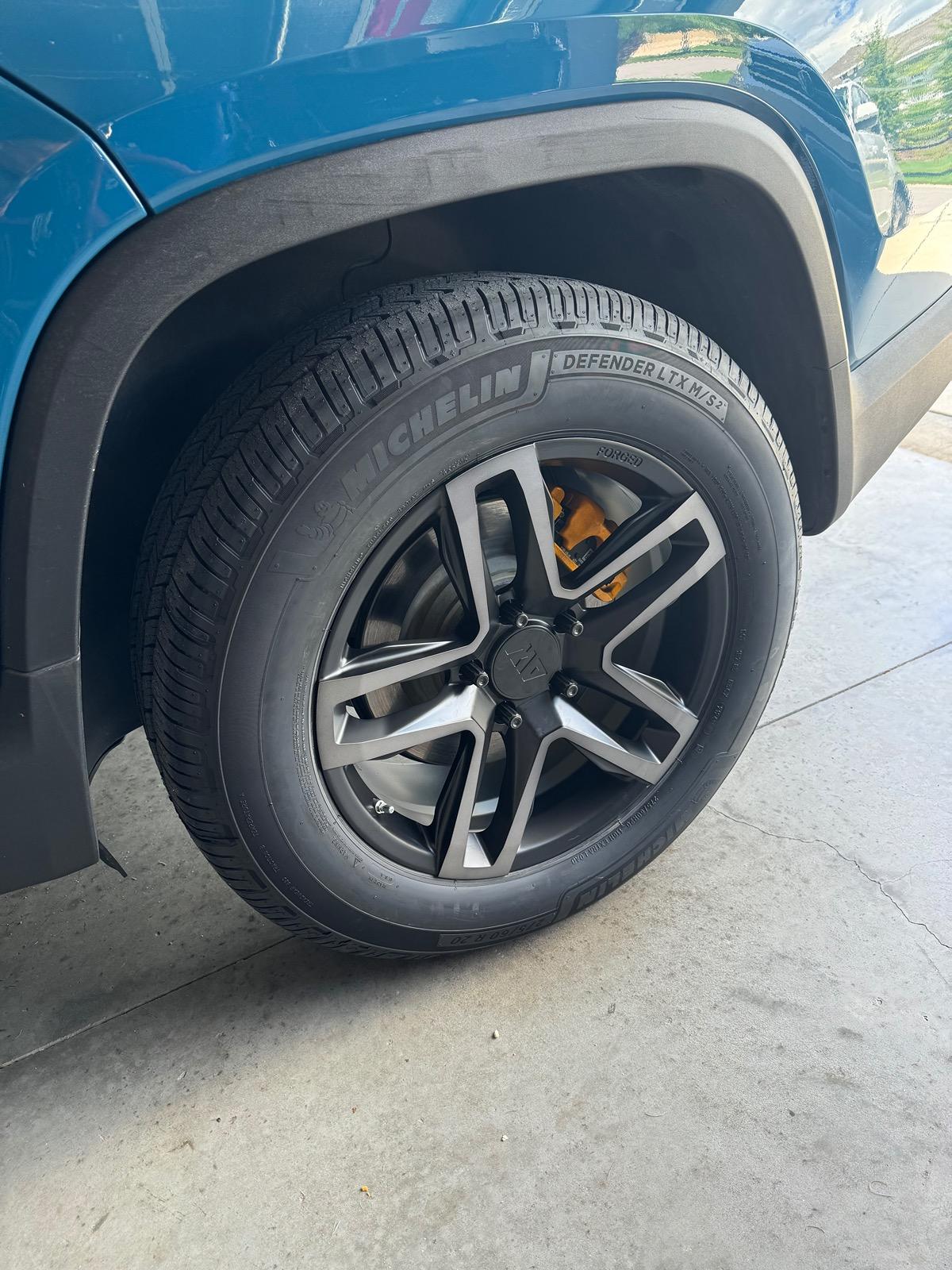

Pics please 😎

As requested……..
Rivian R1T R1S Tire pressure question for the experts IMG_2239
Rivian R1T R1S Tire pressure question for the experts IMG_2238
Rivian R1T R1S Tire pressure question for the experts IMG_2242

Those look nice! I think the Defender is the best tire to get for handling/efficiency/treadwear, please report back once you have some data, here's detail on tire pressure, load, and the tread diameter in contact with the ground (contact patch) - 48 PSI is to maximize efficiency by minimizing the contact patch diameter:
