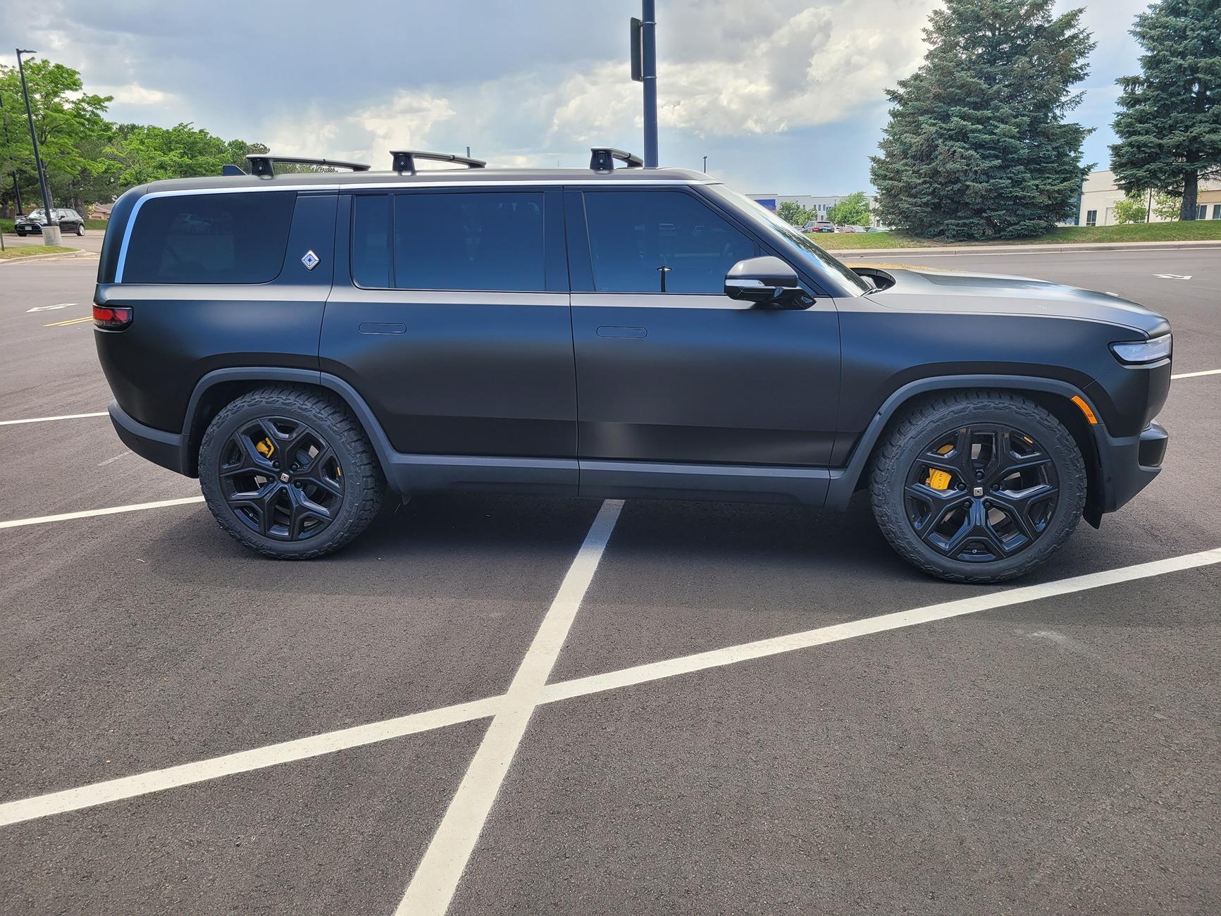

Colorado driver on the SL 275/65’s - about 1300 miles on them in town and in the mountains. Efficiency is about the same if not a little better?
Comfort, handling and noise in all conditions are immensely better than the OEMs ever were. Snow traction is greatly improved as well - so much so that fresh 2-4” I don’t even flip on snow mode if it’s powdery. Slides are predictable - and have a LOT more lateral grip than the Pirellis. Very happy to make the switch.

At 2000 miles, swapped out the stock Pirelli's. Perfectly good - just NOT my tire of choice. Now 15 months and 32,000 miles later, mostly Highways or in town, running strong at 2.18 miles/kWh... These are not the newer 3 Mountain Peaks but they have been great in the Colorado weather between Glenwood Springs and Denver. Much quieter that the stock, good ride and grip the road. Light off roading without a worry. Later this summer or before the next snow season, I will upgrade to the newer Toyo Open Country with the 3 Peak Mountain Snowflake rating. I am wearing the 275/50R22's on the Dark Sport Wheels.
