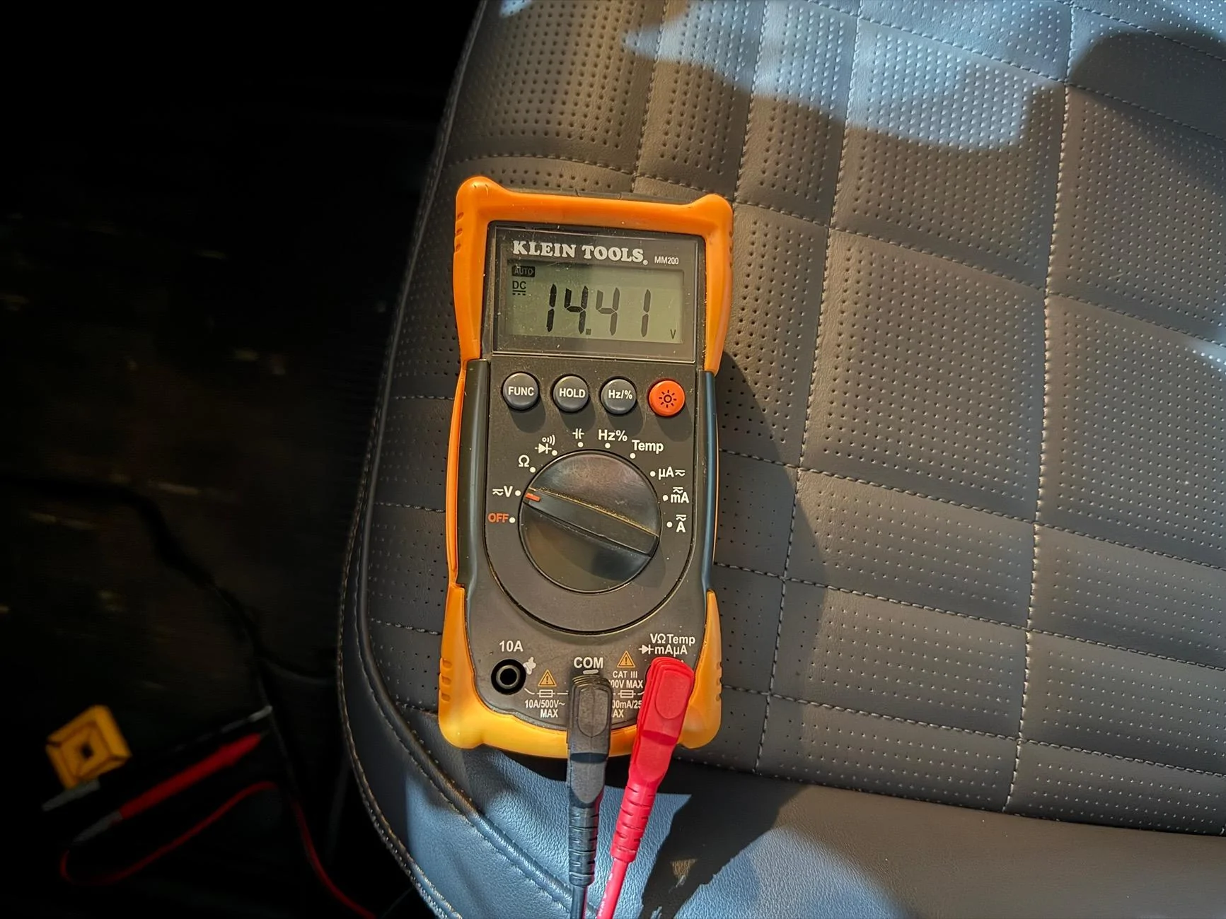

TLDR: Latest update has changed how 12v battery is charged (at least on G2 R1S).
Gultin great work on your setup. Since the latest update our G2 R1S has been sending a constant voltage of 14.3 - 14.4 volts to the 12v battery. The amperage is minuscule as the battery is fully charged. I have tested this overnight and in the morning without waking the car it remains at this high voltage. Over the next few days I will let it sit unplugged with no tender and see if the VD has improved. I suspect they did this to eliminate the constant drain and recharge of the 12v battery to reduce warranty replacements.
Wondering if Rivian is doing the same with the G1 cars.
Easiest way to test this is to open driver's window and place your OBD2 adapter so you can reach in and put a multi-meter on it. Best to lock the car and wait 30 minutes so you know if's fully asleep. Make sure gear guard and live cam is off.
If Rivian is doing the same with G1 I can't think of a benefit of using a battery tender when the car is asleep.
FYI, my G1 it's not doing this!
After seeing your post on the other thread, I let it sleep last night and tried the voltage (I have the leads in the frunk directly wired to the battery for my maintenance purposes) and it was reading the normal 12.6V

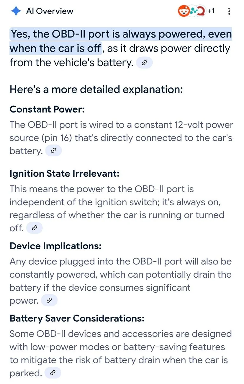

Interesting. So the OBD port isn't completely disconnected when vehicle sleeps?
