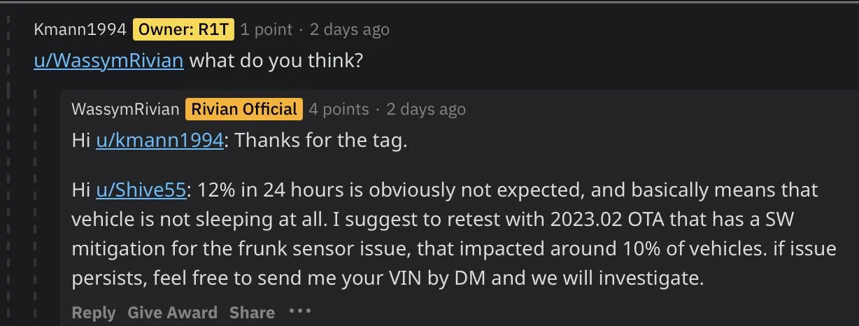

ORFynder
Oct 17, 2021
333
635
Bend, Or
"Rosie" the RIVN, Rav4 Prime
Optimistic Advocate
losing 12% is not normal per Wassym @ Rivian
