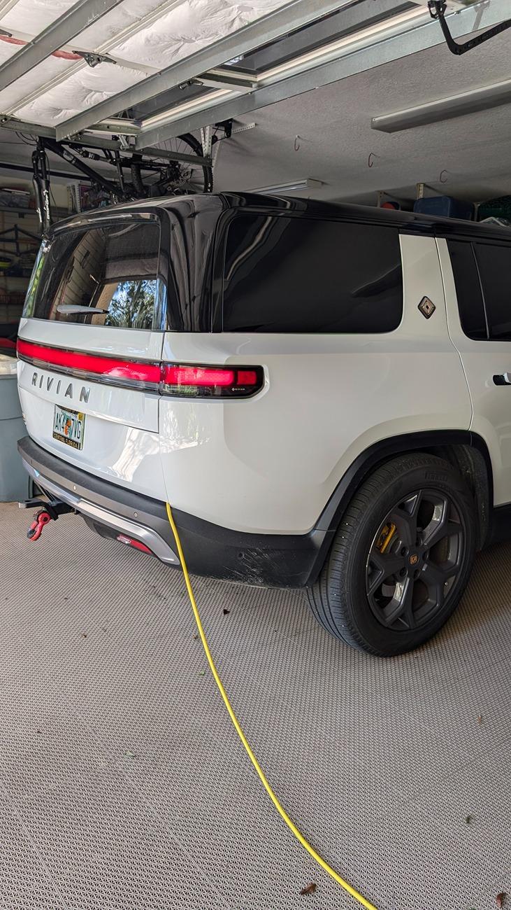

Worked perfectly for two days after the hurricane until power was restored. I just set the timer in the truck and was careful not to overload the circuit. Plugged in the fridge, router, wifi and a few small lamps.
Rivian R1T R1S Vehicle to Load dongle from charge port! PXL_20241010_163643018.MP

So that's the Jerry rigged method right, ok thanks for posting.
Another thought was to run it out the back passenger window and painters blue tape up the gap at the top of the window.
Running through the rear tail gate like that could potentially wear out the seals that prevent water coming in if you were to dip into 3 foot deep water crossings. Which the vehicle is officially rated for.
