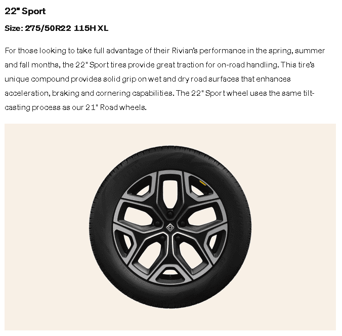

R1T on 22" all-season tires: I live in the Utah mountains and we have 3+ feet of snow on the ground, so I have driven up and down the mountain passes to the ski resort 12 mins away many times, with little issue. However, today we headed up to Snowbird as the snow was falling hard. It had turned from rain to slush to snow and was admittedly slicker than normal, but as we progressed up a steeper incline, I couldn't keep the truck from sliding sideways as the tires slipped. The truck slowed to 8 to 9 mph and wouldn't go faster. I couldn't even make the tires spin if I wanted to. It was like it went into a turtle mode but had no indicators. I decided to put it in Sand mode as none of the other modes seemed to help, as I hadn't updated the software to have access to a Snow mode yet. I barely made it to snowbird. Yes, i don't have dedicated snow tires and I am sure I will get a lot of "duh" comments saying they aren't meant for snow and they are also 22" but it is disappointing performance regardless. Unlike a traditional 4x4 (5 Jeep Grand Cherokees in our family over the years), there wasn't that clear sense of the 4x4 doing some extra work despite poor tire grip.

I don't know about you, but my R1T made it up to and around Alta just fine the other day. I live in PC and have cruised up and down snow covered roads with no problems in my R1T this season, but I am running 20" ATs and probably in the 99th percentile in terms of Utah snow driving experience. I am not familiar with the tires on the 22s but I'm guessing you did not think this one through as 22s will limit your tire options substantially and they will be absolutely impossible to air down for traction and I suspect the stiff sidewalls in the 22" tires could be a reason the traction is relatively worse. Snow mode isn't going to fix that as there is literally nothing special about snow mode. It is just a lower level regen standard. You can go to "all-purpose" and simply select "low" in regen and you get the same thing.
How about guh. Notice the seasons Rivian mentions. The tires are M+S rated but that doesn't really mean they are actually going to provide reasonable performance in extreme mud and snow conditions.

It’s a free country and you can be disappointed if you like, but it’s totally unrealistic to expect those tires to perform in those conditions. It’s an all season performance street tire. Don’t blame Rivian because you decided to try that.
