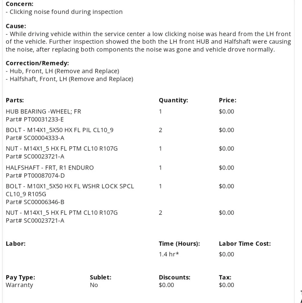

I have the same exact noise. I have appointment in Dec. I think it’s the jounce lines. I can get it to happen just by getting off and on the accelerator

I had something similar... More of a knocking than creaking. They replaced the hub and half shaft under warranty.
