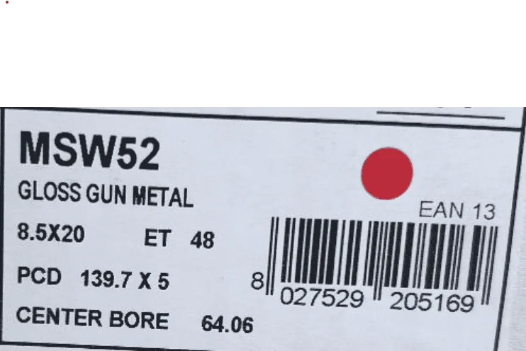

Just posting this in case anyone does a search. I saw another post that said the MSW52 wheel had a bore size of 64.1mm that matches the R1T. The label below says otherwise.
I had my local Discount Tire install MSW Type 52 wheels ordered from TireRack. They would not fit on my 2022 R1T. The guy at TireRack basically called the Discount Tire guys incompetent, and swore up and down that others have gotten it to work. So I brought the wheels back and we tried again, and still didn't fit. I went onto the floor and verified myself that it didn't fit. The MSW Type 52 has a bore size of 64.06mm while the Rivian requires 64.1mm. I don't know if they grinded something down, or used a hammer, or just the tolerances of the wheels or the vehicle made it work for other people. I'm sure someone has gotten them installed, but they didn't work for me.
I ended up getting the EVSportline R800. Almost 2x per wheel, but they actually fit, so it was worth it.

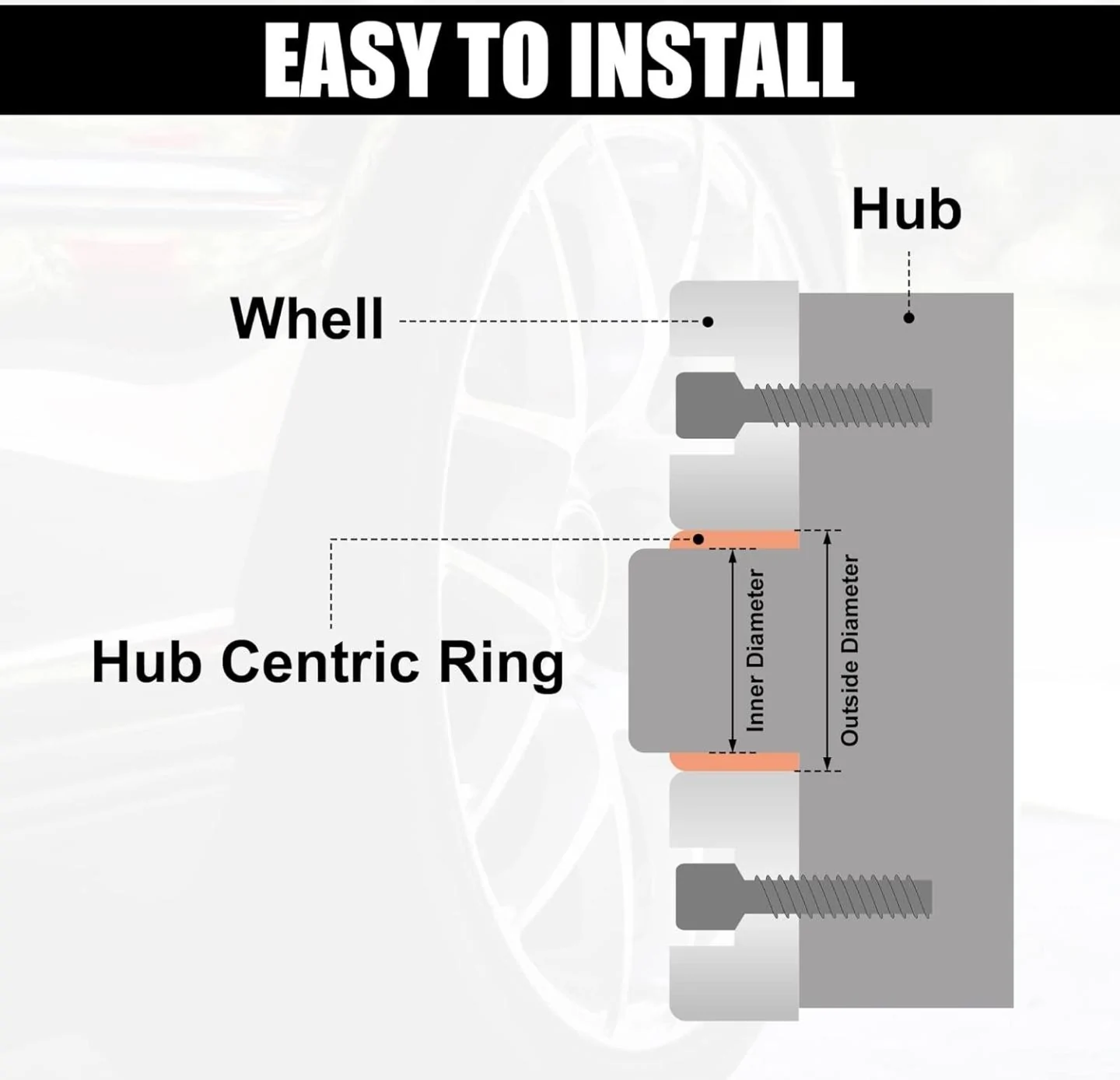

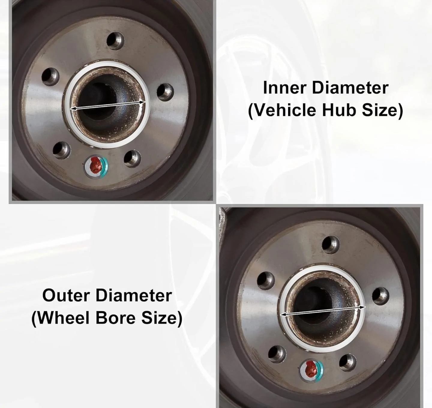

Don't know if this will help you. I had to get these for my wheels.
Hub Centric Rings Wheel Bore Center Spacer Replacement. https://a.co/d/3IUJHGu
