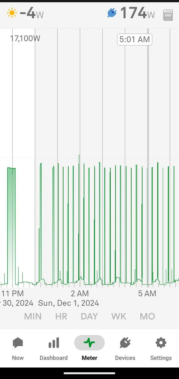

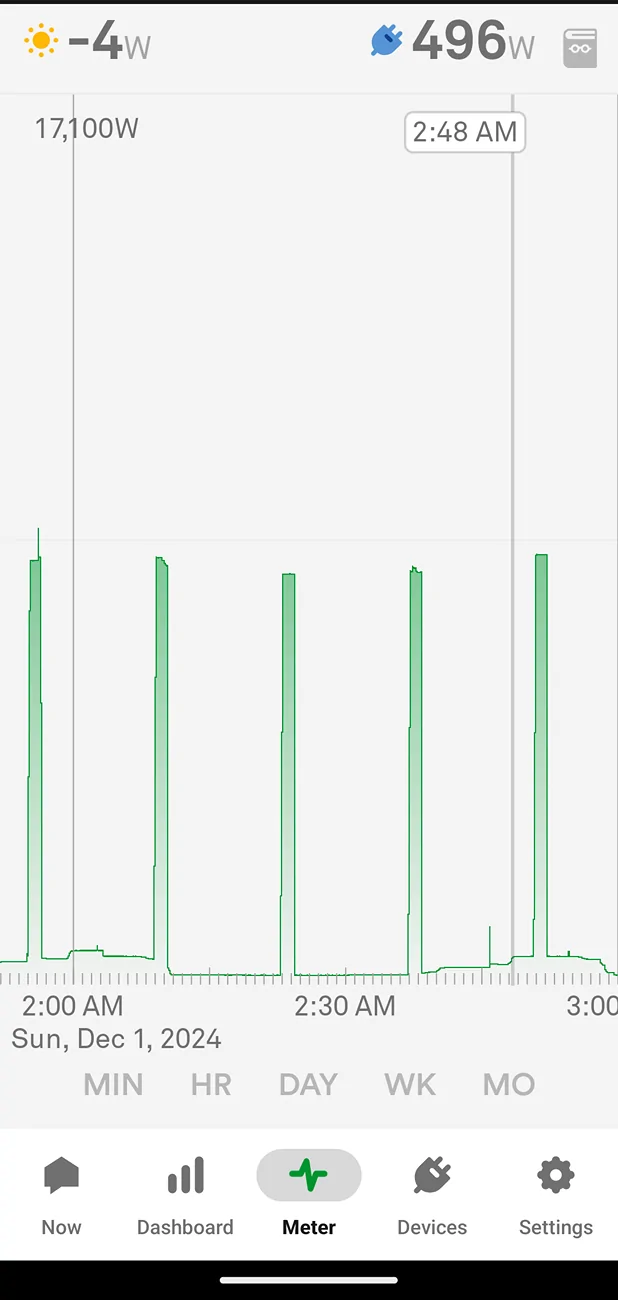

A snapshot of R1T self-consumption through 1 night in my un-heated garage when temps were around - 20C (-4F).
Charging session started at 11:00pm on my return, the energy consumption spikes through the night would be thermal maintenance, I presume.
During the week I keep a charging schedule: 5:00am to 8:00am, so the battery has chance to warm up prior to my commute.
The charging schedule seems to not allow the self-maintenance consumption through the night, which is important to know.
Wonder if rivian would prefer I allow the self-maintenance and eliminate the charging schedule when temps are low-low.
What do you think?
