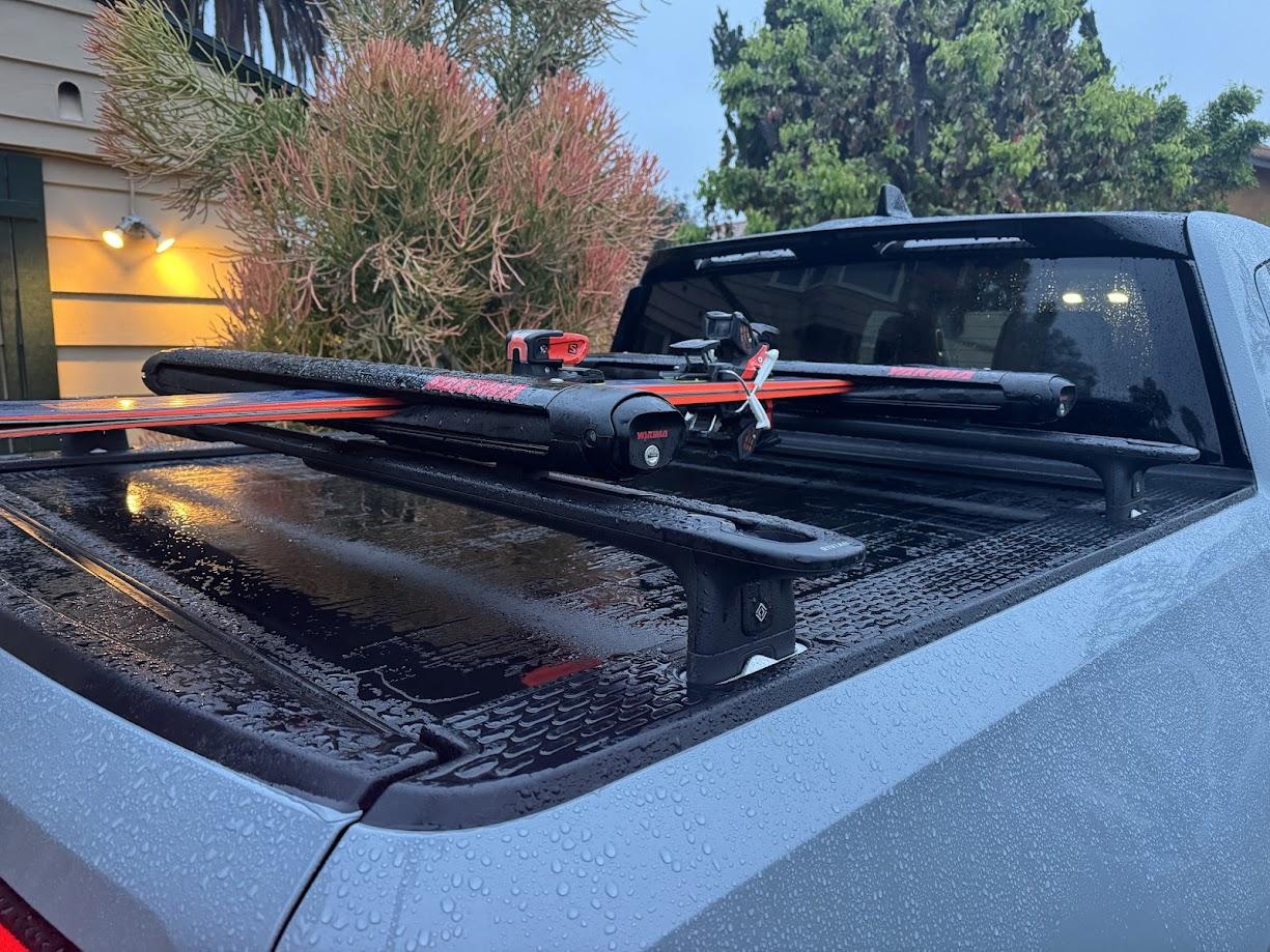

Those look great! Looks like you could carry 4 sets of skis without a sweat.
I'm unfamiliar with that set-up. Any concern that sudden braking could allow skis to slip and impact the rear window?

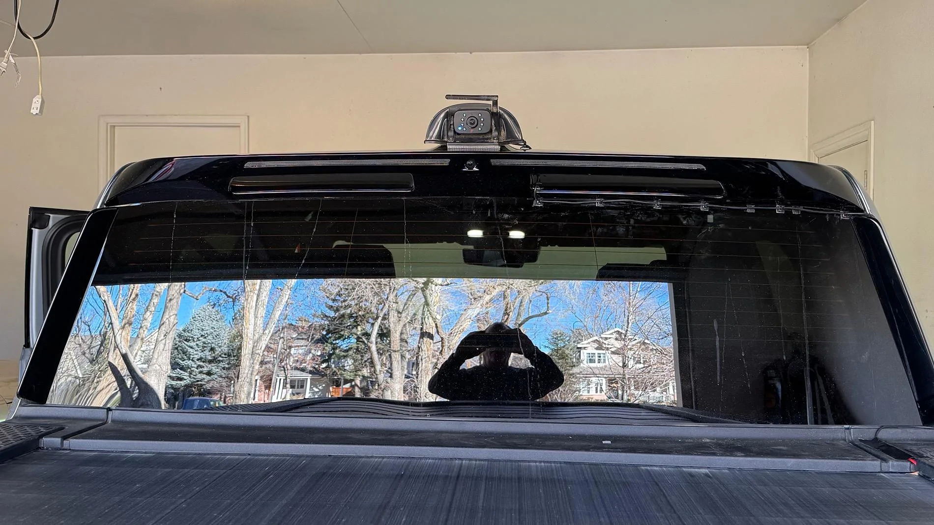

Nope, skis are clamped down good, I use the same rack and like having it over the truck bed vs the roof, MUCH easier to get them on and off. Only drawback is it blocks a good portion of the view from the rear view mirror, which is why I added an RV wireless camera to the spoiler.

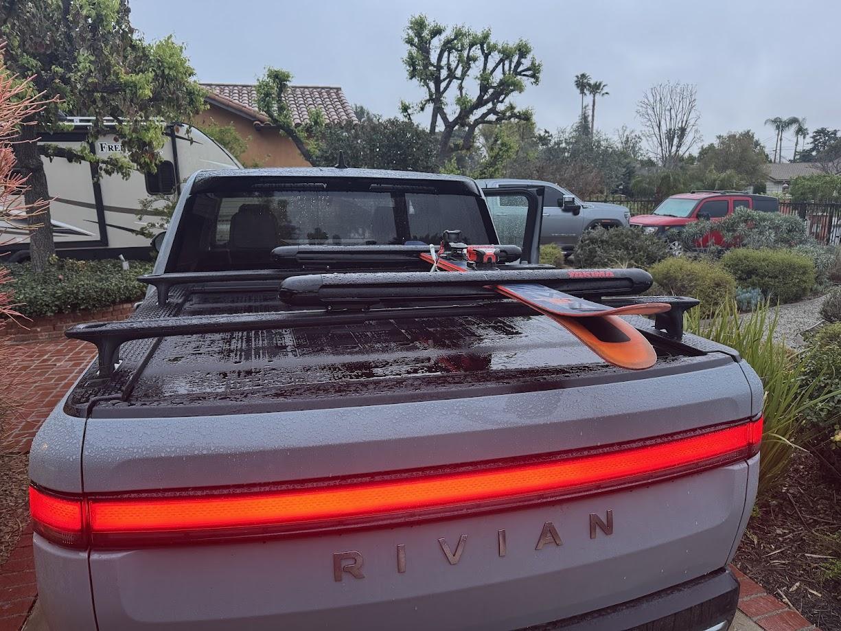

I very much have this concern. I have the exact same ski rack, mounted very similarly but was concerned about the potential javelins behind the head…. Not during hard braking, I’m sure that’s fine, but in case of an actual front end collision.
I then realize that I have a pick up truck and I can just throw all the skis in the bed. Problem solved. No more anxiety and easier to load/unload too…

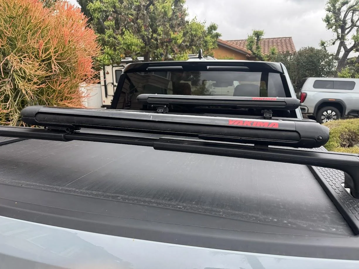

Got around to doing the Yakima FatCat mounting using T-Bolts in the rails. Designed and 3D printed some spacers to lift the racks slightly off the crossbar.
Nice not having them sit so high compared to using the original craossbar mount that comes with the Yakima racks
I used 6mm x 35mm stainless T-Bolts from amazon.
https://www.amazon.com/dp/B09TYS712R?ref=fed_asin_title&th=1
https://www.printables.com/model/1181326-rivian-crossbar-spacers-for-yakima-fatcat-ski-rack

Great solution, thx for sharing. For 3D printing purposes, how many of each size do you need to print? And I didn't see dimensions, but perhaps I am missing something? TY
2 of each
