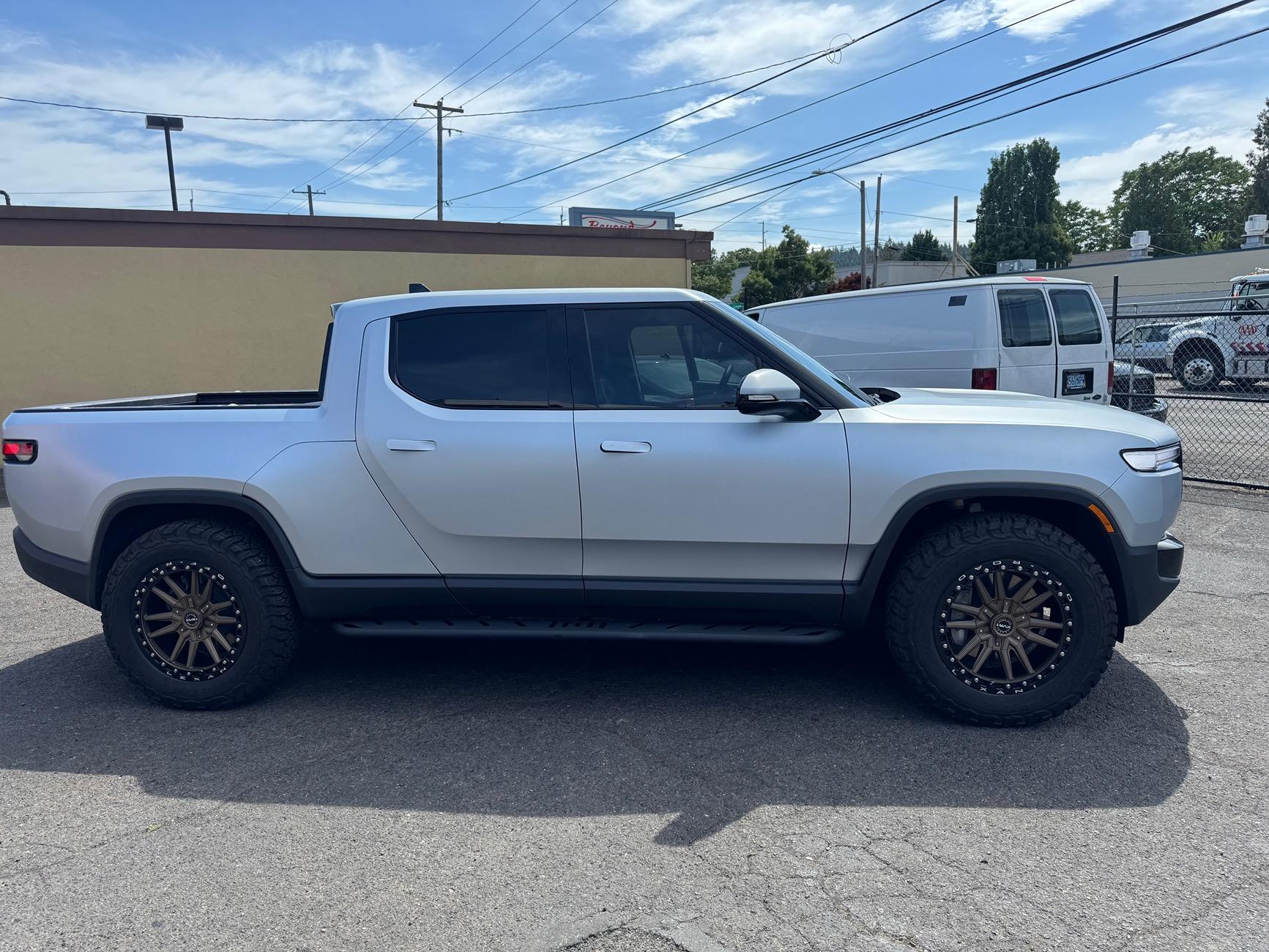

I was looking for a set of wheels to go with my KO3 tires, since I put the steelies on my snow tires. A local tire store told me that these Lexani would work. I agreed and he installed them. I thought they looked good, but the rubbing sound when the car is at low height is awful. I promptly had them removed, and will now just order a set designed for my R1T.
Rivian R1T R1S 0 offset wheels DO NOT fit without rubbing IMG_2304

Yeah, there are are some older threads buried here somewhere that determined +18 was the closest to 0 you could get without rubbing, and even with that it seemed to vary based on the tires, design of the wheel (caliper fit). I think +25 is more realistic.

Good looking wheels. I’m a fan of the beadlock look.
