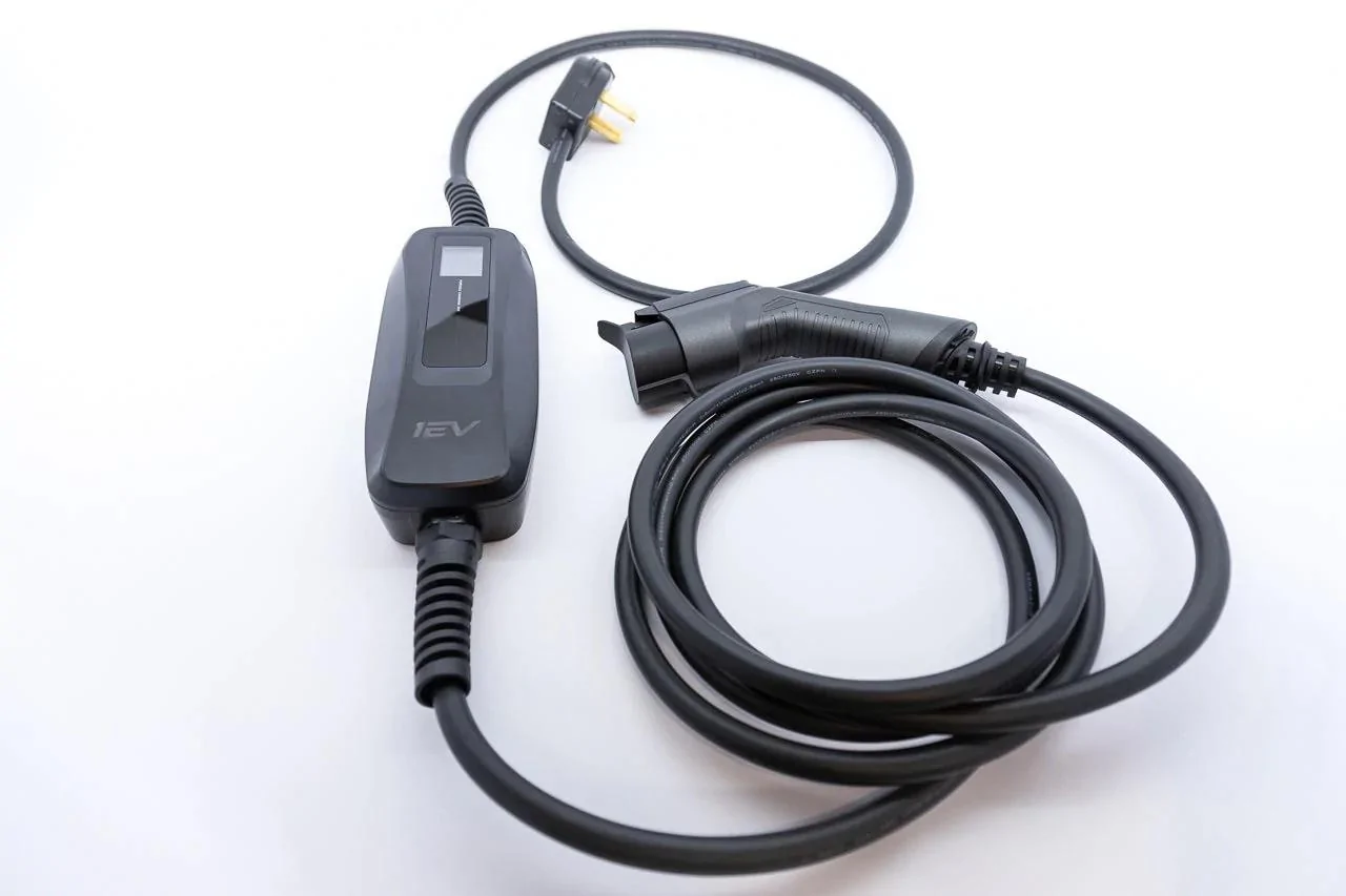

Portable chargers for Rivian R1T / R1S have launched! 40amp fast charge ??

Can you share what manufacturer whitelabled this for you? I'd like to know for peace of mind. I've been meaning to get a portable 40A unit for my R1T and Mach-E.

A few questions:
1. Is it UL-certified?
2. Will it support 120V, 30A using a TT-30 adapter? (that socket is available at most RV parks.)
3. Can the max amperage be lowered on the EVSE? (I'd also like to use this on my other EVs, one of which has no ability to lower amperage in-vehicle, so if I plug this in using a plug adapter to a 30A circuit, I want to be able to tell it to use less amperage, since I can't in-vehicle.)

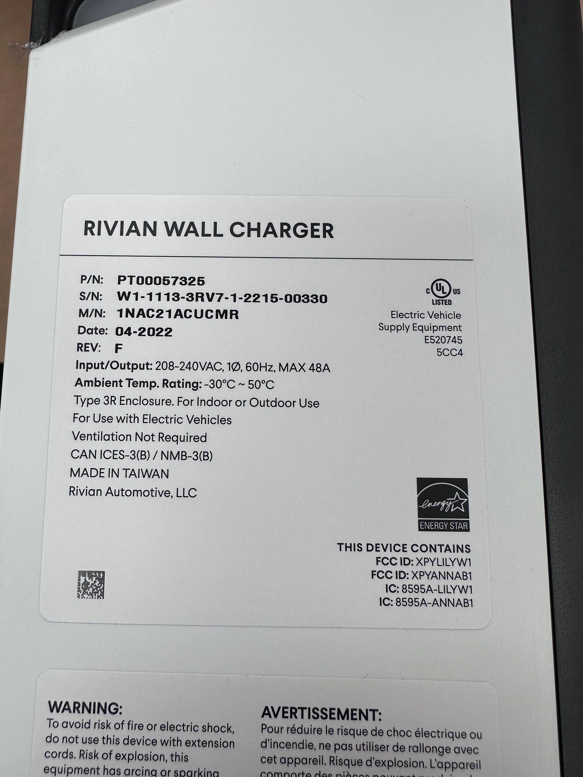

Rivian sells a 48 amp charger too :)
The Team 1EV charger is a-okay for Rivian.

A few questions:
CE and TUV listed [these are European equivalents to UL]. UL is optional in US, but CE is mandatory in Europe.
Yes, you can use 120V, 30A using a TT-30. But you cannot exceed the output of the charger, ie the 16amp charger maxes at 16 and the 40 maxes at 40.
Yes, you can adjust max amperage on the charger - for sure.

Hope you have liability insurance for when people plug this into a 40A NEMA 14-50 and expect it to not burn down their house. I'm pretty sure that's why Rivian limits their portable charger (included in your R1 purchase) to 32A.
The Rivian portable charger can actually pull 34a despite being rated for 32a. I plugged it into a Nema 10-30 dryer outlet using an adapter, and the vehicle defaults to 34a. It charged like that for a couple hours before I realized it and knocked it down to 24a. The outlet was definitely hot though.
Why would a charging cable rated for 40a not be able to plug into a Nema 14-50 and pull 40a? What component in that system is out of parameter?
If their NEMA 14-50 is only on a 40A breaker, then that's out of spec, and could burn down someone's house on *ANY* 40A EVSE. Of note - I have 40A wall-mounted EVSE connected to a 14-50 outlet in my house. That's "the standard" for wall-mount EVSEs that aren't hard-wired. 14-50 plug on 50A breaker running at 40A.
VSG
Oct 3, 2022
3,305
6,219
R1T LE/RB/OC/20
Not so - code allows a NEMA 14-50 socket on a 40A breaker, because there is no standard 40A socket. This has been discussed over and over again on these forums by people wanting to install their own socket. IMO it's an extremely bad idea unless the outlet is inaccessible and dedicated to a specific appliance like a stove, but code does allow it.
And again, I believe that's why Rivian limits their portable charger to 32A (80% of 40A). I can't think of any other reason for that limit.
Regardless, if someone is to market and sell their own portable EVSE which automatically draws 40A when plugged into a NEMA 14-50, then I think that someone needs to either have a permanent warning sticker attached to the EVSE or carry a lot of liability insurance. The fact that the OP equates the 48A hardwired Rivian wall charger with his own portable plug-in EVSE to justify the 40A means he doesn't understand the basics here.
