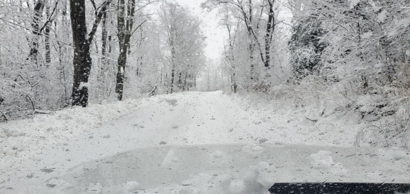

The problem I have on our PA 2 lane State paved roads is the roads are not plowed wide. The center with heavy crown may show pavement or be blcak ice, but right side has heavy snow. Along with crown, this pulls unenvenly towards the ditch (we have no shoulders). Encountering a vehicle the other way puts the right side in that heavy snow and encountering idiots who plow sriveway snow into the roadway creates a fierce tug to the right and can bounce your foot on the pedal. The Rivian is heavy so correction is touchy. Hopefully, Rivian addressed this with "snow mode". Photo is a normal commute on our PA State Highway. On this commnte I was pulled to the right in a slide 4 times and had to ever so gently correct.
Rivian R1T R1S Experience: Snow Mode is great on pavement w/ compact snow & ice, but All Terrain Mode is better for deep snow PA State Road on way to work
