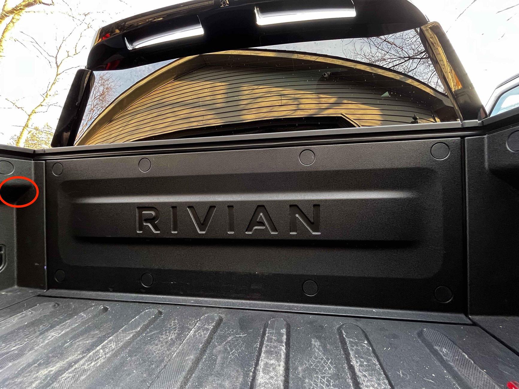

I'd like to install a 12V outlet in the bed, where I can connect a wiring harness to my iKamper rooftop tent to power 2 LED lights, a USB-C outlet for phone, and a 12V outlet for the mattress inflator/deflator pump.
I'm planning to use this waterproof Cnlinko connector: https://www.amazon.com/CNLINKO-Industrial-Waterproof-Connector-Anti-Interference/dp/B0CNNXF9VV/
Looking for a good place to mount this that will not get in the way of loading cargo into the bed. This spot (circled in photo) seems like a good candidate. Before I try removing that side panel, I thought I'd ask here to see if anyone has done this before?
Running the wire into the gear tunnel should be easy, based on what I read in this thread. I will power it from my Pecron E1000 battery in the gear tunnel so it works when the truck is asleep. Or if I don't want to bring the Pecron, this could easily be plugged directly into the gear tunnel 12V outlet instead.
