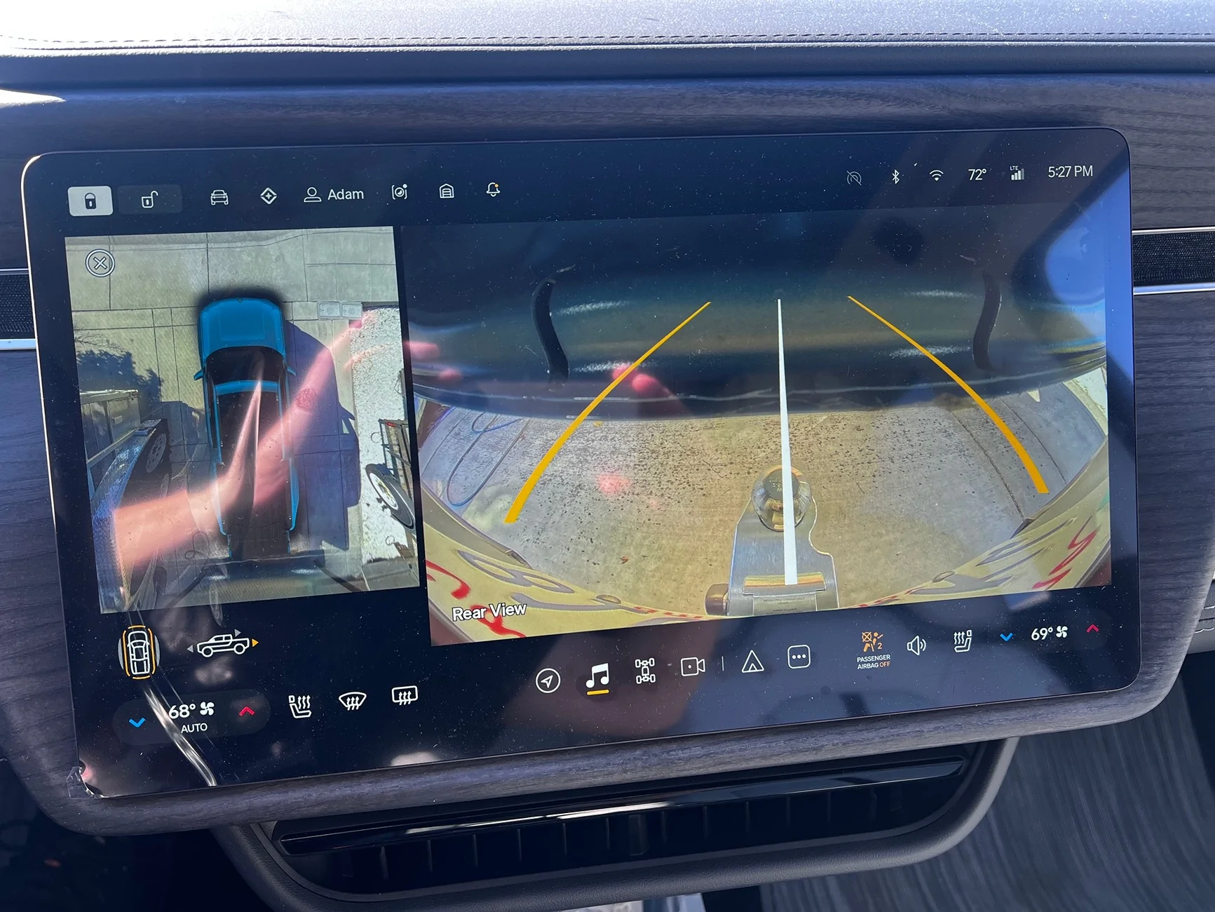

Whenever I'm trying to back into my driveway, which is a tight squeeze, the R1T automatically switches to the "Rear View", which is just a 4K closeup of my hitch ball. This is a useful view when trying to hook up my trailer, but the other 99.9% of the time, I actually want a back up camera so I'm not crashing into said trailer, or our other cars. If I have to alternate between forward and reverse to manuever, it always switches back the trailer hitch view. I just want to lock on "Bed Camera", but I can't for the life of me find the settings in the menus. TIA.

EDIT: You are correct that it's an option, it's apparently just not enabled by default in whatever software version came with this vehicle (or maybe the dealership configured it this way?) I called Rivian and they told me where in the menu system this can be enabled (photo in the newer post), which I did, and now it works as you describe.
I did actually have the tailgate down when I was seeing the behavior I described. With the tailgate fully down and bed loaded with sheets of plywood, it always selects the trailer ball camera every time I go into reverse.
The tailgate being down effectively makes this camera useless as a backup view, since the top half of the frame is just the out-of-focus tailgate. There's absolutely no visibility of anything behind the truck, all I see is the trailer hitch ball and the patch of ground below it. The tailgate will hit my garage door well before the door becomes visible in this camera's view. I kinda doubt this restricted view meets the requirements of regulations people are mentioning; its far too obstructed.
Here is exactly the view I get when I reverse into my driveway, tailgate down:
Rivian R1T R1S How can I make the "Bed Camera" the default backup camera? IMG_2274
Every time, I have to tap on the profile image of the truck to get it to switch to bed view instead, so that I don't plow through my garage door.

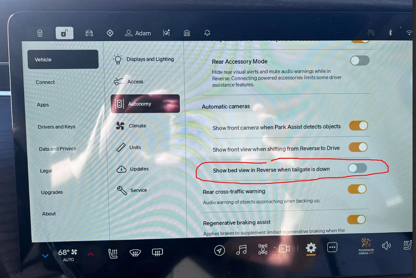

OK, I just called Rivian and asked. The setting does exist, it's just not on by default (at least not in this software version) it's in a really odd place in the menu system: Settings -> Autonomy, way down at the bottom past the actual autonomous driving settings:
Rivian R1T R1S How can I make the "Bed Camera" the default backup camera? camera_setting
I'm happy the setting exists, but I would have liked it to be somewhere more intuitive, like on the cameras page. I don't have any self driving subscription on this truck and never thought to look here.
It does seem a bit strange to tie this to the tailgate position also, there are a lot of hitch receiver accessories like bike racks and utility baskets that would also obscure the rear view camera the same way (or worse) than the tailgate does. 🤔

Yep, fair. And I'm glad it has a setting for this case, though I do think it's a bit unfortunate that regulations restrict it to just when the tailgate is down, as I also have a hitch-mount bike rack. :-/
