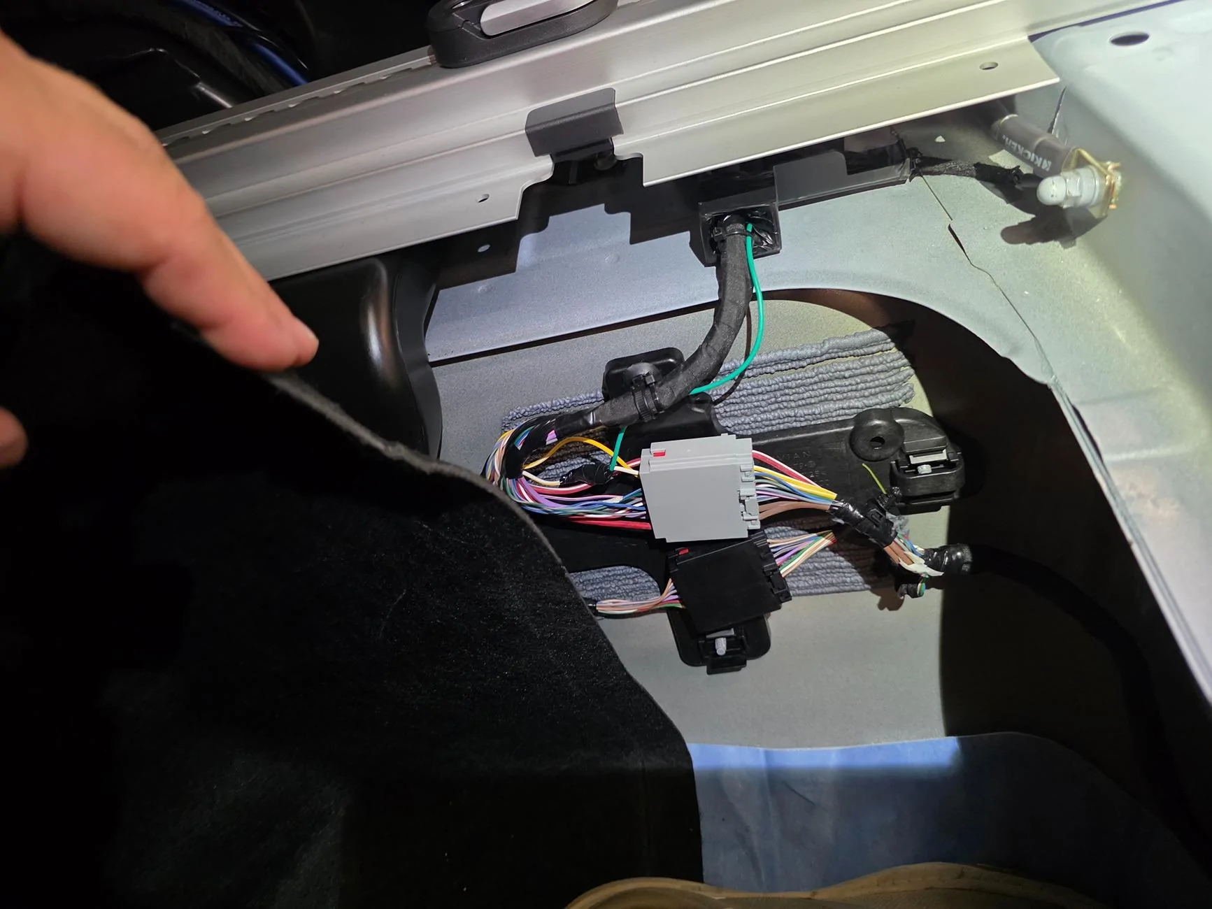

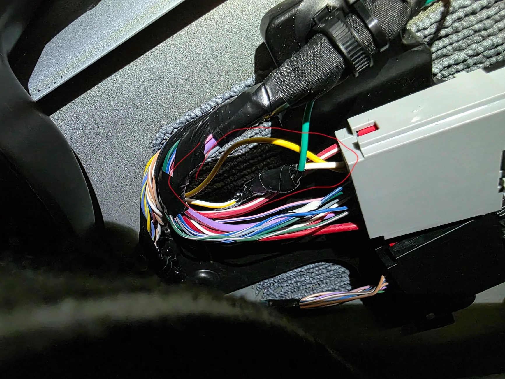

Hi - I’m almost finished with my subwoofer install on my 2025 Gen 2 R1S, except I can’t find a switched 12V power source??? Older R1S vehicles have a different wiring harness in the spare tire well (ref. the Alpine sub install), and I don’t seem to have the fuse box like the Gen 1. I’ve tried tapping the trailer brake power, but the ‘smart’ electrical computer dumbs the voltage down to 5V when I connect the amp load to it. I need a good source I can tap and put a fuse on it and run a good size wire to the amp. Appreciate any advice.

Either of the yellow-white or white-yellow wires in the spare tire tub on the passenger side upper wiring harnesses are switched 12v. I used the upper wire (white with yellow stripe) into my LC2i Pro that feeds my JL MX500 amp in my 2025 R1S...
