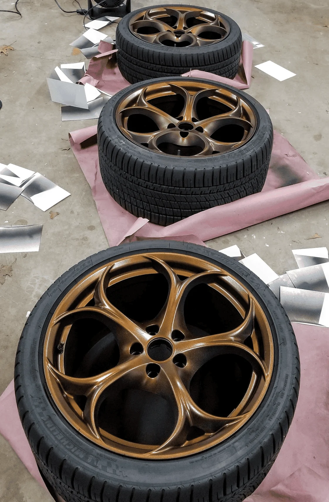

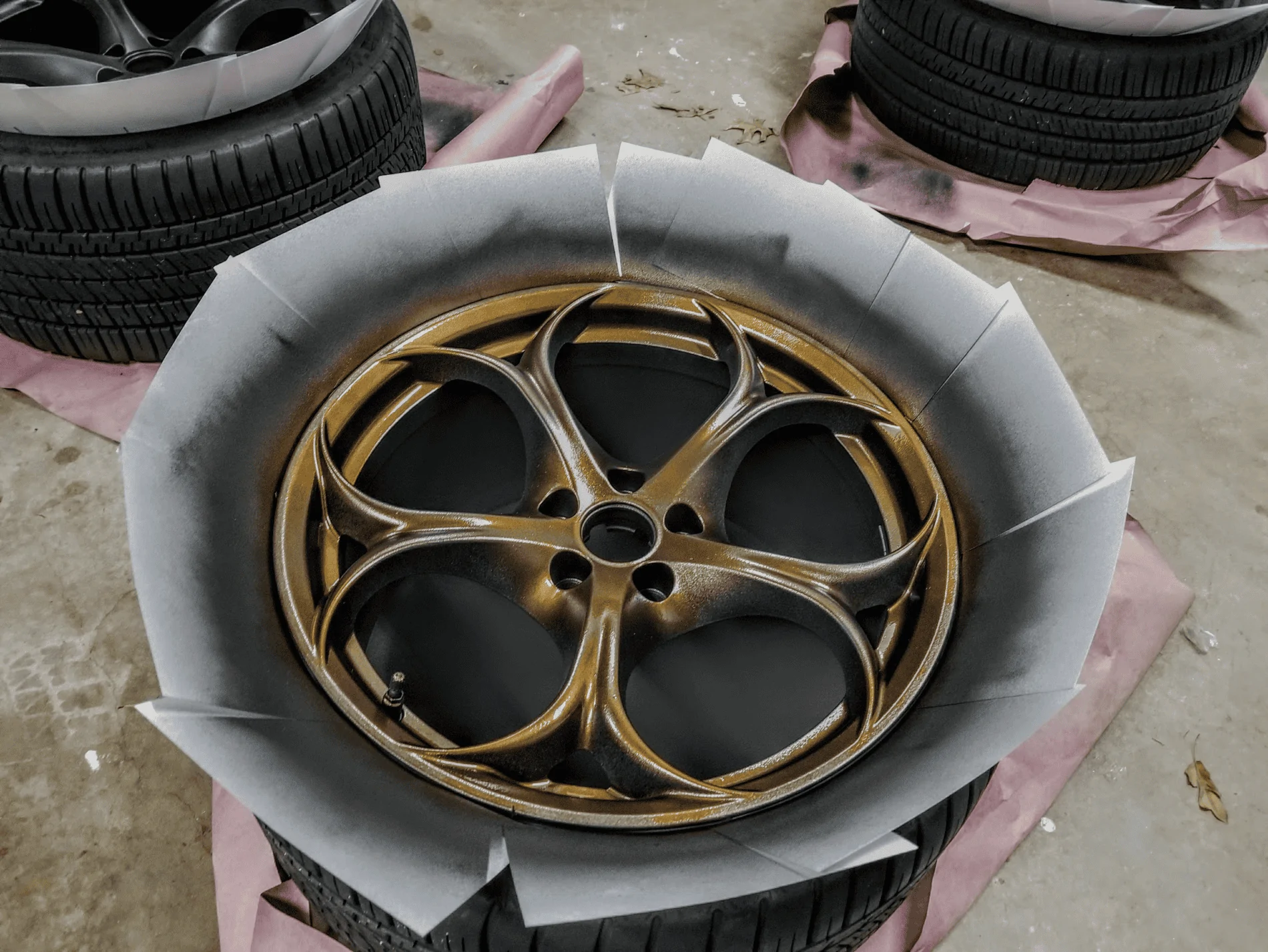

I've always wanted to switch up my Giulia's dark five holes to something with more pop. What color plastidip is this?
Copper Metalizer Wheel Kit from dip your car.

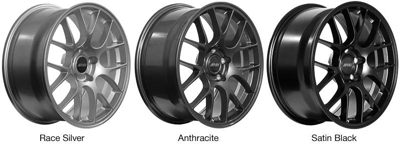

Anthracite is just a lighter hue of black or a darker due of silver. No more $$ than black, just a fancy name.
