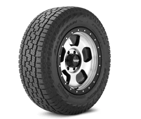

Anyone that thinks that this tire:

needs to share whatever they are smoking because you are not seeing clearly. I mean there is 14" more rubber as compared to the 9" on the 24" wheel with that tire, the largest factor in tire efficiency is the hysteresis (how much the tire flexes when it meets the road). They won't even be close at the same pressure. On top of that the tread is significantly taller and more aggressive on the AT.
