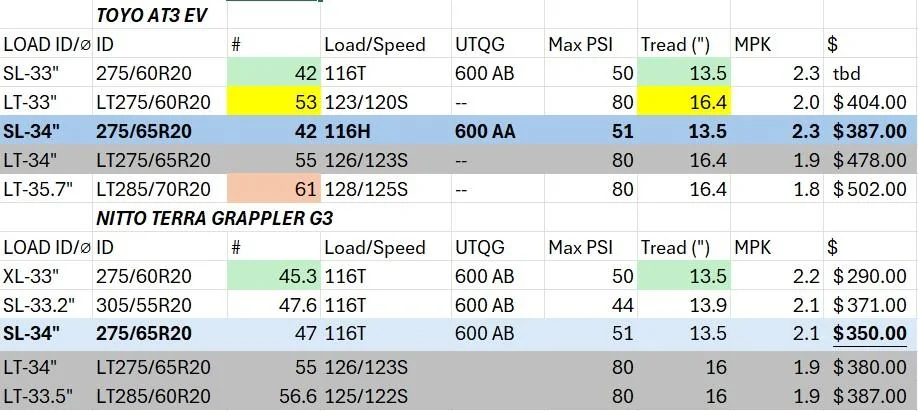

As it turns out, there are a ton of options for both of these tires. My impression is that Nitto is better suited for onroad use and Toyo is more off-road oriented. That being said, the only 116H rating is the Toyo (275/65R20). Prices range from $300 to $500 each, median price of $400. Toyos tend to be $440 and Nittos $360.
EDIT: Appears the Grappler is also 116H…(conflicting info…)
For those looking to maximize range, the 33” grapplers are $290 and likely less noise than the Toyos. At 42# the Toyos (33”, 34”) are lite weight and should be very efficient.
if looking for LT size, Toyo has 33” and 34” options (or even 35.7”) while Nitto has 33.5”/34” options.
Average efficiency will range from 1.7 to 2.3 MPK depending on weight and what PSI is used (on Lots).
Will be interesting which model and size people end up with, so many options!
note tread depth is 32nds inches:
Rivian R1T R1S Nitto Terra Grappler vs. Toyo AT3 EV Tires -- 10 Size Options! IMG_1164
***** - please note: using conserve mode/ inflating to 80 psi may result in higher MPK for LT sizes*********
Rivian R1T R1S Nitto Terra Grappler vs. Toyo AT3 EV Tires -- 10 Size Options! IMG_1184
Rivian R1T R1S Nitto Terra Grappler vs. Toyo AT3 EV Tires -- 10 Size Options! G3 v AT3

This is awesome, thank you!
A few Qs:
- What are you using to generate the MPK figures?
- What is "Tread (")"? I assume tread depth, but surely the unit is not inches then.
A few Qs:
32nds for tread depth
Guesstimates for efficiency (related to tire weight), alts max PSI is 80 so there’s possibility to increase efficiency at expense of ride quality (65 psi vs 50 psi).
the 35.7” Toyos look interesting!

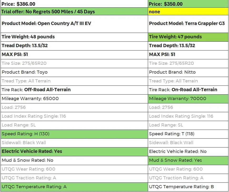

That's where I'm unsure if these MPK estimates are accurate. Toyo's site does indeed list the 275/65/20 116H AT3 EV at 43 lbs, which seems incredibly light for what it is, then TireRack's site lists it at 48lbs, which is more believable considering it's a true AT tire.
The Nitto Terra Grappler G3 275/65/20 116T is listed on both Nitto's site and TireRack at 47lbs.
I am not convinced that the Toyo will be more efficient than the Nitto. I feel like the real numbers would contrast your estimates, consider the Nitto is considered an "on-road all terrain" tire and was engineered for mostly road use, and to be lighter than most true ATs.
Getting each tire on the same scale would be ideal, as I still have a hard time believing that the Toyo is lighter than the Nitto in the aforementioned specs.
They can never be “accurate”. Only estimates as the environmental conditions (temp/wind/terrain/driving style/driving mode) and other factors like air density/elevation have a huge impact on these values. The key is simply that with a 60 pound tire you can expect significantly less efficiency than a 40 pound tire. I can’t speak to the accuracy of Nitto/Toyo spec sheets…always possible someone made an error…hell, Brian has been begging Goodyear to update the tire photos for months now…
My main point is that for both these options there are 10 variations to consider based on price and other factors…

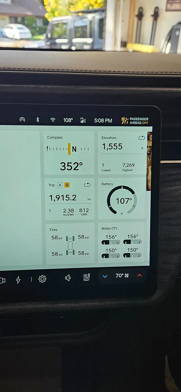

I have the Toyo AT3ev LT275 65 R20 they are quitter and more efficient than the OEM Pirelli AT.
I was informed by Toyo to run them at 53psi on road for max traction and efficiency.
I was getting 2.11 on the Pirelli's Im getting 2.38 on the Toyo's so not sure where you got the MPK 1.9
Rivian R1T R1S Nitto Terra Grappler vs. Toyo AT3 EV Tires -- 10 Size Options! 20240723_161909_resized
Pirelli's
Rivian R1T R1S Nitto Terra Grappler vs. Toyo AT3 EV Tires -- 10 Size Options! 20240905_170835_resized
Toyo
I have 5,800 miles on them now no regrates, been off roading in sand and also my daily commuter.
Traction is great Ride is good.
I would not use a taller tire in lowest ride height setting if there is to much of a slope for a drive way it will rub a little while turning other than that no other rubbing issues.
I have nothing but good things to say about the Toyo a/t 3 Ev tires.

Using conserve, AP, sport, mix?
What’s average speed?
Any of this at elevation/hot temps?
For a 7# heavier tire than OEM, I would not expect it to be >10% more efficient. Also, why did #out2dasea only get 2.08 MPK using the non-LT size?
