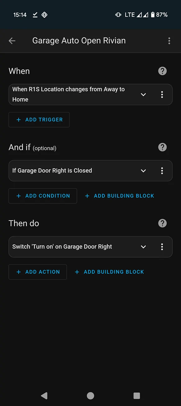

Coming from a Tesla that already had the "open garage door on approach/departure" feature, I found the manual necessity of the Rivian implementation disappointing and downright unreliable. Like 3/5 times successfully working.
So I just thought I'd share a little automation using the Home Assistant Rivian integration that has been a super reliable, and quite frankly better solution to a feature that's been half-baked since delivery.
Fair warning, you need to be running Home Assistant AND be willing to satisfy the integration's requirements.
Essentially, when the state of the vehicle changes from away to home, which ends up being perfectly at the bottom of the driveway prior to turning in, the automation checks to see if the garage door is open and if it's not, triggers the opening. No driver input needed and no waiting for the door to go up. Nice and simple. Now if I could just get the mirrors to fold.....

So, good question. I have an abhorrence for wireless if there's any option for wired. I have 5v relays running on Konnected boards that hardwire to each opener switch. So when you signal Home Assistant to trigger the opener, it's pressing the physical button for all intents and purposes. The open/close state is determined by a hardwire door sensor on the garage door jam itself.
For this project, Home Assistant is getting notified the car is home, so it checks the door sensor state, and then activates it's own switch if applicable. This skips any input from the Rivian homelink and the nonsense about range/length of press/no prompt that I constantly run into.
I remember reading myQ was getting rid of 3rd party support so I'm not sure how you could trigger your opener outside of it's apps ecosystem. You could always run something else in parallel like you mentioned.
Next steps are to noodle on additional improvements to tide me over until Rivian can play catch up. One thought is a reminder to plug the car in if it's after a certain time of night, trigger lights when pulling in, trigger the door to close when leaving, etc. The one thing I will say about this particular project, is the door status check. The Tesla will trigger the door regardless of the state so sometimes it would close on you as you pulled up if it was already open.

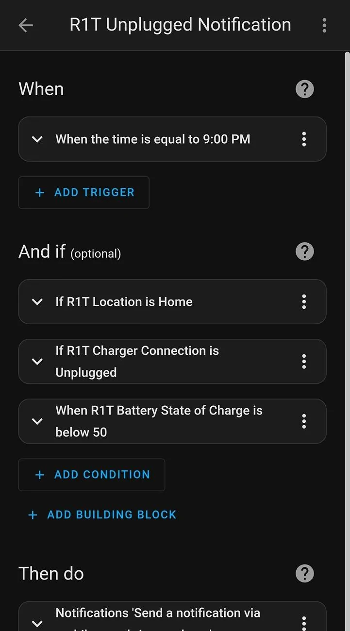

While I have a lot of IoT devices, my home is not super smart so this is probably the one thing I use HA for most, and it was super simple to implement...
I have basically this exact automation setup on HA and love it.
