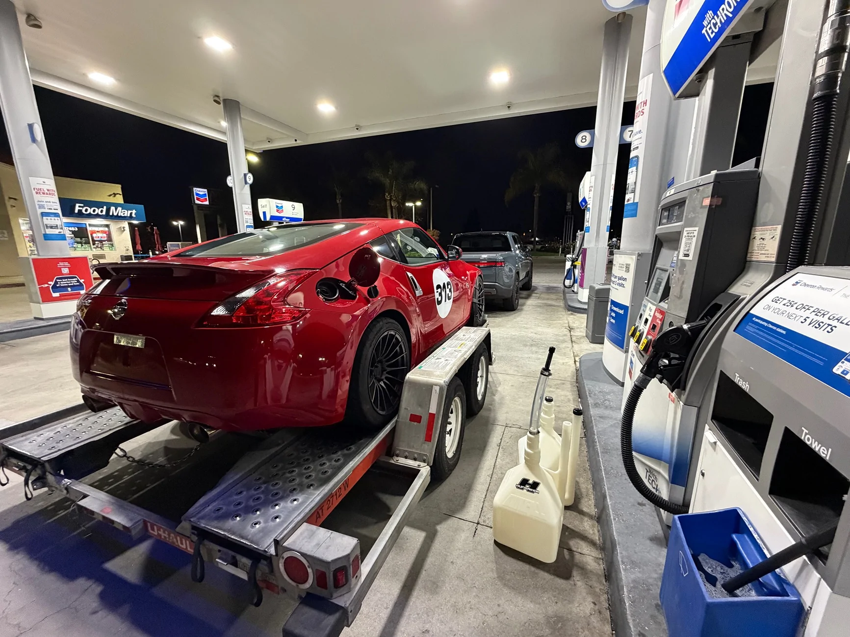

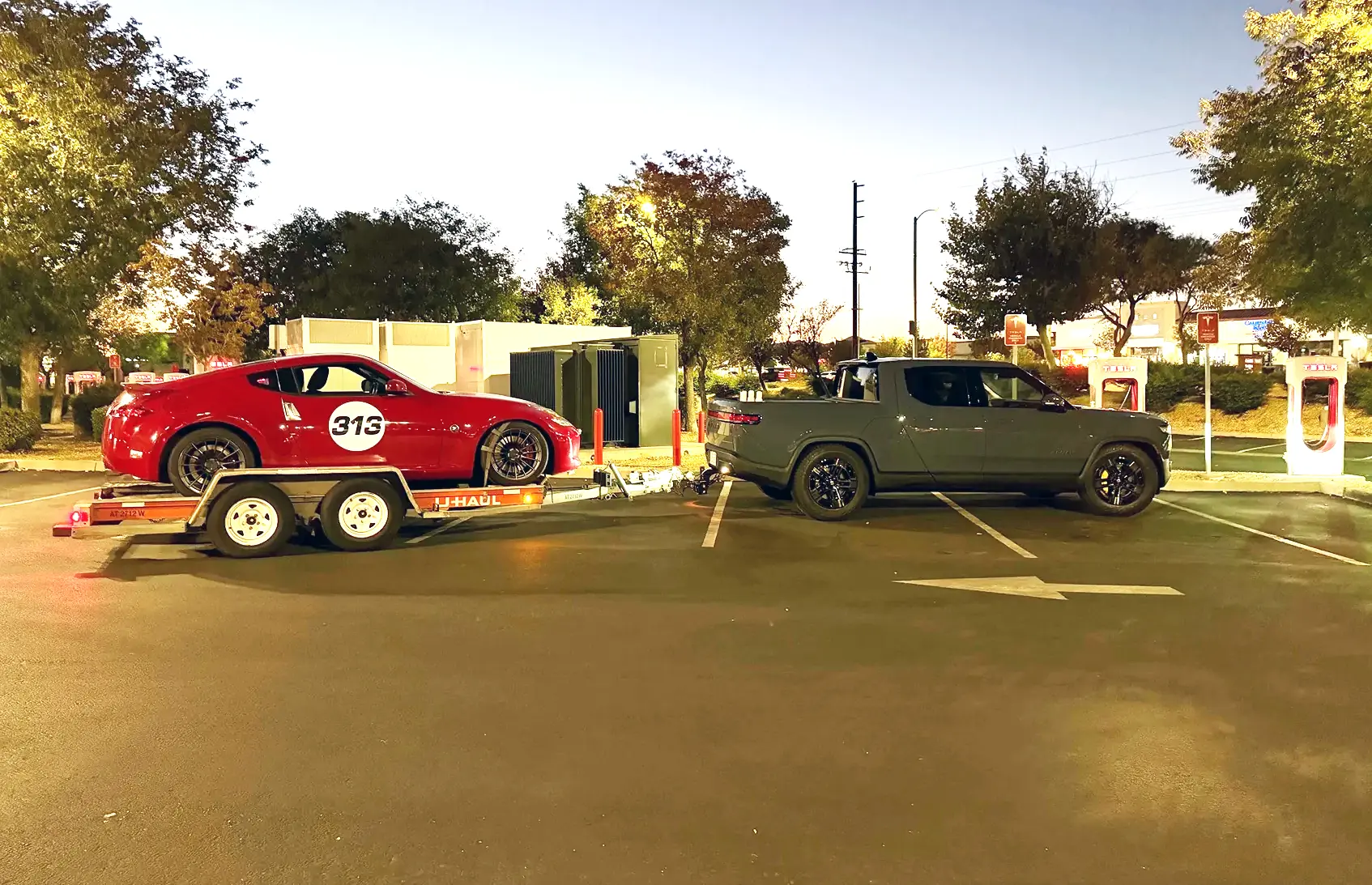

Towing and towing efficiency:
I’ve done about 250 miles of towing now (so not really much compared to some of the others here). Going against the grain, I will say you can definitely feel the trailer. It is nothing at all like towing with an ICE vehicle (I’ve mostly towed with U-haul box trucks, but have also towed a motorcycle on my parents Audi Q5). The R1T is just a little slower, but has basically gone from utter insanity to just regular crazy fast. From a capability perspective, it feels like overkill.
Towing efficiency is about as expected. About a 30-40% range cut. I averaged about 1.2 mi/kwh towing a 5500 pound payload. ~3300lb car and ~2200lb trailer. Rivian’s towing weight estimate is VERY coarse. It seems like it only has increments of 500lbs. It would say 5000lbs sometimes, 5500 other times, and 6000 once… The 1.2 mi/kwh was obtained on a trip to Willow Springs from Los Angeles and back from there to LA. Lots of hills on the way, and I went form sea level to about 2500 feet, with peak elevation being about 3000 feet. It was about 100 miles each way. Temperature was about 50F in the morning and about 75-78 on the return trip.
Charging with a trailer was fine because I drove early in the morning, but I could see it being really annoying if you have to unhitch. Unhitching would add about 5-10 minutes to each stop. It takes me about 2 min to unhitch, and 5-6 minutes to hitch back up.
Overall, it’s pretty much perfect for my use case. It adds about 20-30 minutes every 100 miles. I am only towing about 5-6 times a year. For that limited amount of towing and for a trailer payload of only 5000-6000lbs, an ICE truck did not make sense at all (gas is almost $5/gallon for 87), especially considering that driving during the day in LA is 50-75% stop-and-go.

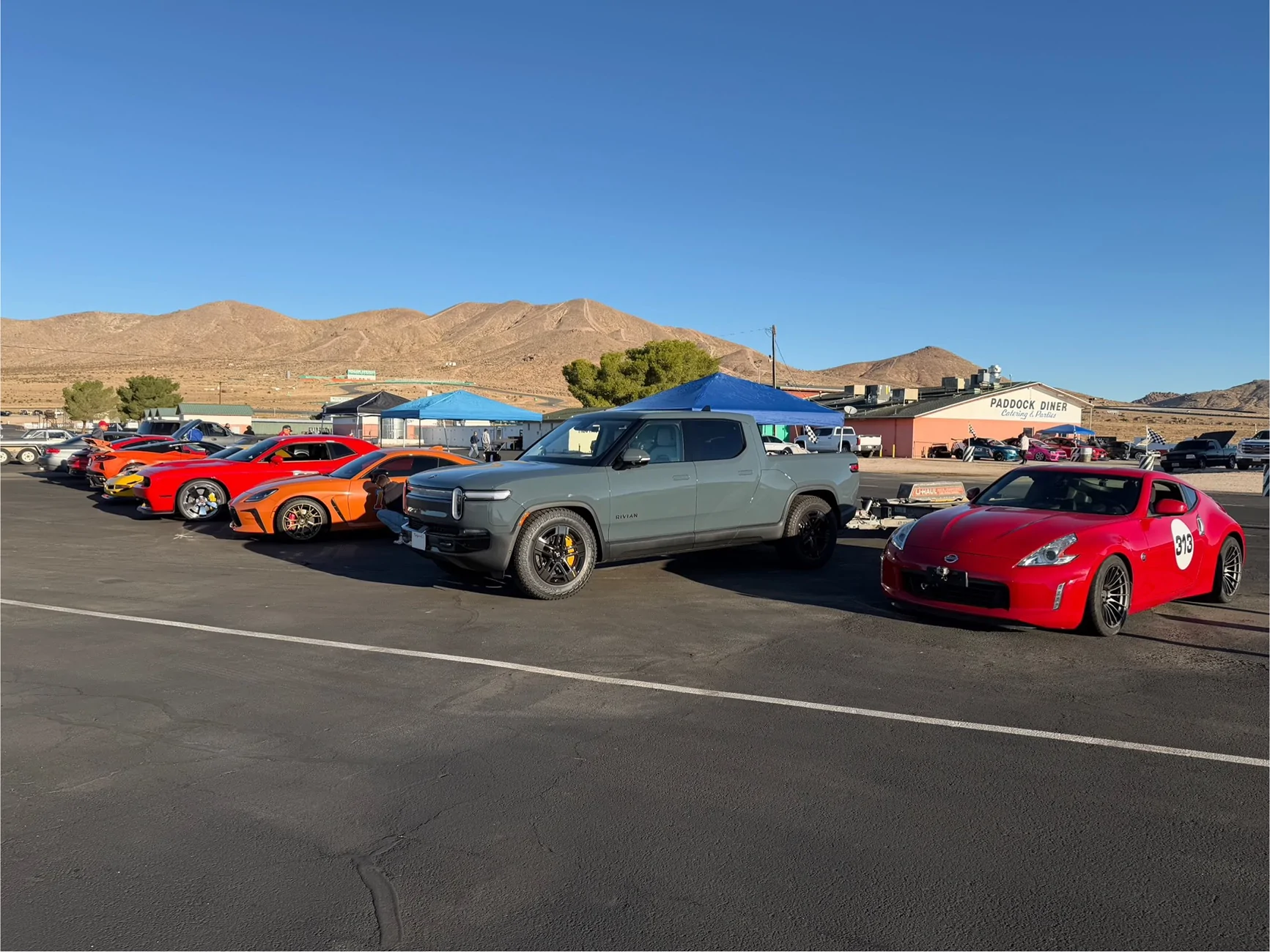

The outlets and the air compressor at the back are awesome. One less thing I need at the track. I can't run a table saw off the outlets, but a shop vac and everything else runs fine. Camping mode auto-leveling was actually super helpful loading a 30-gallon air compressor into the bed. The gooseneck tailgate is cool and just about makes it adequate for getting sheet goods and 8ft boards from the lumber yard or the hardware store.

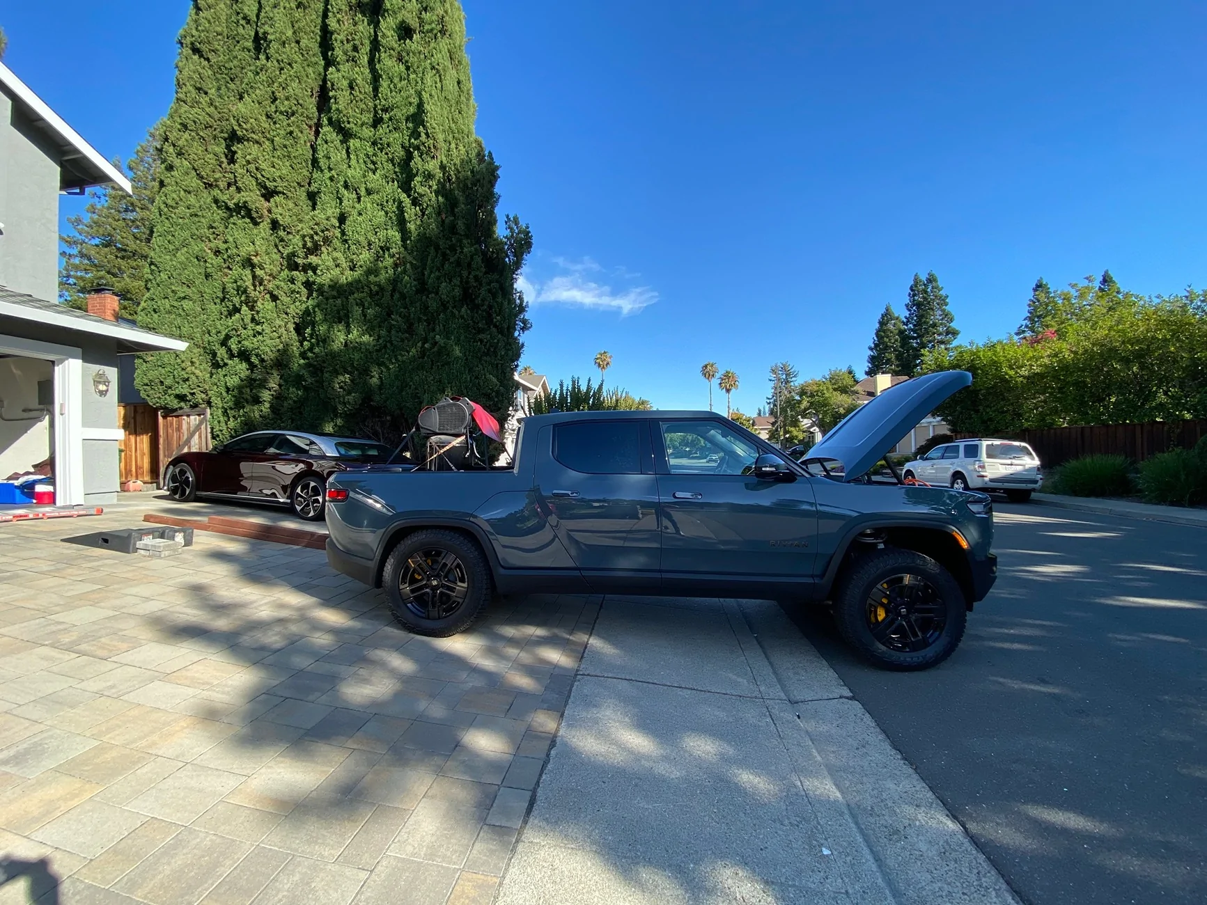

Yeah, my parents like it! They have a lucid air and an etron gt. I was just picking up the air compressor from them because my dad doesn’t work on cars anymore.
I love the back seats of the lucid. It feels really luxurious and spacious in the back. What’s crazy is that I feel like the lucid is harder to maneuver in parking lots. It’s got a long wide hood and I have harder time getting a mental image of where the corners of the car are.
