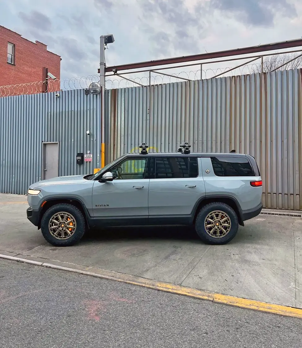

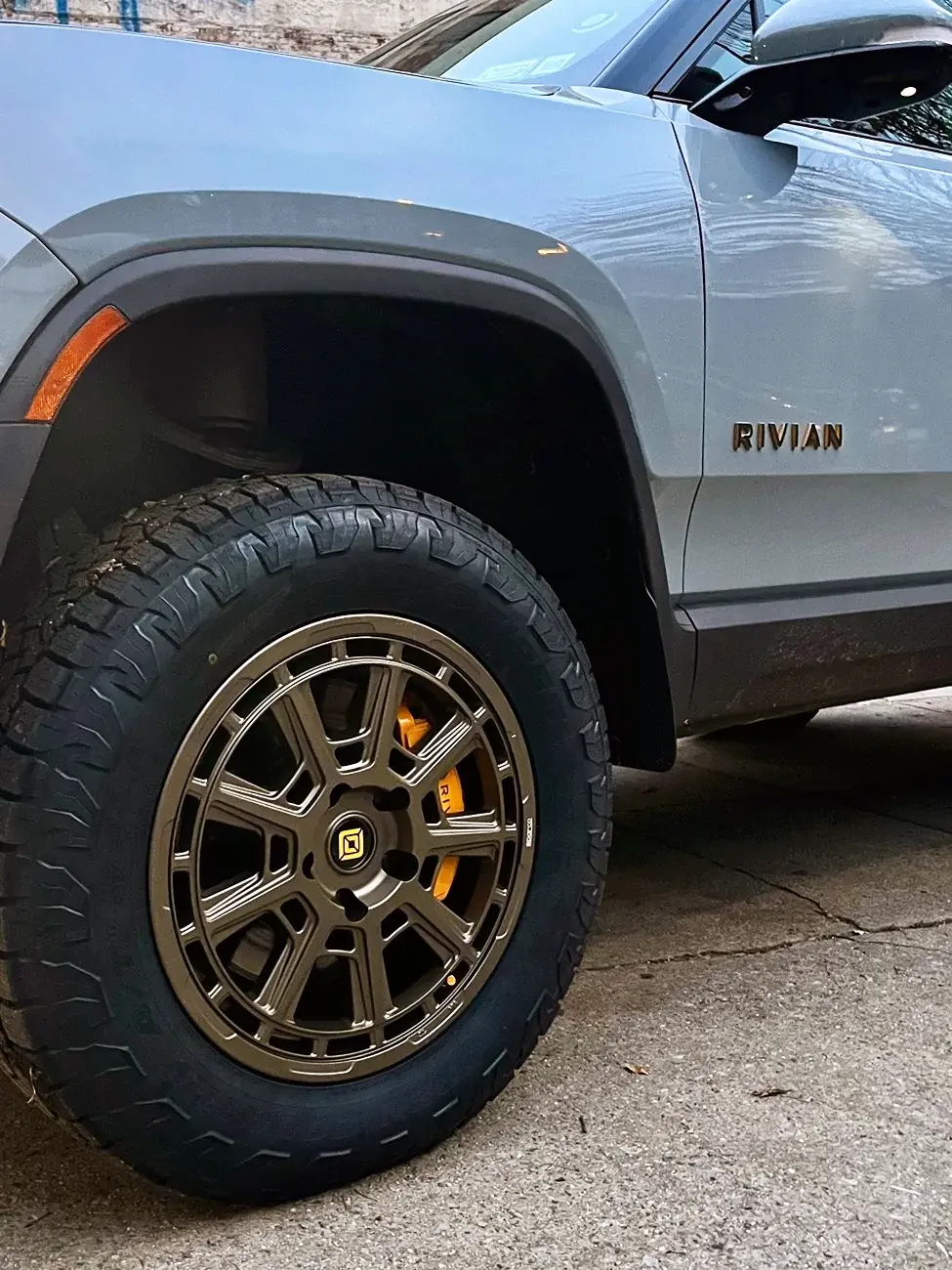

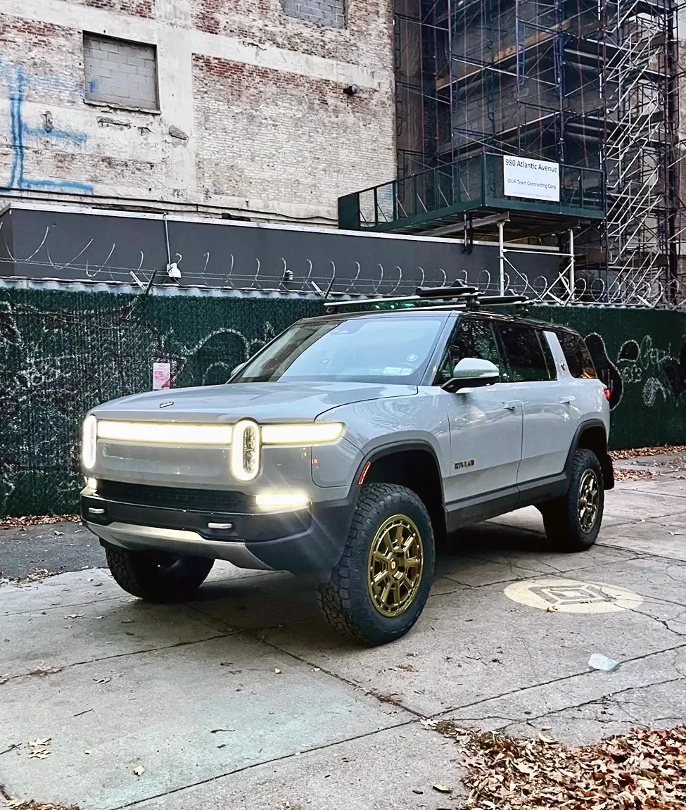

Hey folks! I’ve got a Gen 1 R1S Quad and my stock 21” wheels are about to retire, so the R1S just got a fresh set of kicks. With winter creeping up in NYC, I wanted something ready for the occasional snow, good for a bit of off-roading, and still smooth on the daily commute. Thanks to all the glowing feedback here, I took the plunge on a set of Toyo Open Country A/T EV 275/65/20s. 🙌
Didn’t feel like slapping them on the stock rims, so I sprung for some Sparco Sterratos too. Oddly enough, I couldn’t find a single review or pic of anyone running these wheels on any forum. So I figured… why not be the guinea pig? And honestly, I’m loving the look. Coming from a world of modded sports cars, I’ll do anything to un-stock the ride. Early impressions: wheels are solid, and the Toyos ride like a cloud—plus they’re quieter than those Pirelli Scorpion Verdes ever were. No rubbing in sport mode or at the lowest ride height. I’ll report back after some longer upstate commutes, snow drifting in an empty Walmart lot, and maybe some off-road detours to scare off the local trail Karens. 😏

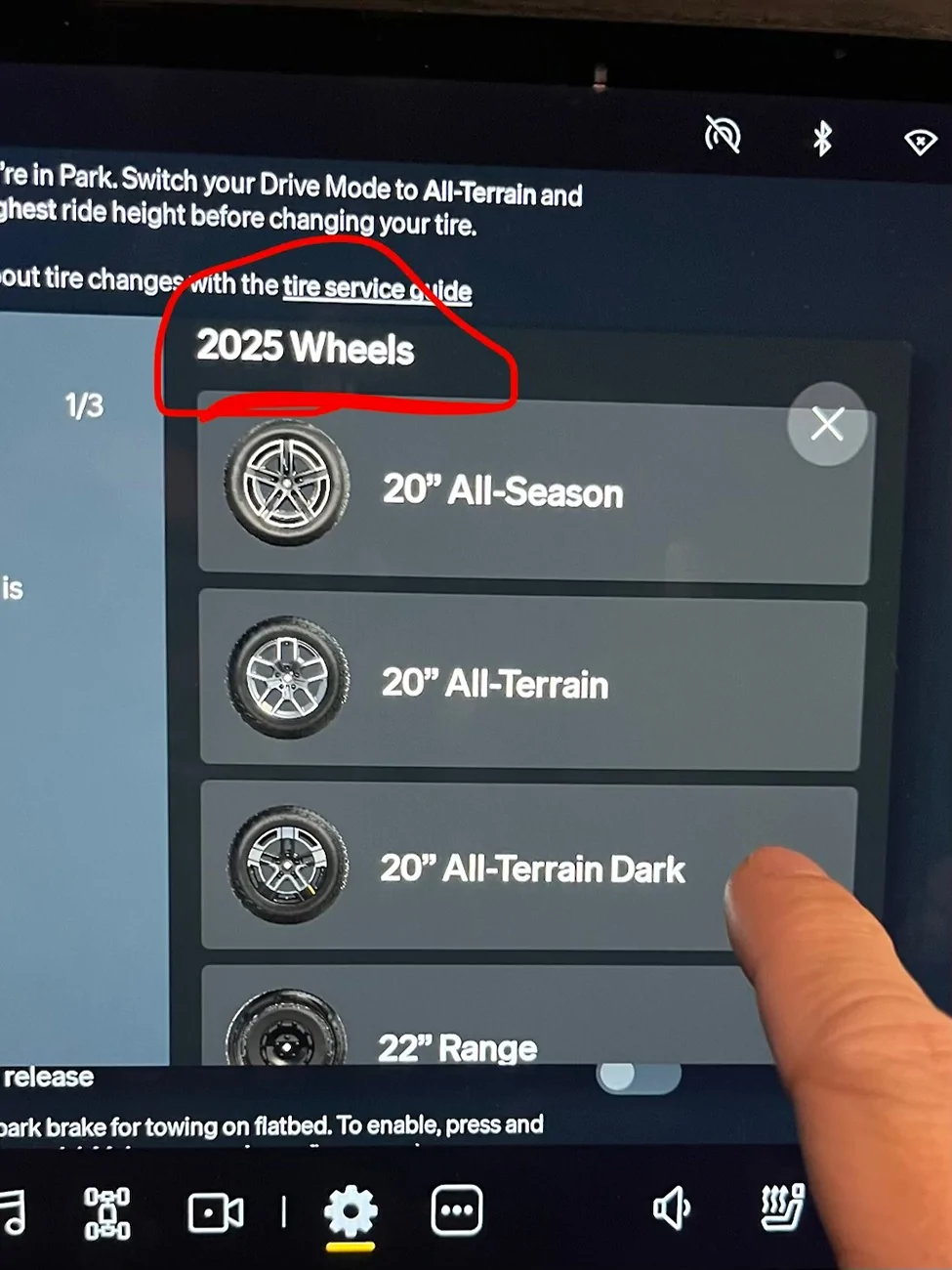

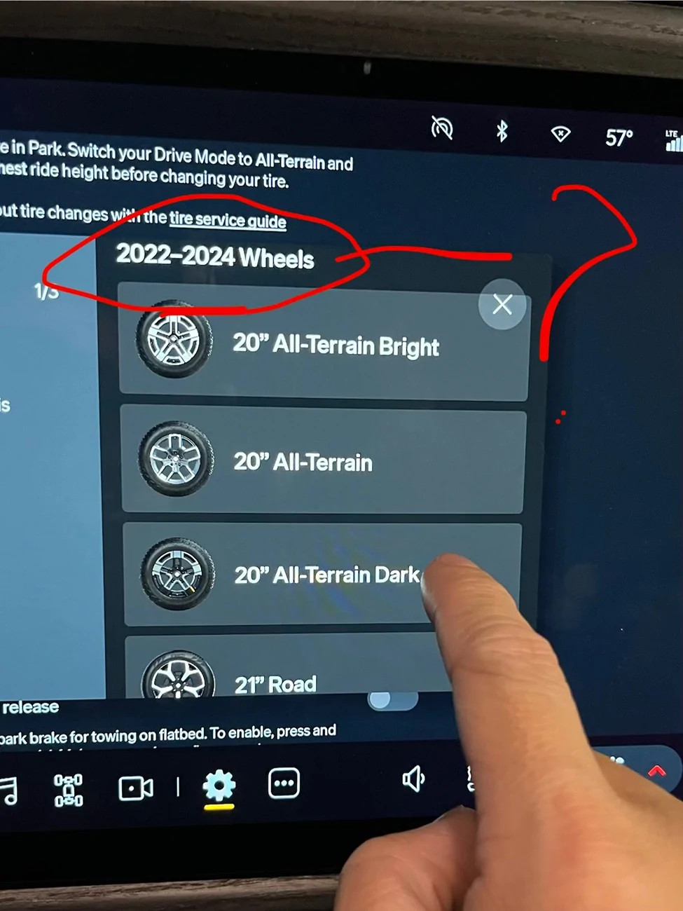

  • Anyone else go from 21” to 20”? Which wheel settings did you choose? And what’s the real difference between 2022–2024 vs 2025 20” settings anyway? Same Pirelli specs last I checked.

Thanks! I wasn’t aware these were new. I did purchased it from TireRack. It popped up as a Rivian option and there weren’t many bronze to choose from so it was an easy pick for me. I guess maybe they stocked up in NY. And yes the specs are sparse. Only specs I can gather from Tire rack are the size (20x8.5) and the offset (+48mm) both Rivian factory oem 20” wheel specs. From what I can gather the 17” Sparco Sterratos are 30lb. So a 20” I would say is approximately 35lb give or take.
I think the main difference is the 20" All-Season in the 2025 list, otherwise the other options are the same between the years.
The 2025 All-Seasons are 275/60/20, so about an inch less in diameter (33" tall versus 34" for the 275/65/20 All-Terrain options).
Oh right! That makes sense. Thanks for the info!

But in context of tire/wheel swap UI, the MY25-on “all season” Goodyear Territory AT is associated with that first 20” wheel design. The other factory 20” designs (AT “staples” and AT Dark”) are associated with the larger 275/65 and closest match to the SL Toyos you got.

Yes that’s what I choose. The 20” “staples” and I found the aftermarket tire option and just set it as that and called it a day. So far the Toyos are great. Obviously with the range lost going from 21” road wheels to 20” AT kinda sucks but it’s just for winter and the occasional trails. Come summer I’ll swap back to the 21” but this time I’ll replace the pirelli’s with Michelin. Looks like I got to get myself a speedflate! Thanks for the tip.
